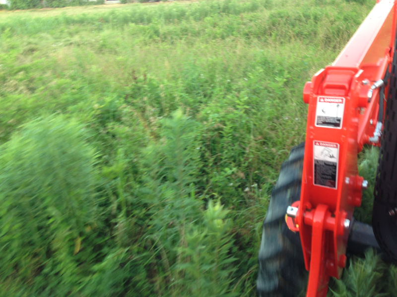

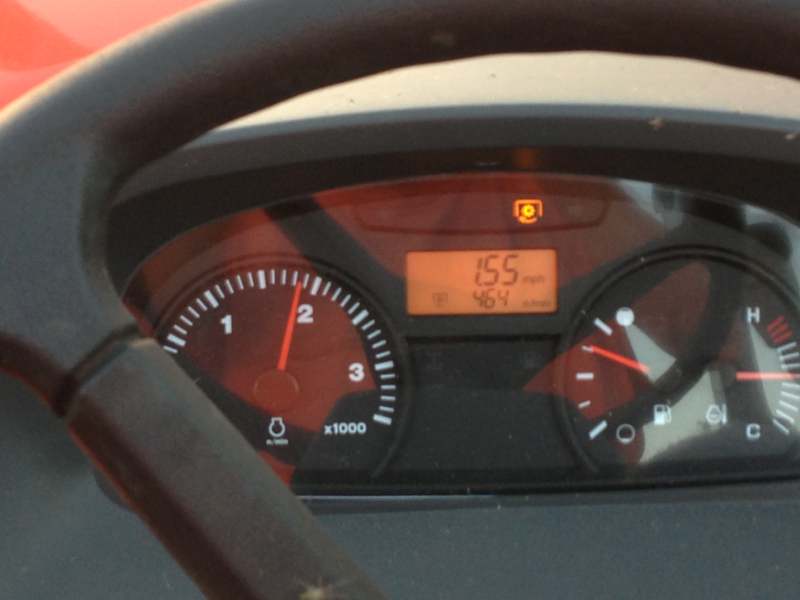

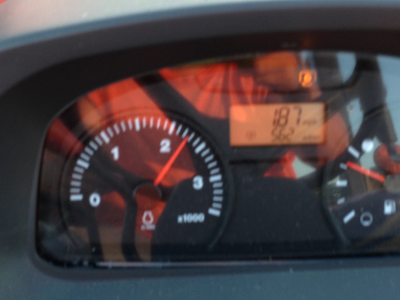

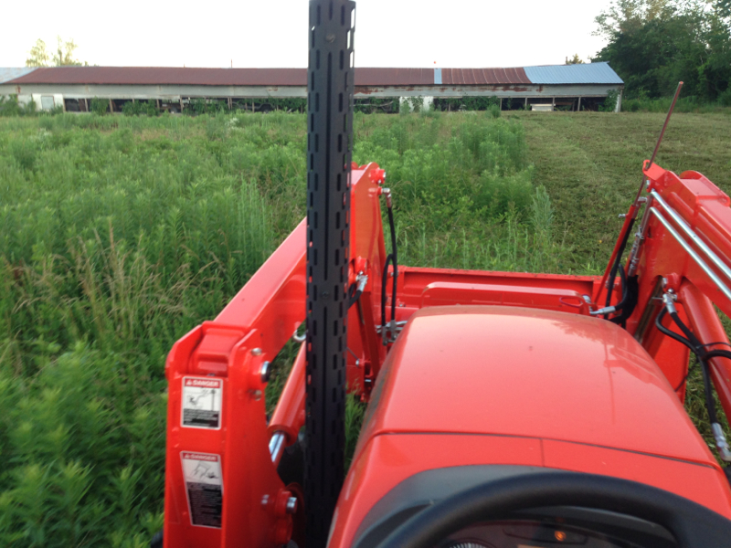

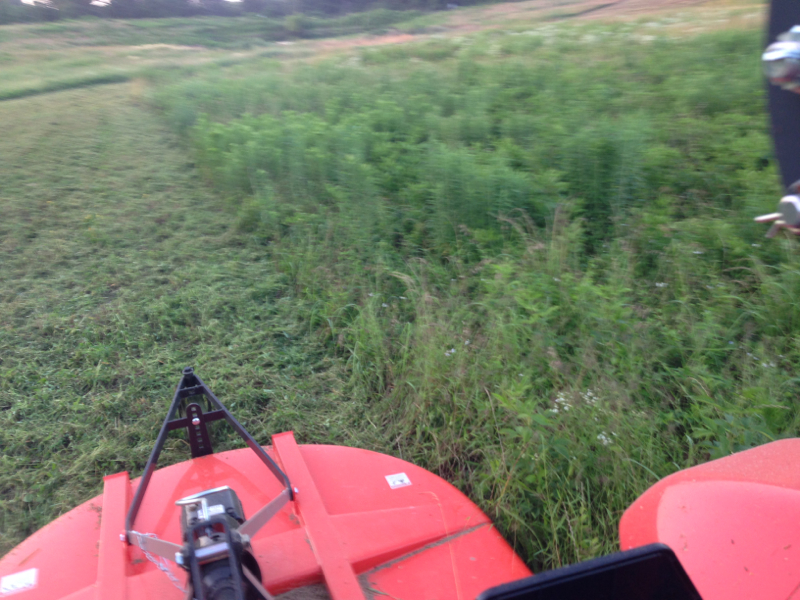

The weeds you are cutting look pretty mild, not super thick or tall. Unless that field is rougher than a cob, I would be rolling along quite a bit faster than what your speedo shows...probably at 4-5 mph.
Entirely your choice of course. I am only commenting. If she starts to run hot, or bogs down, drop down a gear or two. I like the little bit extra breeze, but only if its a smooth ride :)
Nice looking tractor by the way!

Ya the pic in that spot look milder than it is . It would bog running at 2300 engine rpm / 540 . In 3rd low . Would have to drop it to second gear . One section I would have drop to 1rst low . But it was 4-5 tall and a wet stop so the grass there is tough .
The many thing I was worried if I had it wound up to far . But from all the comments . Looks like 2300/540 is not to high .
This is the heavyset stuff I had tried it on . The other was short and I just cut it super low . But only ran at about 1500 engine rpm . And like 2 high . But like said it was a foot high . .
But looks I'm good .
Thanks again guys .
And as for as the temp. It's got no higher that right in the middle .
But it's seems its going to be a fuel hog . But I'm used to the fuel sipper mf 135 .
