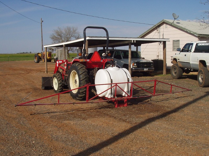

Here are the pictures of the 125 gallon pto rig I made. It had folding booms and a electric switch to turn the spray off and on. It also had a return / agitator with good volume to help keep the tank mixed. It would take a pretty serious 12v pump to get the job done.

I'm in the process of making a 125 gallon sprayer to replace a smaller gas driven unit. Considered buying a pto unit but decided on 12V because of flexibility of using either my tractor or RTV. Am using 2 pumps for wider boom coverage. 2.1 gallon units are cheap and switchs allow me to vary width. This is important because some of my spraying is between rows of planted trees. Plumbing is pretty straight forward for construction. Only spraying herbicides; primarily glysophate so no high pressure or wettable powder considerations.
