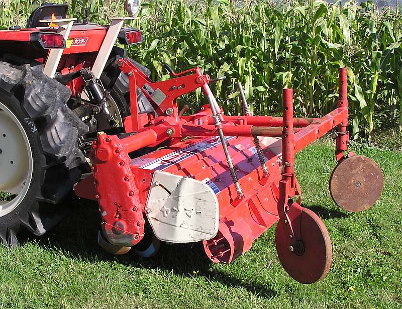

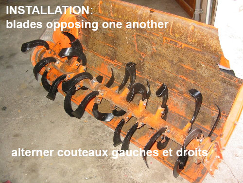

Its not a rice paddy tiller is it?
Possibly like this?
or this?
/ pto tiller
the balance/ support wheels look like the Yanmar rig, but can't see shape of tines. All I've ever seen are L-shaped but on this tiller they are straight with a downward curve
/ pto tiller #4
you can see the tines in either pic above. Both tillers have similar tines.
Does the tag say RS1200? I believe Yanmar has a Japanese model called RS1200. I also believe its Gray market. This could be a problem if you need parts and try to use the dealer. Of course there are importers who will sell parts and eBay etc
Between the guide wheels and the "unusual" tines, im pretty sure you got a gray market machine. Try searching for Yanmar RS1200

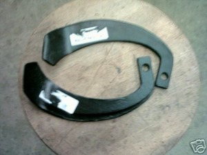

Do they look like this?

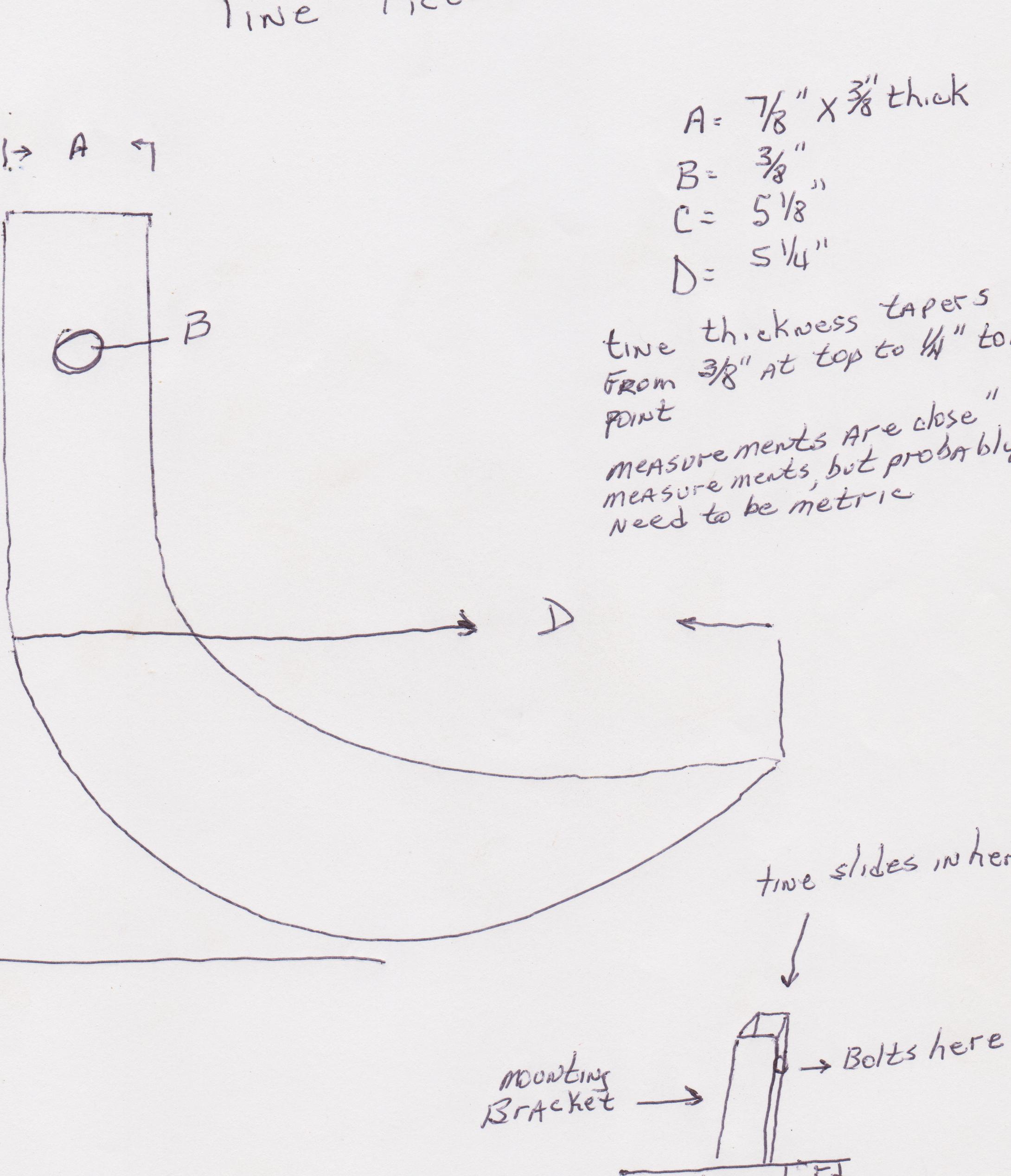

/ pto tiller
above is a drawing of the tines....there are 40 tines scattered (not in a defined row) along the shaft
