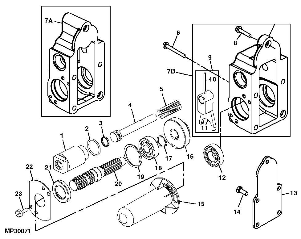

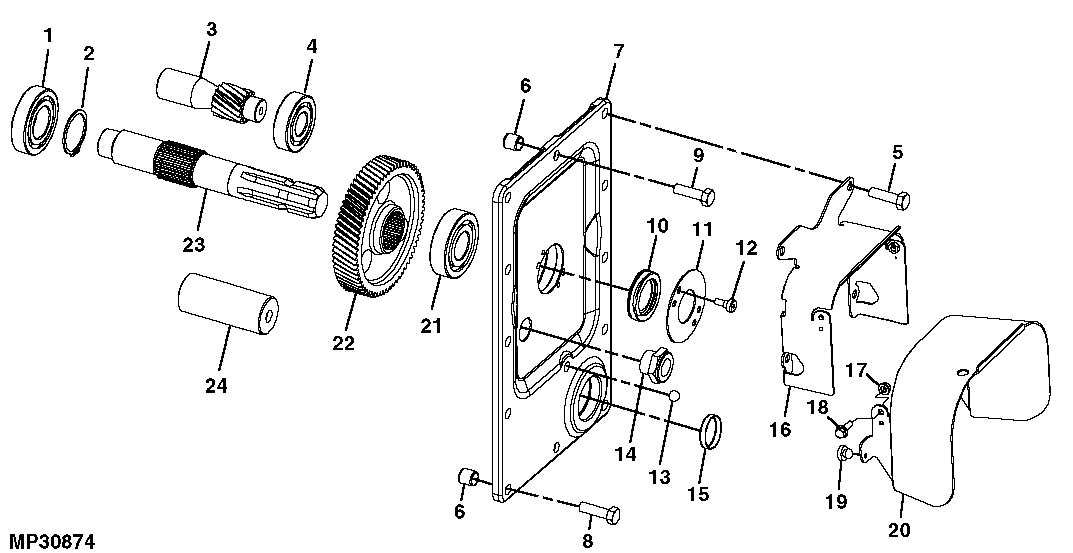

I have a 2003 deere 4310 Problem is that part in the owners manual where it tells you to always engage the mid PTO before the rear .Well it took 6 years but i obviously wasn't paying attention and did it backwards there was this loud screach then the PTO just quit ....Question IS how bad did I hurt it and how much will it cost to fix???
/ PTO Trouble #2
Ouch!
The mid-PTO is driven from gears on the rear PTO shaft, That is why you must engage the front first so the gears aren't spinning. I suspect at least one gear is stripped of it's teeth...and they are in the sump now. I would not the tractors till it's fixed because the loose teeth could cause a lot more damage. There is no way of knowing until at least the rear cover plate is pulled.

Well, it depends. You will not have to split the case, I know that for a fact. If you are handy, pop the back cover off, and see what you did. The only problem with that is that you will have to drain all the fluids. You can check out my previous post with my 4310 PTO problem if you wild like, also, there is another member on here that rebuilt his entire 4300 from the ground up with excellent pictures Feel free to ask me any questions. I have some for you.
1. Is yours an HST?
2. Does the rear PTO work, and just not the Mid?
I also have the shop manual, so I will help you out if I can.
