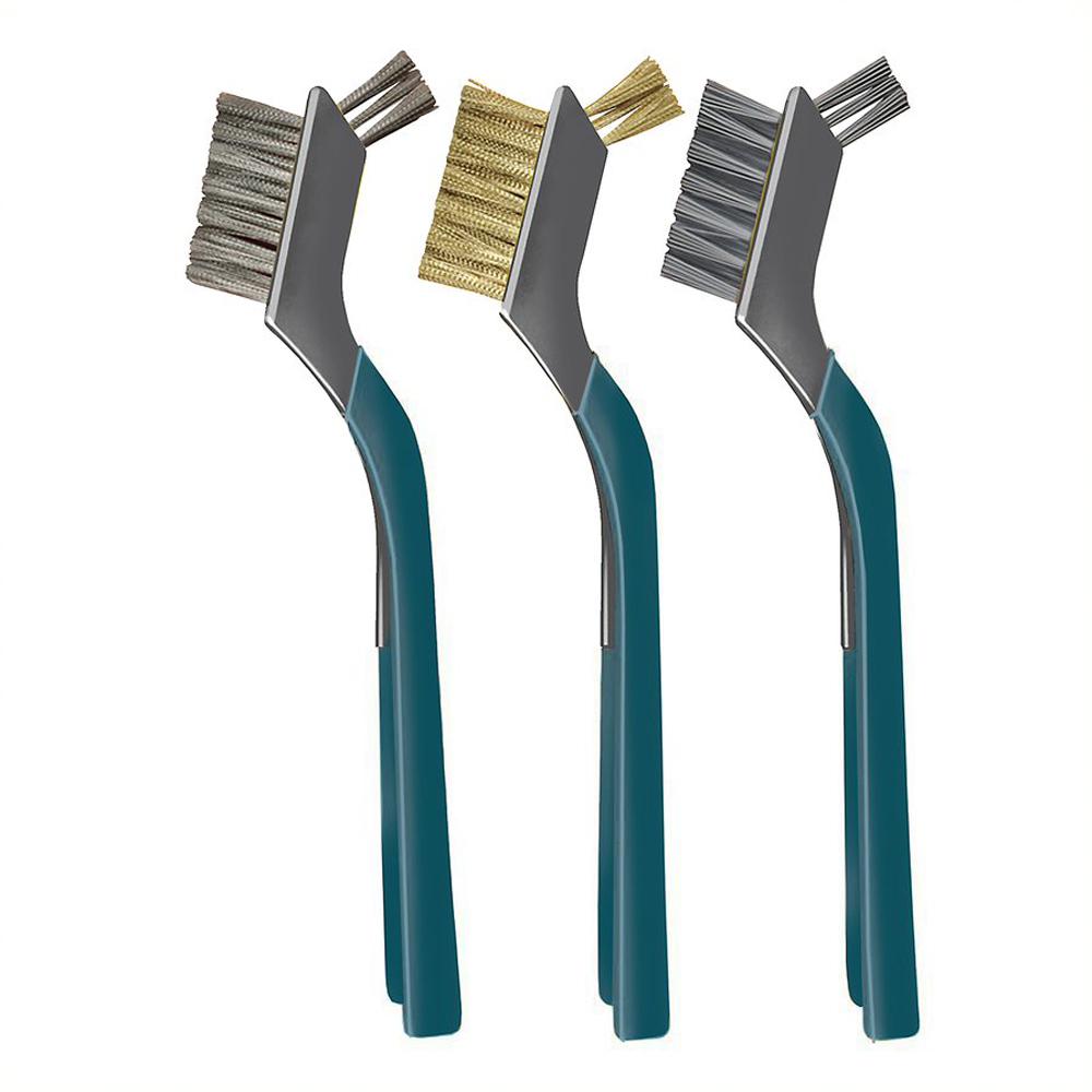

i used a brass brush that looks alot like a toothbrush that i got from home depot when i cleaned mine. anvil-paint-brushes-amb-anv-64_1000.jpg. cleaned them with brake cleaner also. i always use a spray lube when installing them now. i would think a bench grinder set up with a wire brush would do a good job cleaning the pin. what keeps pin inplace in the shaft? mine has never come apart like that
