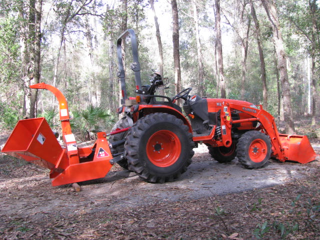

I have a Kubota B3300SU.....about the same power as your L3200. I run a Wallenstein BX42s PTO Chipper.
Great tool. Simplicity itself. Extremely well finished including the best paint of any implement I own.
The ability to rotate discharge chute 360 degrees is very convenient. I often chip into a trailer.
This is a CHIPPER. It will handle a limited amount of brush but if you push in too much brush it will clog.
I have used my BX42s with Oak quite a lot the last eighteen months. Just reversed the chipper knives to fresh edges a month ago.
If you intend to process-to-mulch a good bit of brush go with BXM42 which is a CHIPPER/SHREDDER.
