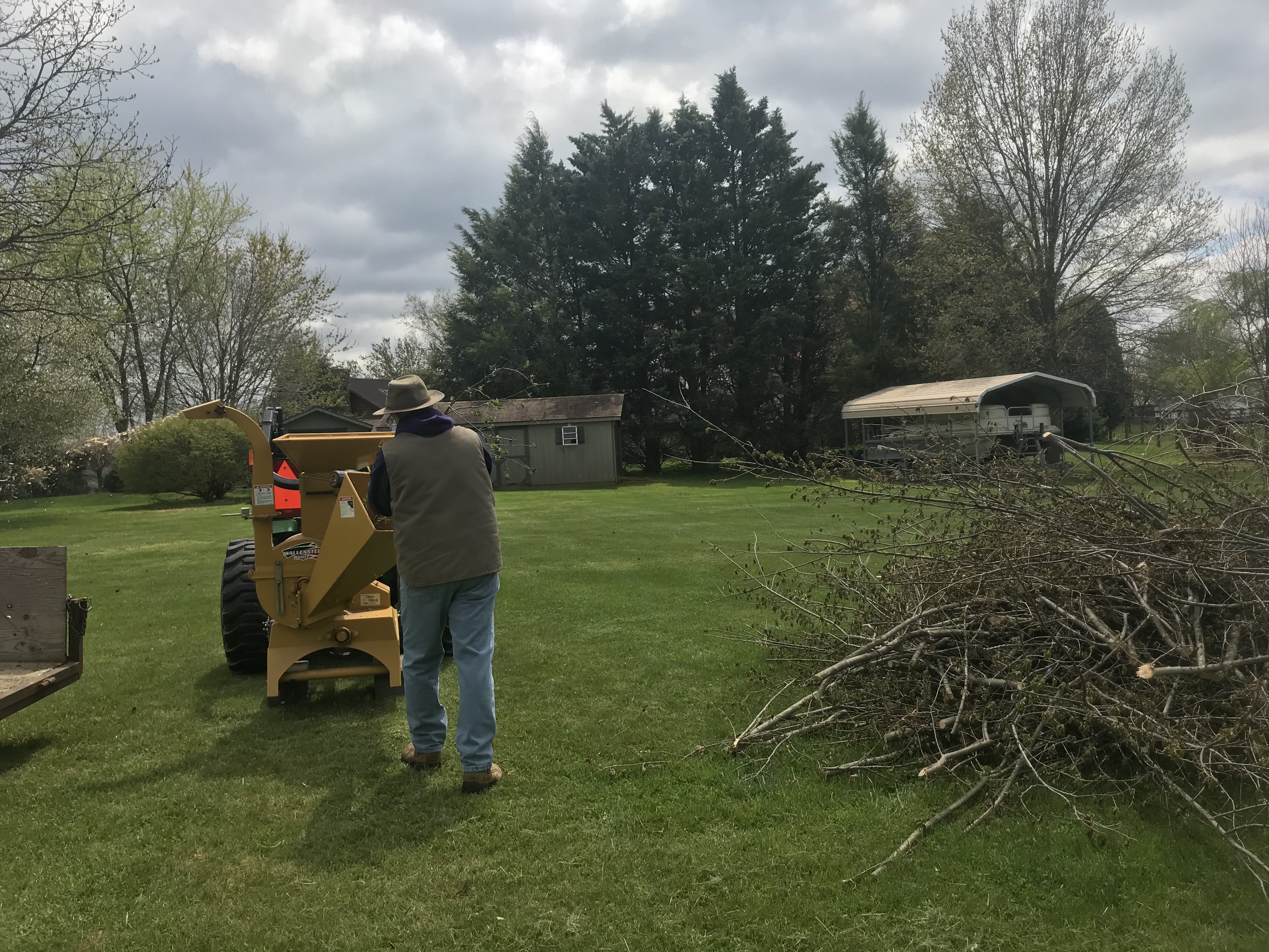

I have a Wallenstein chipper. It has a rotating discharge chute. This chute can be directed in any direction. The very end of the chute has an adjustable deflector. The deflector can be adjusted to broadcast the chips or very specifically deflect them down into a wagon, wheel barrow, etc.
<br>
I'll go out take a picture and post it here.View attachment 664792

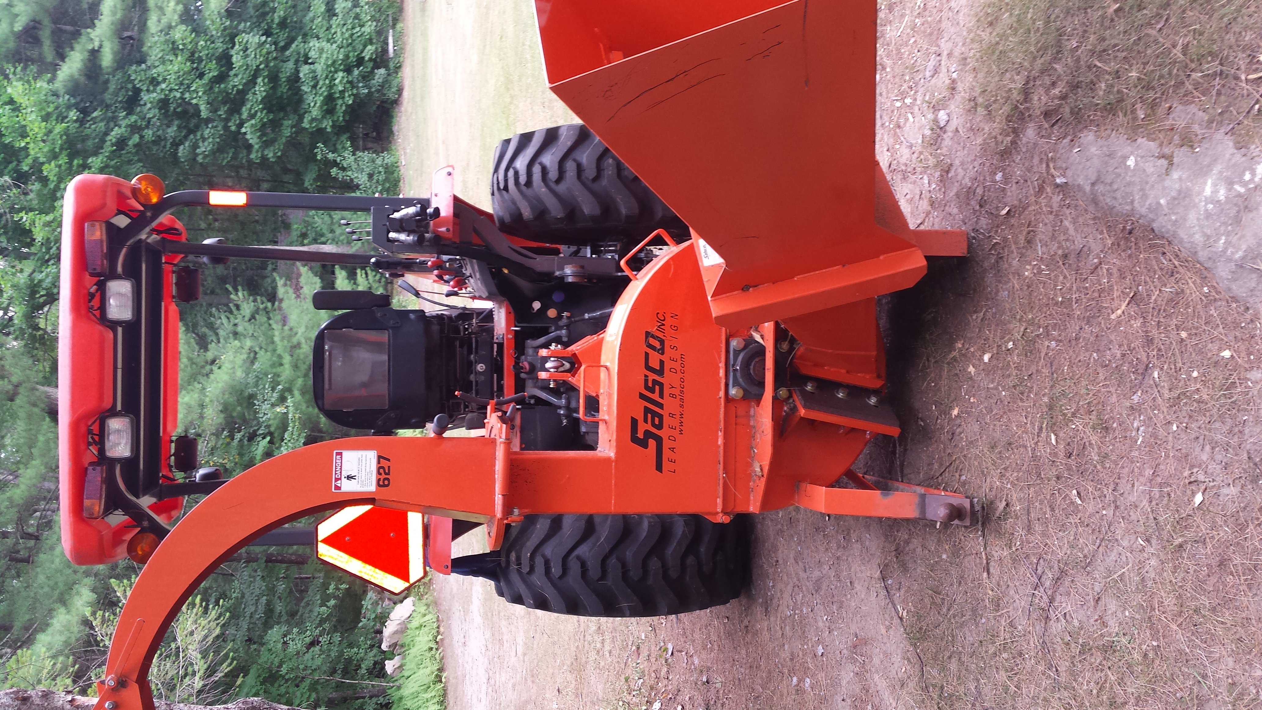

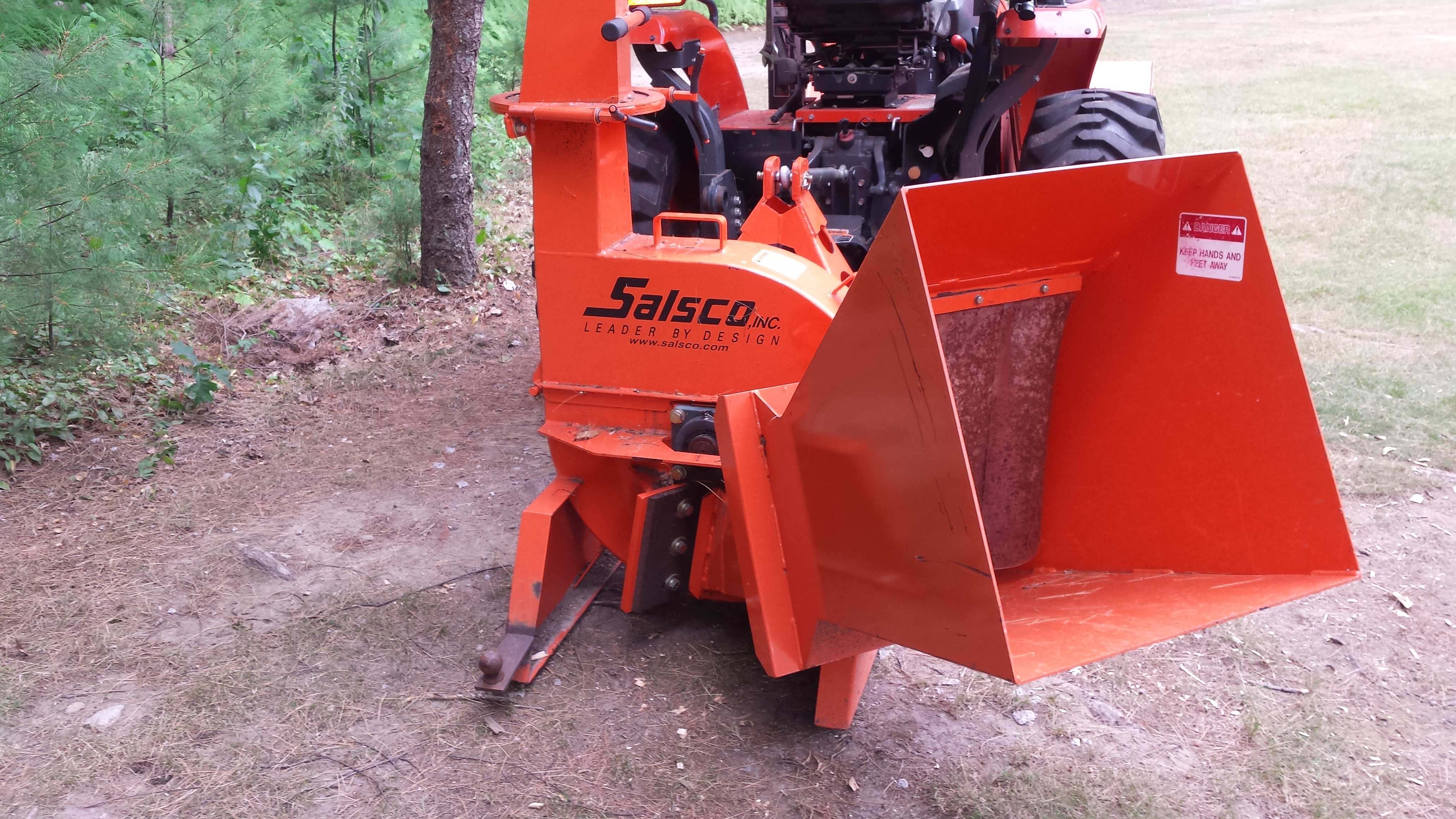

My 6" Salsco is similar to Oosik's Wally. The in-feed is approx 45ー to the right of the longitudinal axis, and the chute is toward the left side. I welded a 1/4" tab to the rear of the left skid and mounted a hitch ball. I built up the sides of an old Craftsman dumping garden cart so that it will hold approx 2 cu yds of chips. If I were pulling more than a light utility trailer I would beef up the tab.

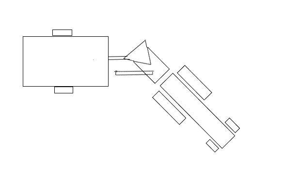

You could use a rear feed chipper with a trailer by backing up, turning the trailer at an angle.

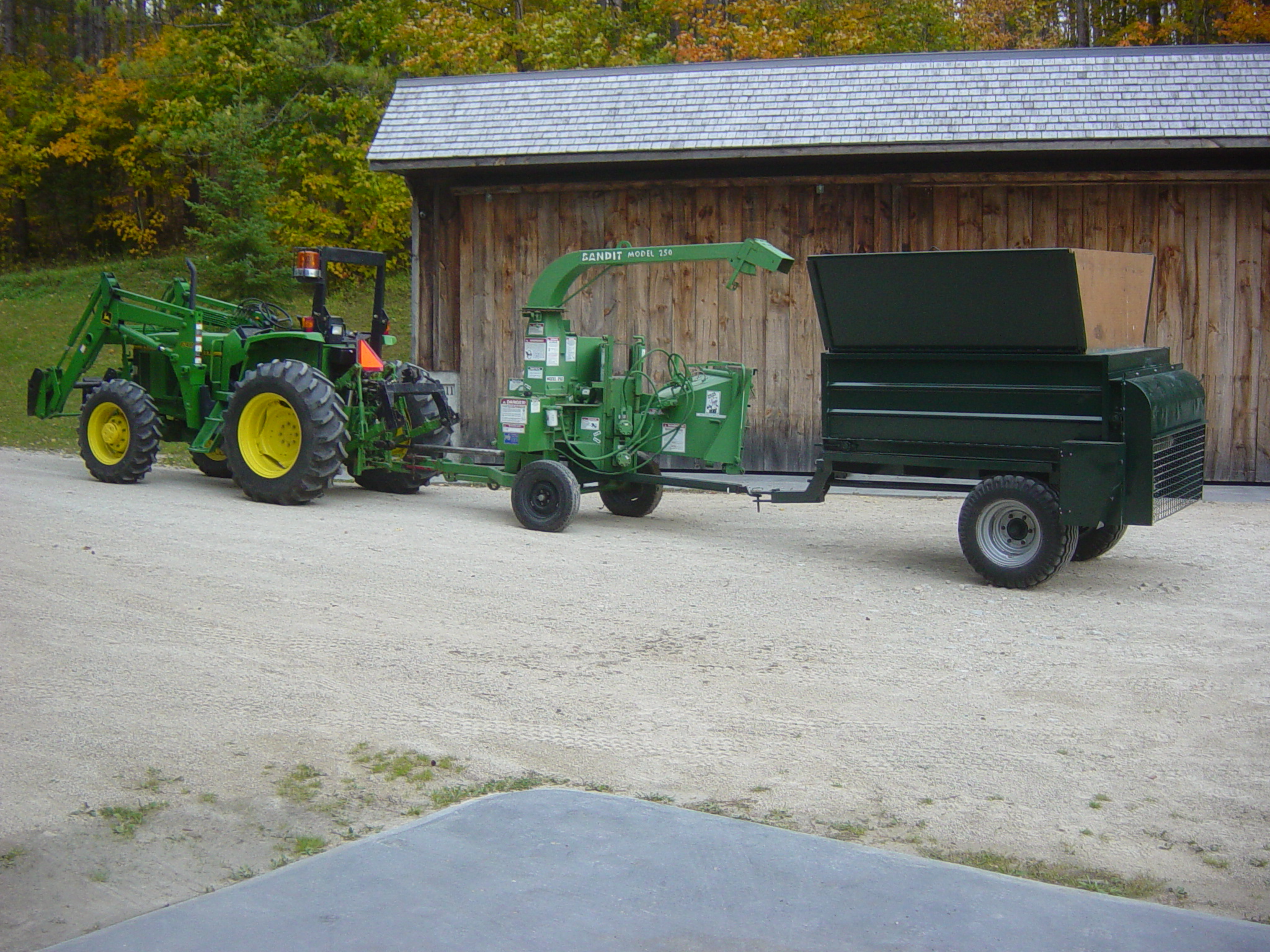

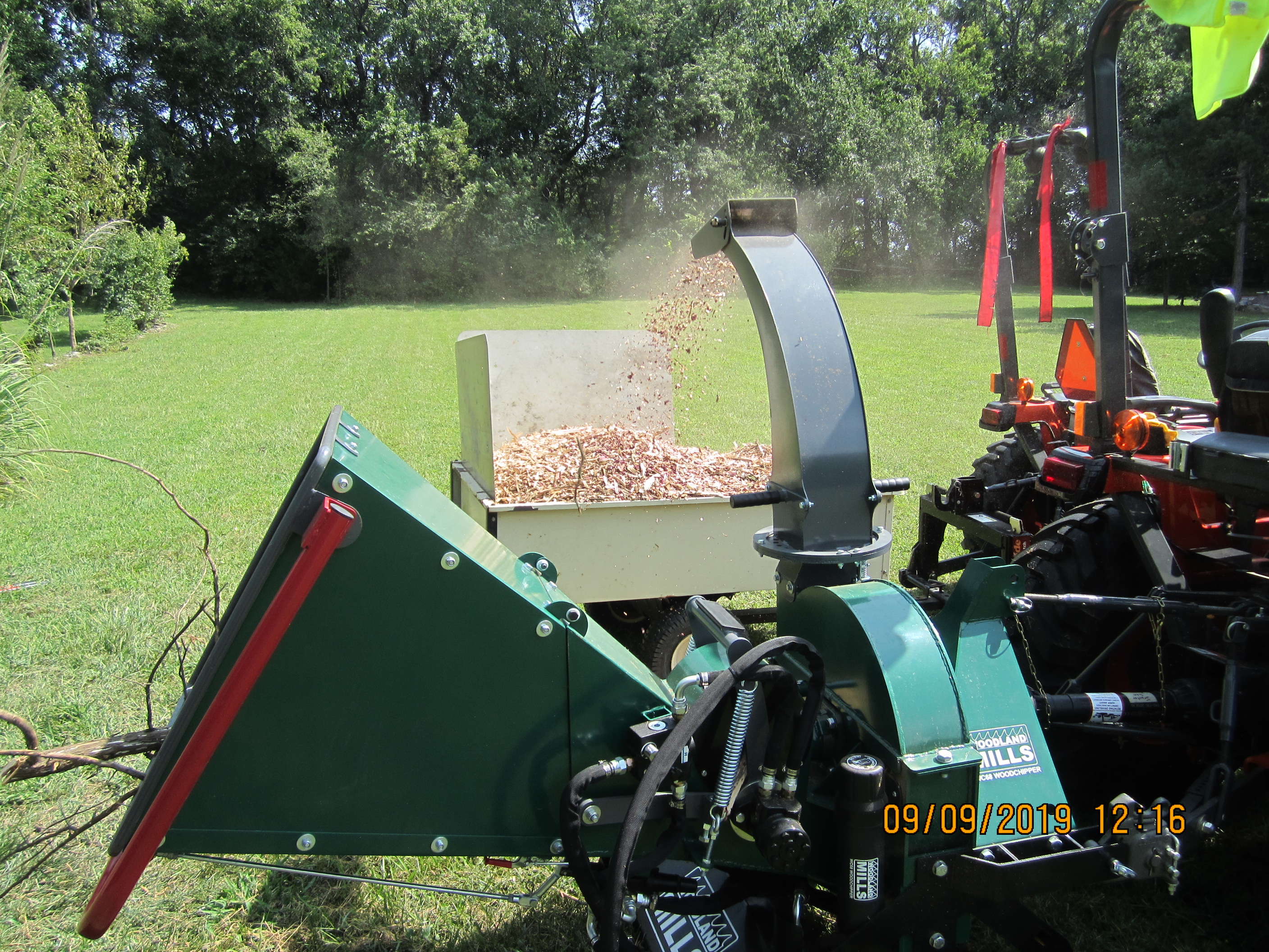

We have been using a PTO chipper I bought used in 1998 and based on my experience will say: Make sure to get one with adjustable hydraulic feeder, like for example the Woodland Mills chipper in a post #9 above.
There are others with similar adjustable speed feeder.
