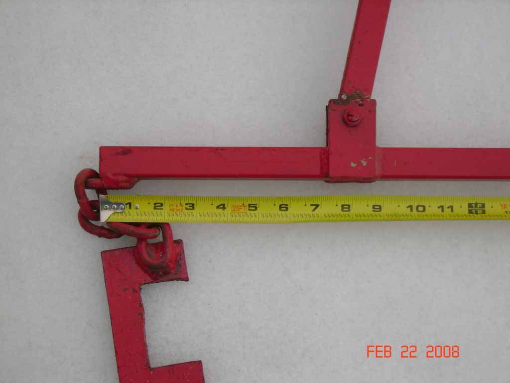

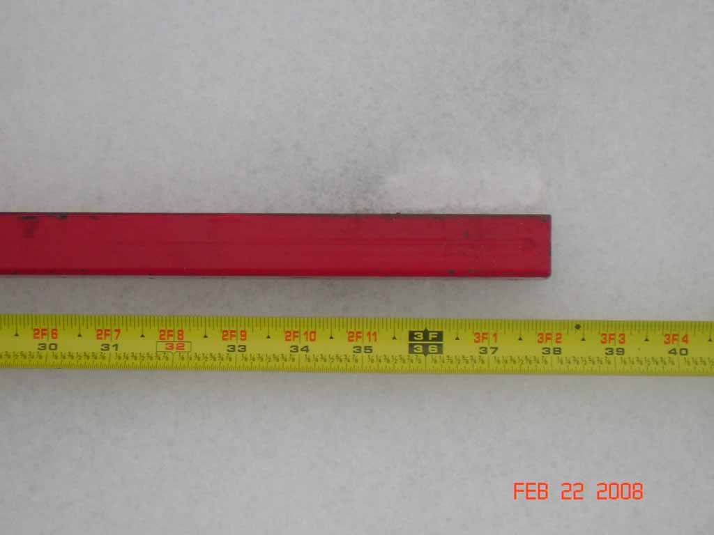

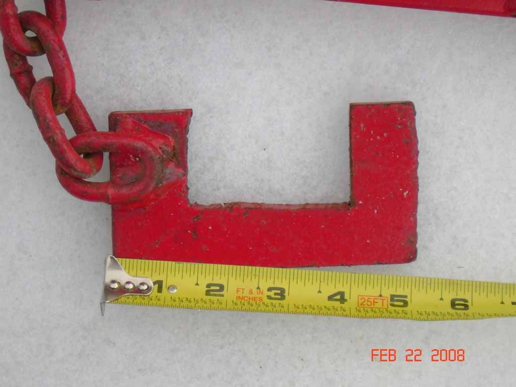

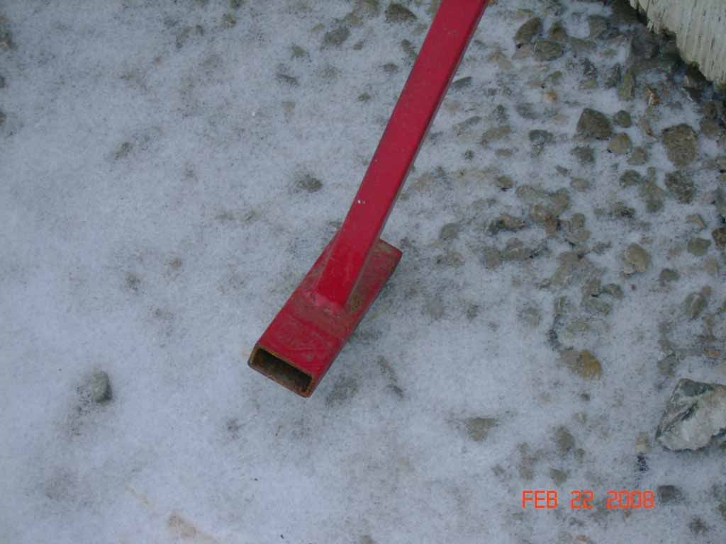

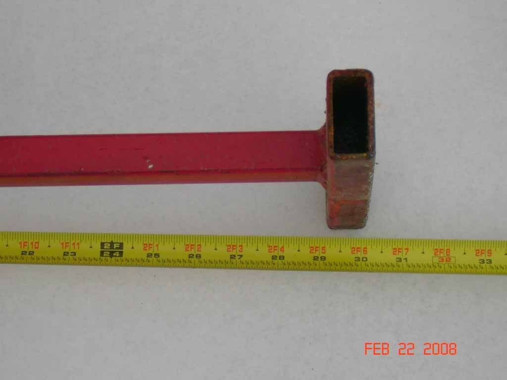

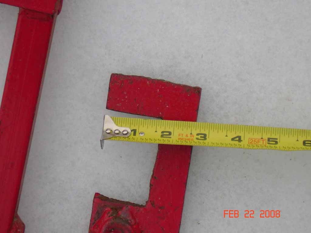

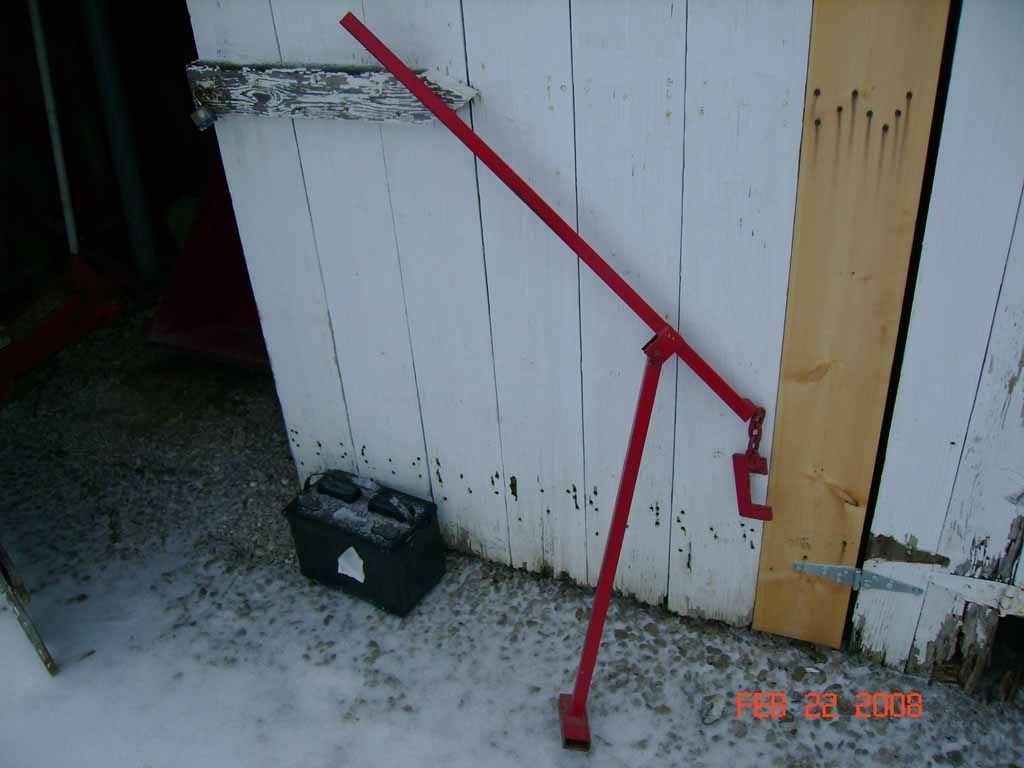

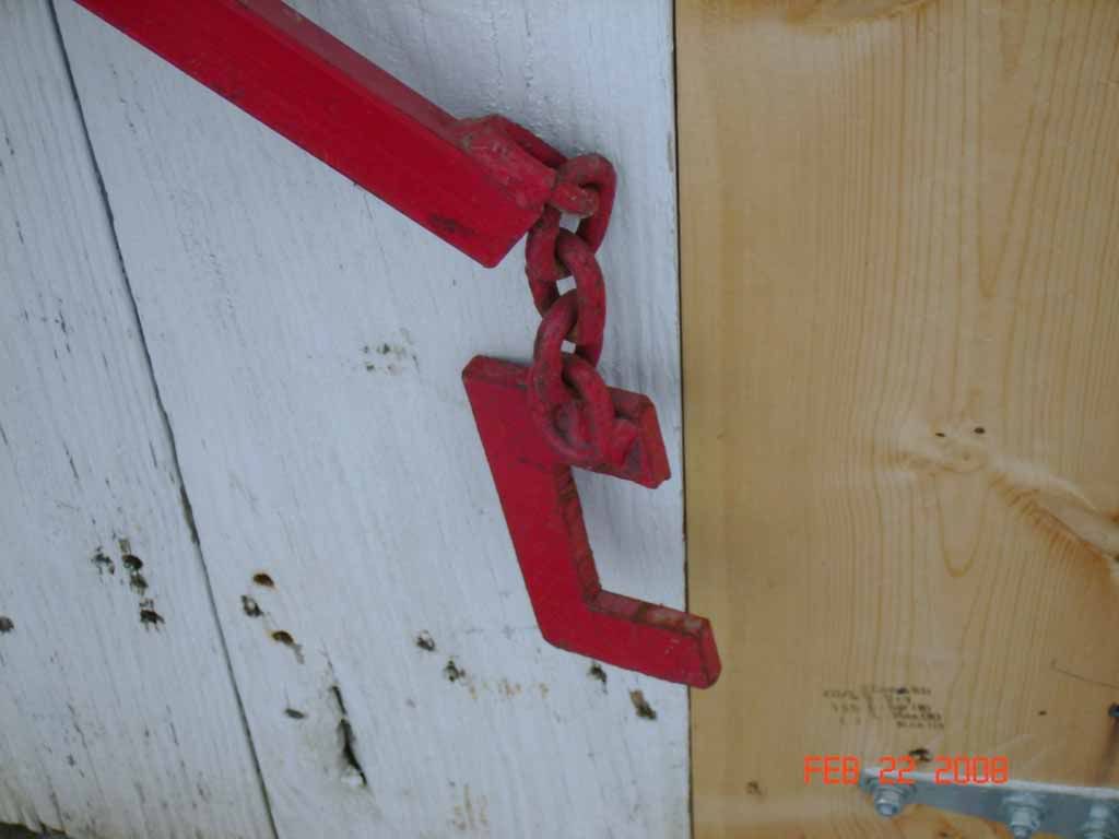

Anyway I took a couple of 2 inch square tubing and determined the length I wanted. Then I welded a set of ears 1/8 inch thick plate to both sides of one piece. Drilled a hole through both ears and then determined the leverage I wanted and drilled through the second piece and ran a bolt through them both. At the end of the piece to be used for pulling I drilled a hole through it then ran a bolt through it. Welded it in and cut the head off. Heated both ends and bent them up. Welded a base on the standing piece and got some chain went to pulling. Works great and takes on fuel to operate.
   / Pullin Old Fence Posts #42
John there is a tradeoff between the length of the pipe (strength) and its ability to "get crosswise" on the bumps to grip the pipe. If you have a piece of telescoping pipe to weld over the first piece to make it stronger that would strengthen it or you can cut through a piece so you can open it up and put it like a tire around the original piece.
In my early experiments I had a couple failures. One was a (I thought) good looking weld with little penetration/strength which came apart on one of the first few posts and the other distorted a lot when stressed on a really hard to budge post.
Pretty simple huh? So simple it is sort of hard to describe it, everyone expects more complication. I did a little fine tuning to close up the hole a bit so it grabbed the bumps really well (version with the piece of plate) but without making it so tight I couldn't drop it onto a post with the FEL without getting down off the tractor. Also if you make it too tight it is harder to get it to release without direct manual intervention.

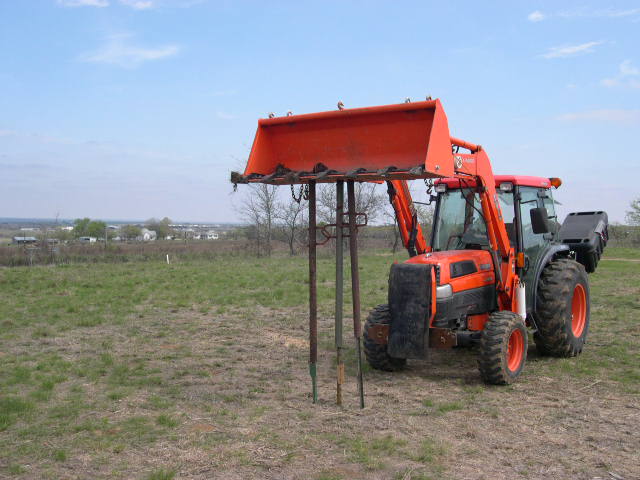

What comes up must go down... so, here is a photo of my three T post drivers. A pipe with closed end, length selected to match desired driven depth, lower FEL on it and press down. The sheath stops a bend very quickly and transmitts force to the point. If it's tough going, you can pound a little with the FEL... but the limit is the same as with a hand driver...sometimes it just won't go further, so I leave it right there:)

No surprise, it is an obvious design. Same as me but I put a little sideways pipe at the bottom to prevent the post from being overdriven, say if the tractor;s front wheels are in the air and the post starts going in again. I also went with the bent metal insert inside the pipe to hold the post so it doesn't try to fall out prematurely when I am doing all this solo. I don't always use the same length of posts so opted for the telescoping adjustable length.
Have you tried putting weight on the FEL to improve the hammering action it you raise and lower the FEL? Makes it less likely that you will raise the front wheels off the ground.

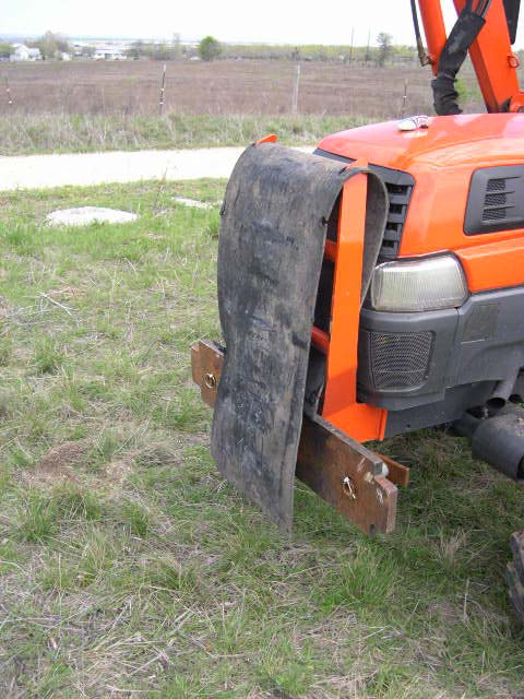

Would you mind posting pix of the custom front bumper?

Texasjohn -- I notice you have a counterweight on your tractor in the picture. I would think it would work better without one, as the loader would be able to exert more downforce without lifting the front wheels. Or am I missing something?

Pat, well.... I have learned to watch the front wheels and NOT get them off the ground... if it stops pressing in, then I give it a couple of taps to see if it will continue in with impluse shock... if it's a small rock, then it gets smushed or pushed aside and downward motion continues.
Yes, if doing a whole bunch of posts, I have two kinds of weight in the bucket. First, I have some elevator weights and I chain several of them into the bucket... total of about 400 lbs. Also, typically I have 10-15 T-POSTS and maybe some other tools in the FEL bucket. I do this using the buddy system... buddy holds the post and sheath where it needs to be while I SLOWLY lower the level bottom of the bucket onto the sheath. I just kiss it and buddy backs way away than I press down for about 5 inches with FEL. Geometry of this means that top of post is pulled out of alignment so I lift FEL and let post top spring back to vertical... repeat until BOTTOM of sheath is at ground level. I match my sheath with the T post being driven to get the proper depth.

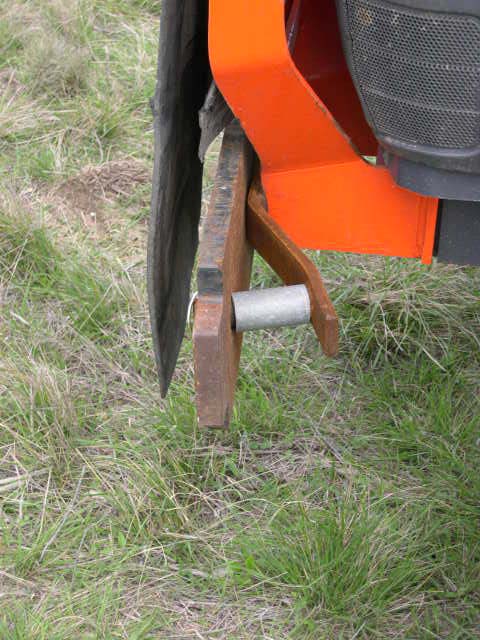

Custom front bumper:rolleyes: Well, I was picking up 2800 lb culverts and they would hit the front bumper and mess up the paint... a previous year my custom round bailer had busted a strap on his round bale roller and left it in the pasture. It is a thick rubber belt just a few inches wider than the bumper, so I cut to length and cut a couple of holes so it would fit over/down on the tabs/points on the top of the bumper. So fundamentally it is just a piece of rubber belting draped over the bumper and prevented from sliding off by the holes in the top.. also, bolted the two sides together so it would lay kinda flat.
These pictures are the only ones I have of the setup... rubber bumper has been ripped up by the pounding it took moving my culverts and is no longer on the tractor. There is a bar welded to the bottom of the bumper with small pipes welded on it... purpose is to recieve the elevator weights (about 80-120 lbs each) You can see that in the picture as well. Total length of extra weights, etc in front of factory bumper is limited... if too long, FEL will hit the add-ons when using FEL to raise front of tractor off the ground.

Thanks for the info. I recognized the plastic box in back, good idea. I wasn't sure about the draped material up front but assumed it was a protective blanket of some sort. My question regarding the custom bumper was aimed at the HD horizontal metal piece. I have the little bumper thing that your rubber is draped over but not anything like the horizontal piece. Might be a good addition.
