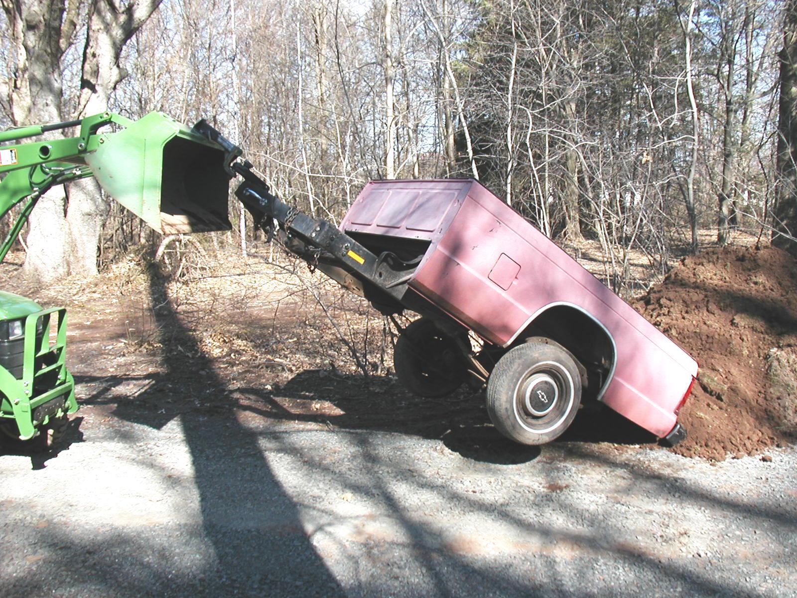

You could go this route if you don't have a dump trailer, make your own dumper. This is how I did it before I got the EZ Dumper
see pic.

Only problem is for me the draw bar is to low to use with the over the road trailers I have.
JB
