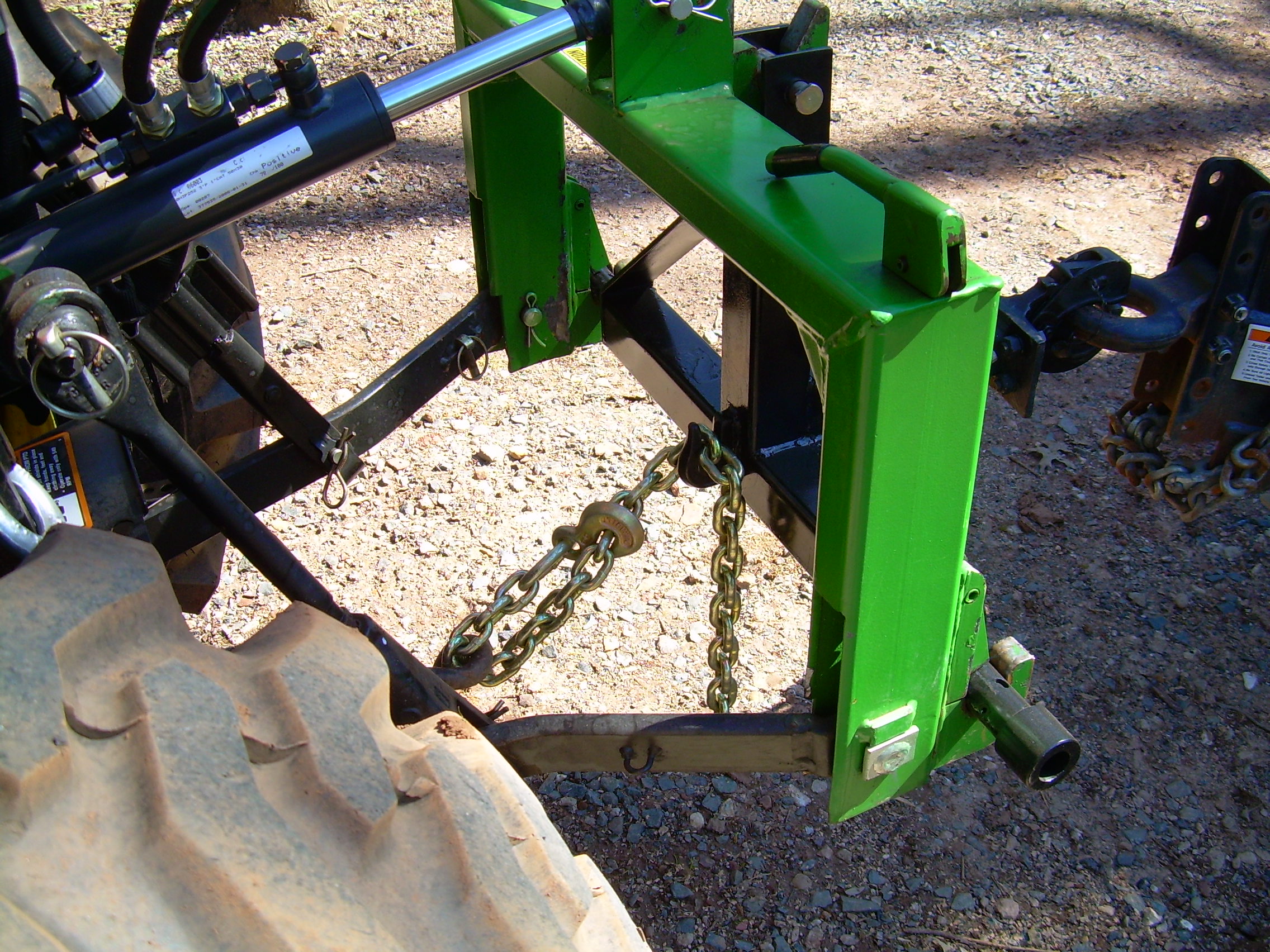

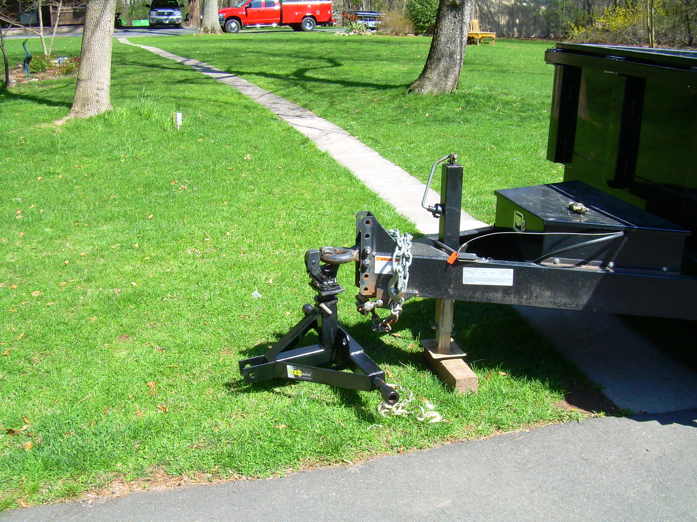

I use a 3pt trailer mover on my BX2200 to move my 10000# double axle utility trailer. When I was creating my new patio a few years ago, I had the trailer loaded up with 2 pallets of concrete mix and I needed to get the trailer in a tight space to save my back a little more, so I used the tractor. Plopped it in 4x4 and L, and it handled it just fine. Just took it easy, but it had no issues nor did it feel unstable at any point. I had to be at full weight on the trailer around 9000#. Granted I only moved it a couple hundred feet. But I was pleasantly surprised as to how well the machine moved it.
