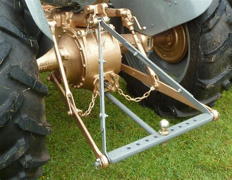

I use a 3pt receiver to move empty trailers all the time. The most weight I've moved was my dump trailer loaded with eight yards of mulch.
Yup, I used the 3 pt to tow stuff many times. like farm wagons loaded with 120 bales of hay, my utility trailer loaded with logs, etc. The bars that hold it level prevents it from raising. The 3pt hydraulics lever is all the way down. Like this stock picture shows:
This is used to prevent the drawbar from rotating: https://www.tractorsupply.com/tsc/product/countyline-drawbar-lock-cat-1

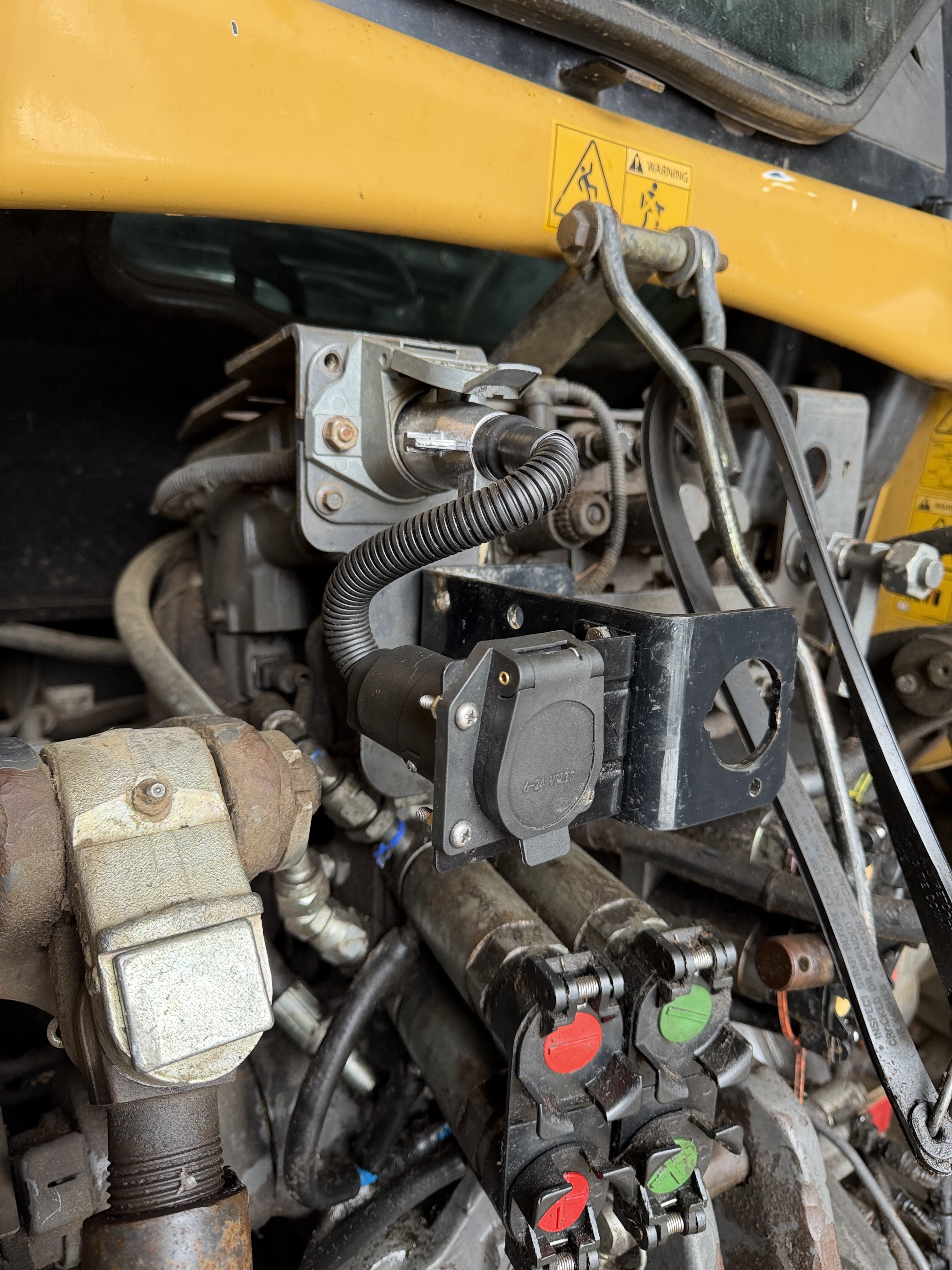

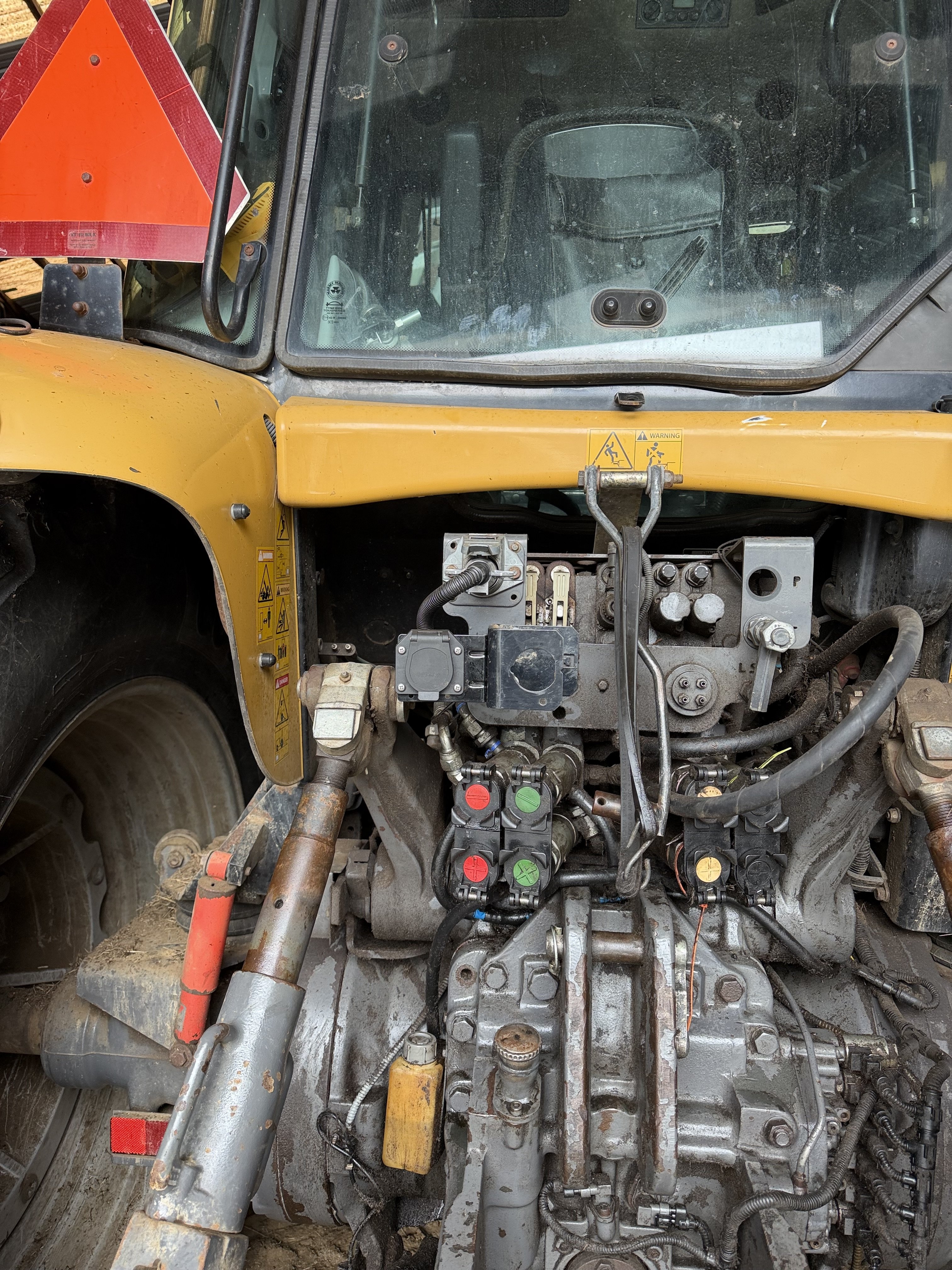

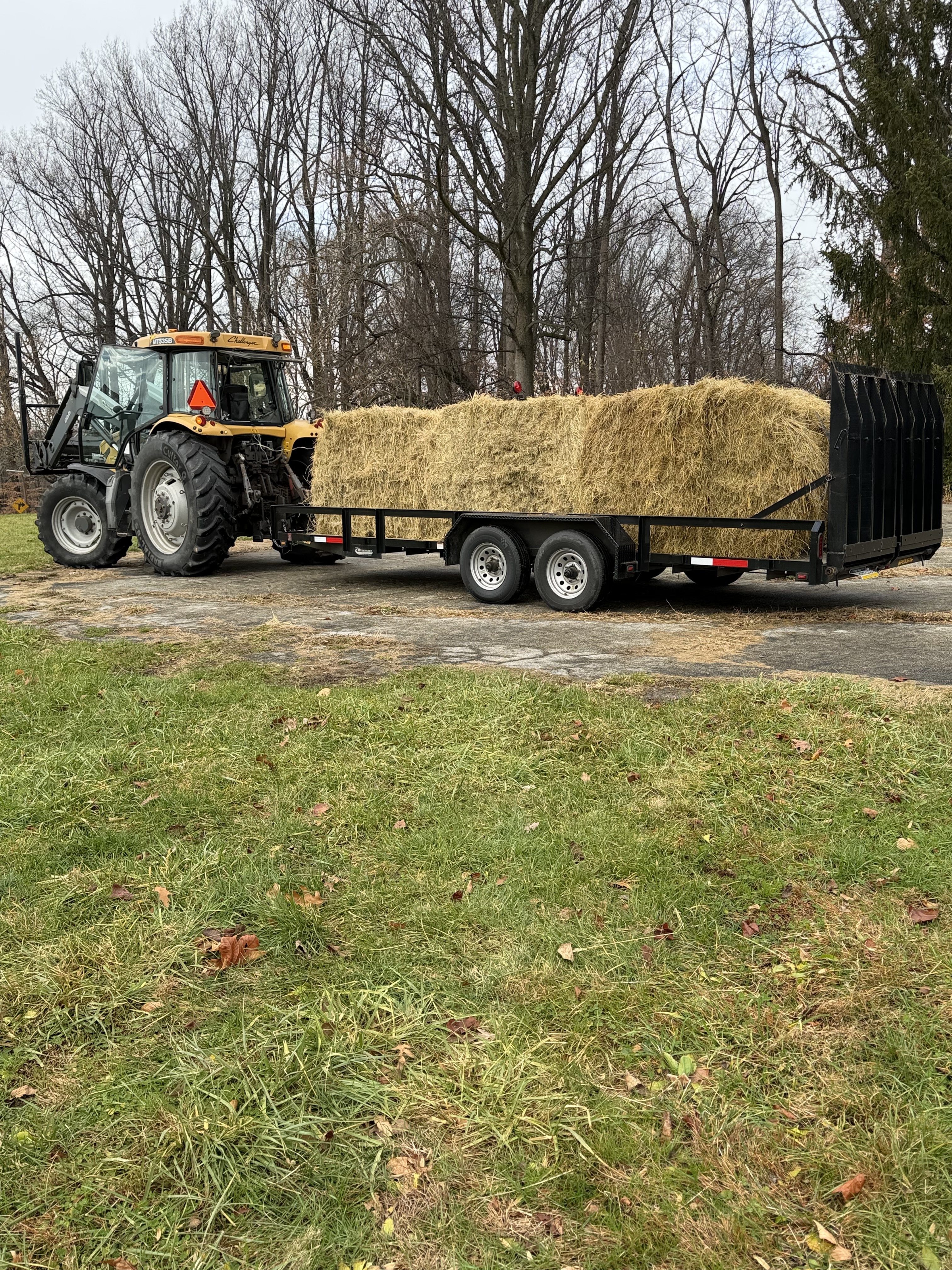

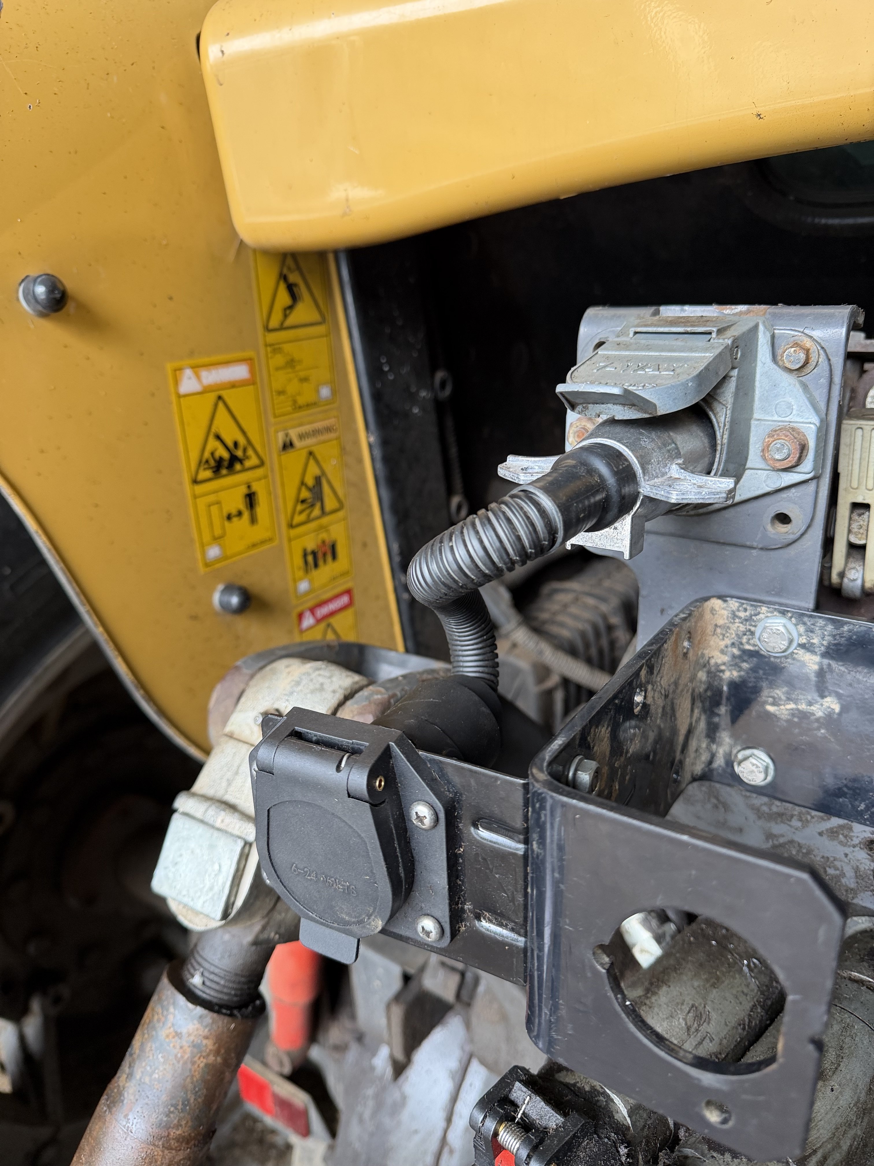

I pull a trailer with my tractor.
Since this photo was taken, I’ve made an adapter to run my 10K trailer turn signals from the tractor, too.
I use an a 2&5/16” ball with an extended shank. Bought a 20K version in case I move up to a higher GVWR trailer.

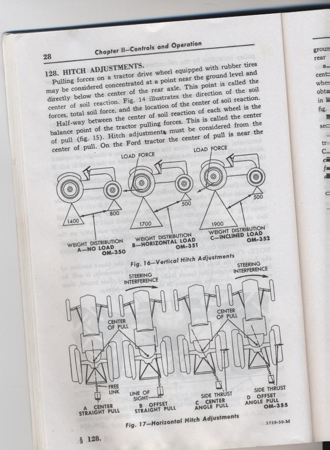

a load connected to the three point hitch always has the possibility of "walking over" the top if the load is suddenly increased.
when the load is connected to the drawbar and the load increases it does NOT create the "walking over" since an increase in load pulls the front wheels down .. the opposite of the 3 pt hitch.
How will any load behind the rear axle put more weight on the front axle? We're not using an equalizing hitch, which does what you said.
/ Pulling a trailer with your tractor #77
Sounds like he is talking about rotating the tractor on the rear axles. That is the reason tractors that have actual drawbars Always have them placed below the rear axle centerline .
I think he means as the pull point is lowered and if no rear tire slippage is allowed then the lever effect could increase the front axle downward force.

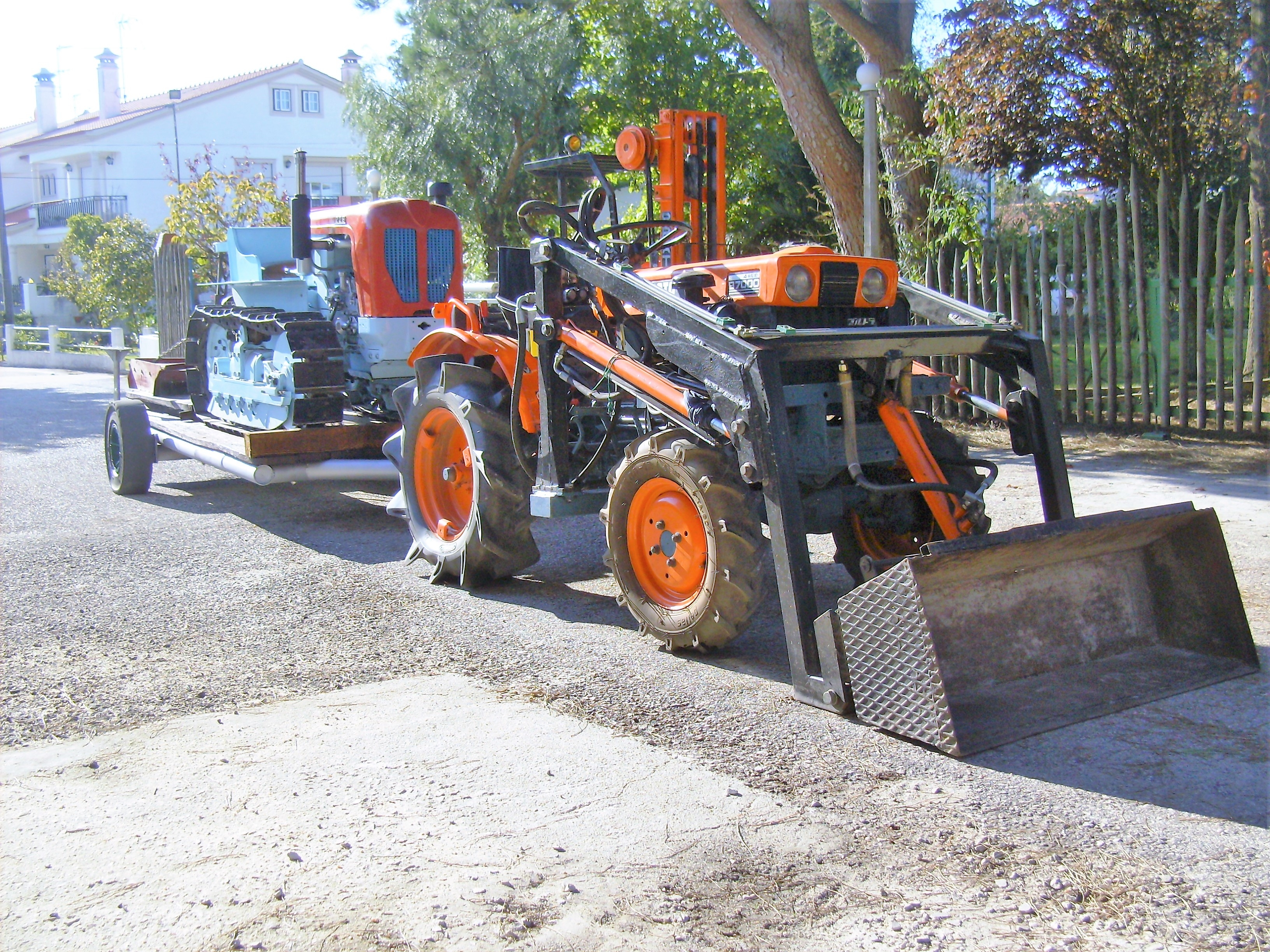

Small tractors can and will pull a trailer or a good load for all that matter. Will it pull as much as a bigger tractor? Of course not. Doesn't have to. Do people pull will them all the time? Sure do, just in a smaller scale since it's a smaller tractor and with the right transmission of course.
Here is a "little" Kubota B2650:
And the B7000 I used to have pulling my crawler:
