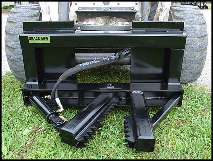

Here is a picture of a jaws type grabber, that looks easy to build.

If I remember right, the Star Hill JAWZ, is about $3900. Although it is well made.

P.S, It costs me $20 of consumables and some old sch 40, 2" dia steel pipe to make my boom. I have many other uses for it as well.
/ Pulling out posts etc. #16
Man, for four grand it is going to have to pull a LOT of posts.........
That is a rich man"s "toy", and appropriately priced as one.

My first thought when I saw that Jawz thing was whether it could be designed as a multipurpose implement with replaceable jaws, so it could also be a tree shear (which I covet), for example.
In any case, I think most small homeowner type tractors just wouldn't work well EXCEPT for pulling posts. First, the Mini Jawz model (with about 2000 lbs net lift) is the only one that would work for most of the tractors we talk about on this site. Second, 2000 lbs isn't a lot of upward force, except for relatively small shrubs and trees. For anything bigger (like my old field trees) you'd always be grabbing and pushing...and I can push just as well with my FEL bucket without the grabbing function! I'm planning on a grapple rake to clean up after (since the bucket is worthless for that job.
Like any of the multitude of implements available, there is no-doubt a special situation where the Jawz unit is just the right labour-saving device (eg, somebody with thousands of fenceposts to pull or many acres with invading shrubs)...but for all the other circumstances it would be an overly expensive solution for the job at hand.
