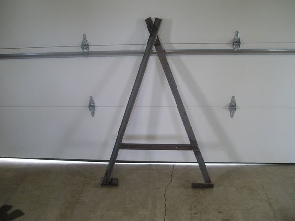

After reeding a long thread here a while back, I made this "A" frame from angle iron. It is about 4 feet tall and works the same way as Kennyd's truck rim would. If I ever make another one it will be about 6 foot tall so I can get a longer pull before removing the slack out of the chain.
