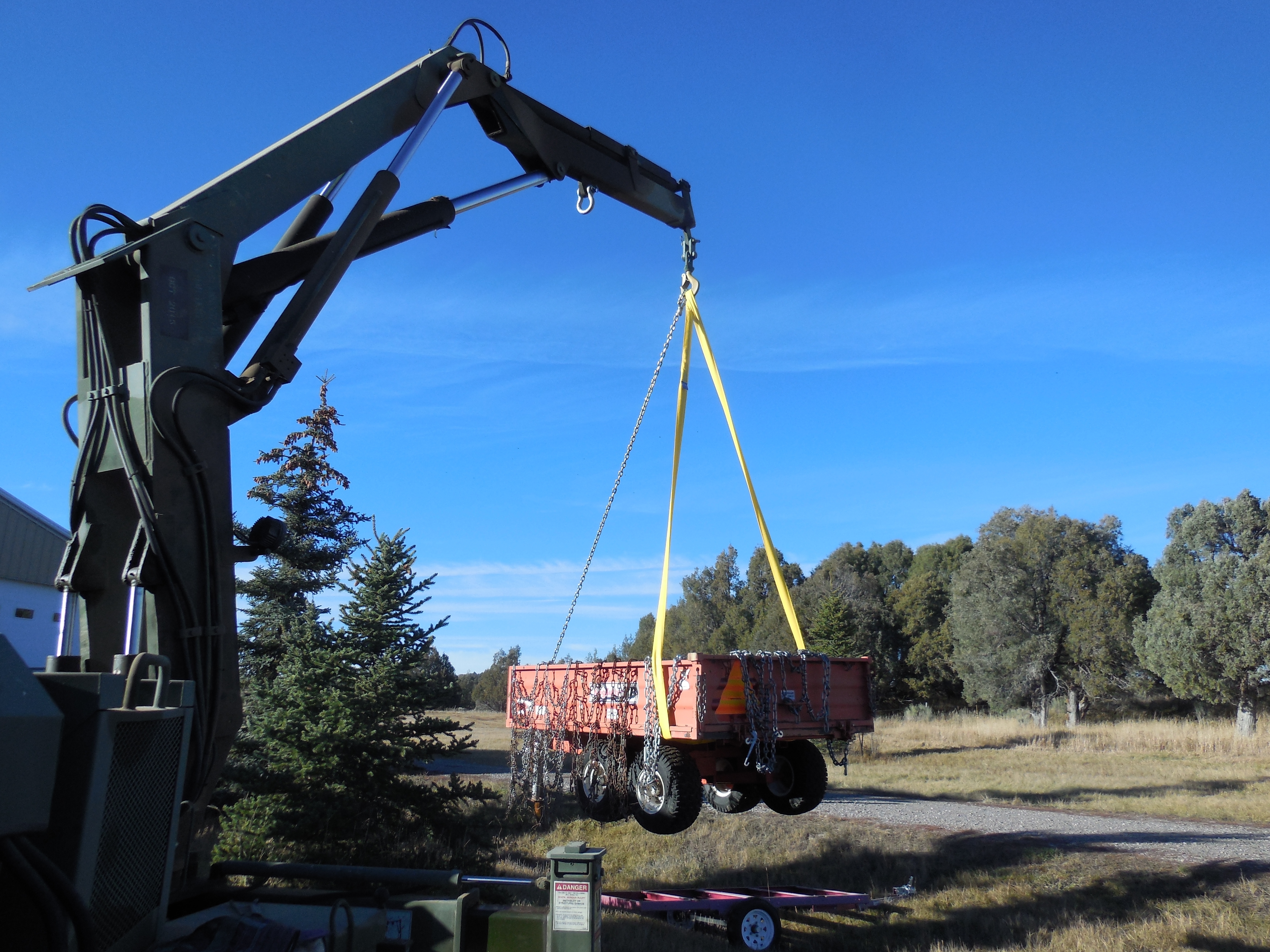

Coincidentally, I have been thinking about making a spreader bar to be able to drag a couple of our cars up on a trailer should the need arise. Through the wheels is about the only option, and the straps would have to stay outside of the sidewalls to clear the body parts. Sure hope I'll never need to use it.
   / Pulling stuck vehicles out of the ditch with a tractor #127
When you already have this….why bother with spreader bar :)
   / Pulling stuck vehicles out of the ditch with a tractor #128
Fair question. And if I put the crane on the trailer first it could be used to lift rather than pull the front of the car up on the trailer.
But I'd still need a spreader bar to keep the straps from touching the fenders.
