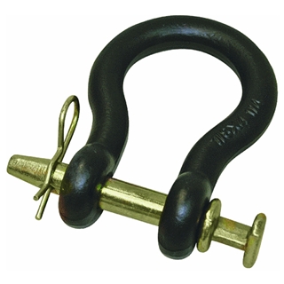

Too bad they don't make something you could attach to your drawbar that you could attach a rope to. :rolleyes:
clevis.jpg -Kidding. But as long as either the tree is weaker than your axle, or the axle is stronger than the pulling force of your tractor you should be good. :rolleyes: But I wouldn't bet on it, especially if you're trying to pull the whole tree over, roots and all.
