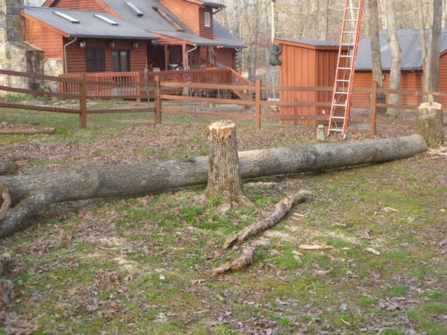

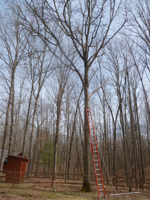

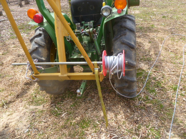

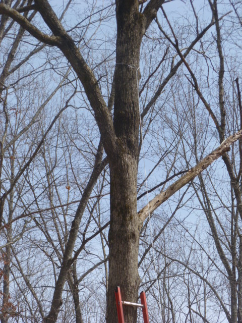

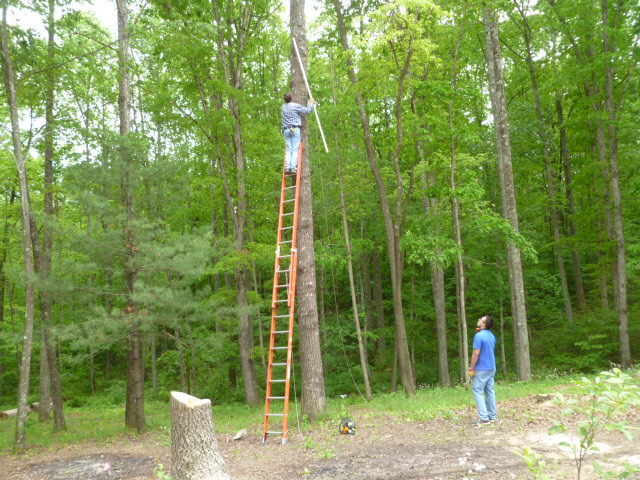

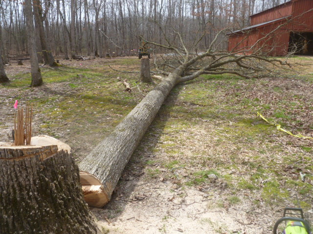

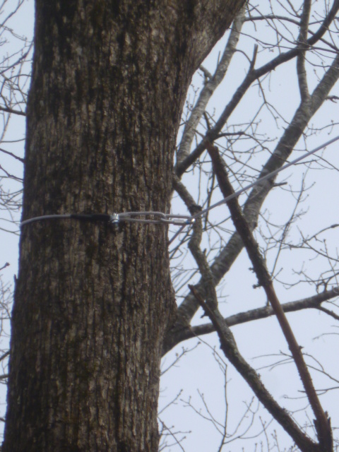

Albert, while I am no expert, I have felled about 150 trees on my property in the past 18 mos. Some of the smaller, like <5" dia, I can just push over with the FEL on my tractor. But for some of the larger, say 24" dia and some over 100' tall (mostly wht or red oak) this is my method: Using a 24' ext ladder, I climb to about 20', then use a 10' PVC pipe with a notch cut in it. I put my 1/4' shielded cable lasso around the tree and push it as high as I can with the PVC pipe. Usually get it about 32' up there. I put the tractor farther than the ht of the tree, and attach the other end of the cable to the ball on the drawbar. I tighten it up straight but done exert any force on it. Next I do the wedge cut and then the back cut. And sometimes I will add a center bore cut. Then I go back to the tractor (4WD) and use about 3rd gear (of 8) and just pull it over. Gravity takes over. Has worked flawlessly for me. I have the luxury of room to do this. I am not trying to 'thread the needle' re felling direction. I may be trying to avoid other fruit or "keeper" trees, but thats it.
