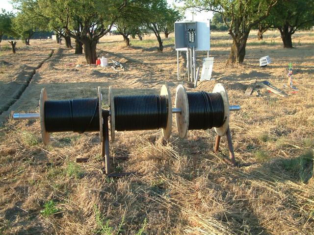

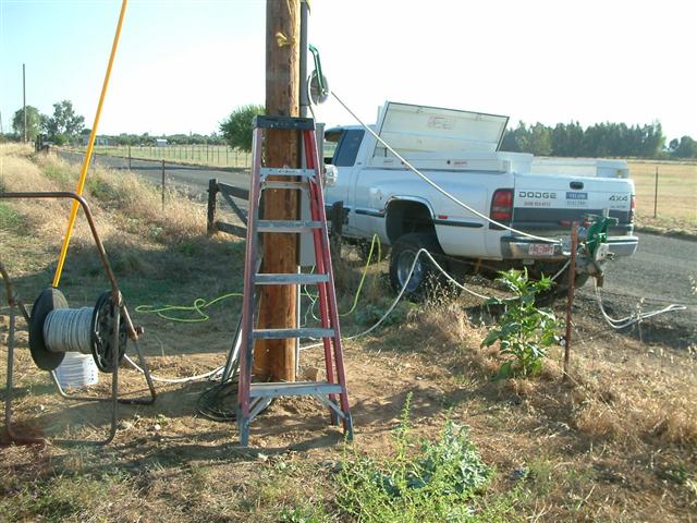

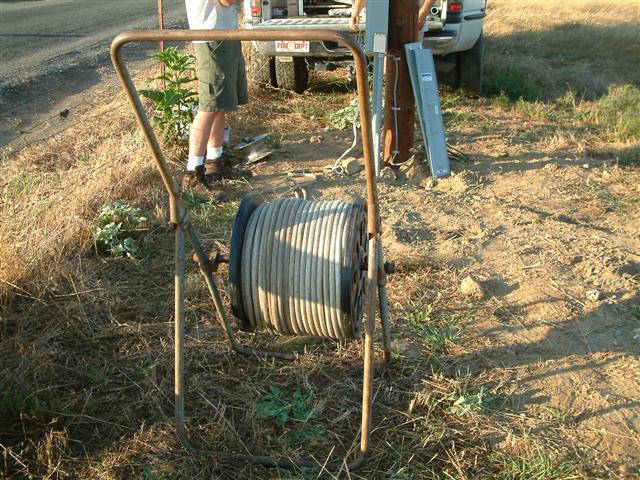

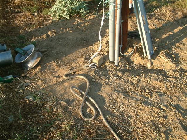

Here's how my electric service (220V, 200 amps) was installed. The trench is about 350 ft long. Conduit is 3" diameter. Two 4/0 and one 2/0 cable. They sent a thin nylon rope down the pipe using a shop vacuum and a plastic bag tied to the lead end. Then they pulled a much larger nylon rope through the pipe and attached it to the ends of the three electrical cables. A winch on the other end pulled the cables through the pipe with the help of a lot of yellow grease. Whole cable pulling job took about 90 minutes.
