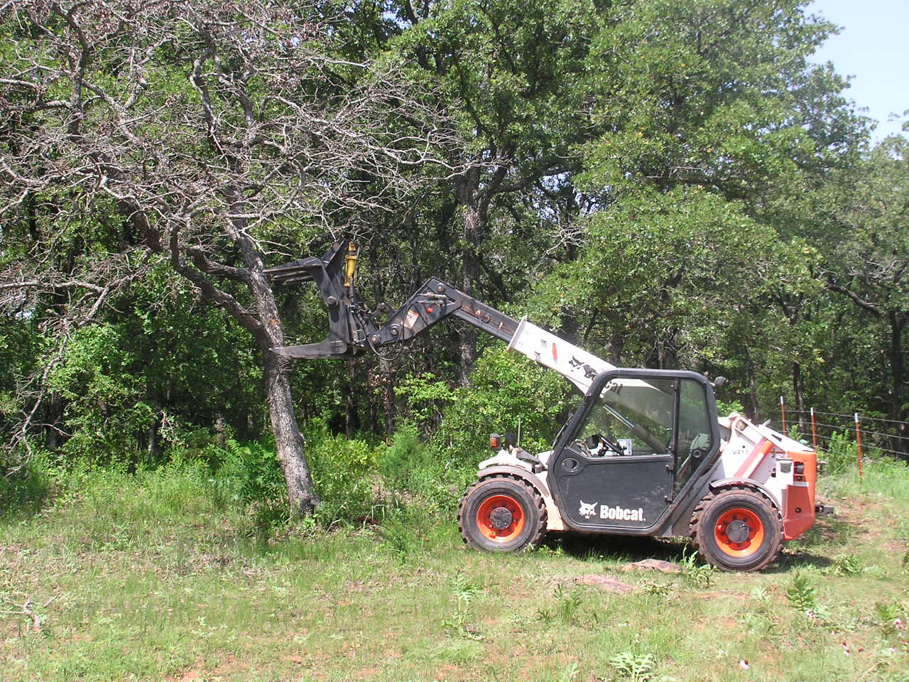

Is it dead or alive?

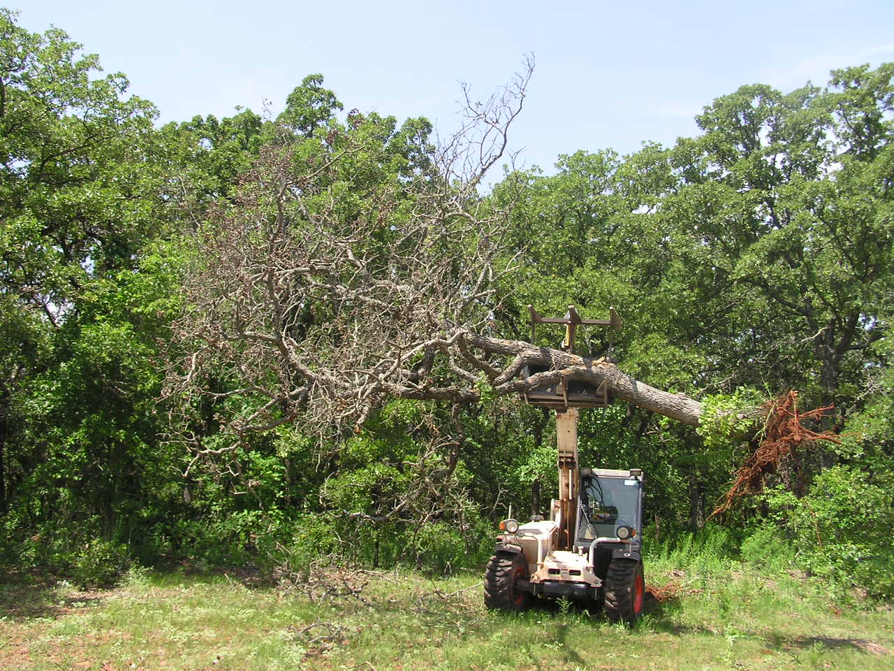

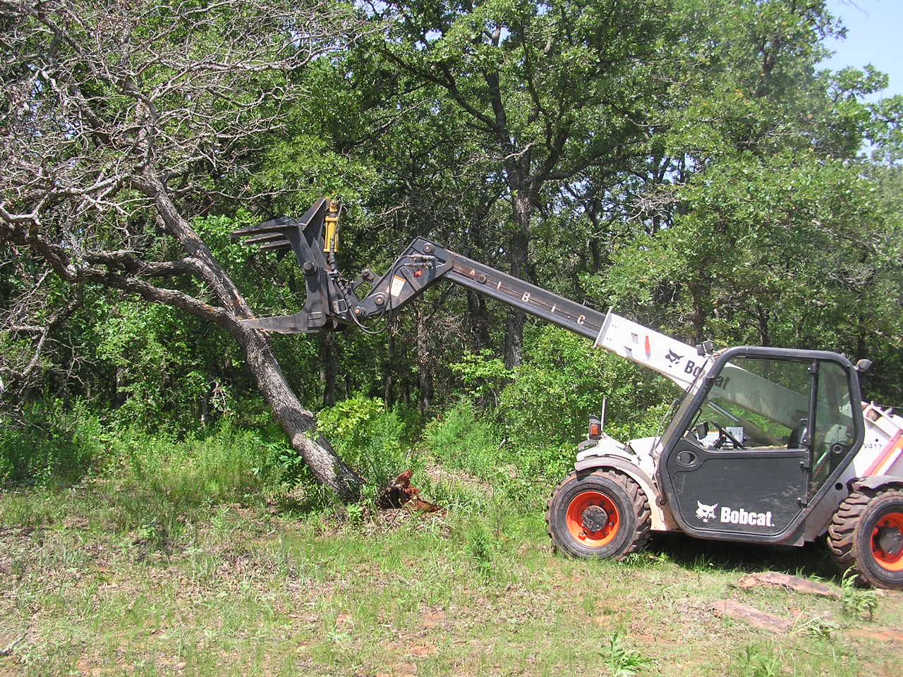

From my experience pushing them over with the V417, they will break if you get up too high.
The dead ones will break, pushing lower than one that is alive. Another unseen factor is that the tree dead or alive, may be hollow.
This one was not hollow.

It is alive and in good shape. I know what your talking about. Last week at the hunt club they were cutting some dead standing trees. They wanted me to push it with the bucket. No way. Way too much stuff to fall on my new tractor.
