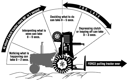

If a guy had a cable say 95' long and wanted to pull over a 12" oak tree that is about 65 feet tall. How far up the tree would be a safe pull. At what angle would be safe hooked to the drawbar without picking up the rear wheels.
Sent from my iPhone using TractorByNet
I've been involved with "cable drops" on several occasions. Allow me to know how much of a diversion fall from it's natural inclination is.
