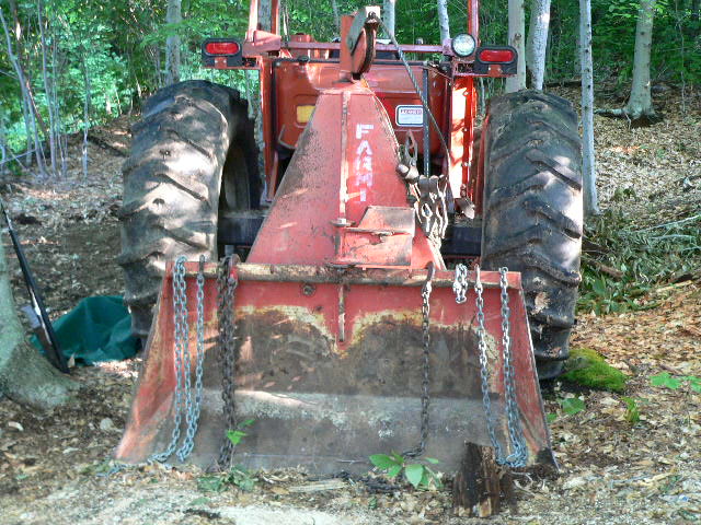

I always winch from the butt end. Irrespective of the way the tree fell. On occasions when the stump is in the way I cut a wedge off the stump such that the tree can be winched over / past it. When I cut fire wood I am usually selective cutting in a stand of trees. I cut in February and let em lie until August. In august I winch them to a single spot, all butts pointing in the same direction, and then with the loader push them up in a pile. Come September through November I pull 3 or 4 out of the pile with the winch, one at a time, limb each and line them up for a hitch to the bucking yard. Hook em up and off we go. The bucking yard is immediately in front of the wood shed. I skid to the yard, drop em, giv em a push into a pile and go get another hitch.
Buck em, split em and stack em. It has taken me a while to get this routine down pat, but it is as efficient as I can make it.
I always skid butt first as with very large stems, limbing does not always result in eliminating a crook the can get hung up on something, plus my bucking and splitting yard is a distance from the felling locations and I really don't want to have to take the big limbs off before the skid, anyway. Skidding is dangerous enough without risking a hang up pulling against the grain...
I am trying to handle the wood as little as possible and generally only cut limbs off at the felling location, that are too small the be worth the effort for firewood. The rest of the tree, including big limbs, gets skidded to the bucking / splitting yard, in one piece.
I either then pile up the brush for critter habitat, chip it for landscaping use or leave it lie on the logging road for traction and firmament.

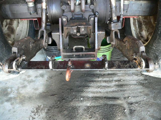

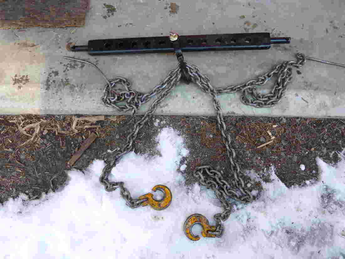

Gordon and Machold, here are pictures of the logging bar rig and specifically how it is rigged to the lower links so it will not pivot thus keeping the chain hooks "paws up".

Ah, now I understand. As they say, worth a thousand words. Thanks for the pics :thumbsup:

More information on this. My winching / skidding tractor is a big fella with a Farmi 601 winch. My splitting tractor runs the TMS with its own hydraulics and the splitter beam actually sits on the wood shed floor, which is raised off the ground.

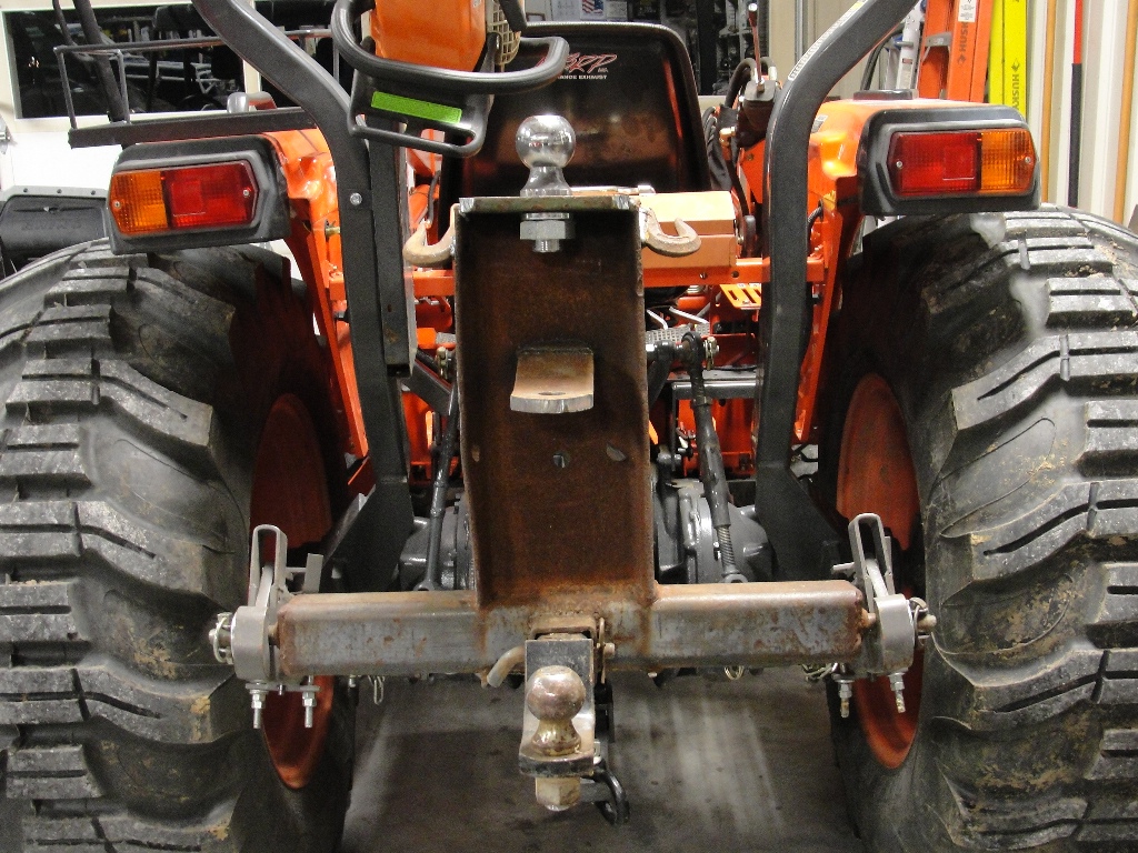

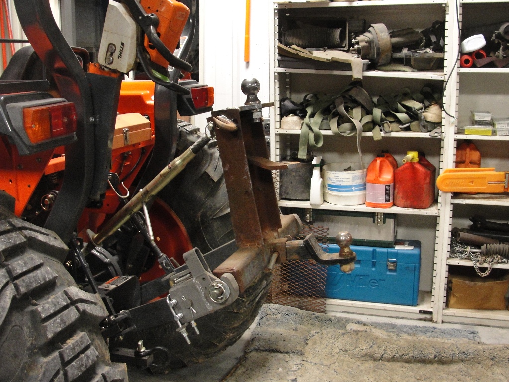

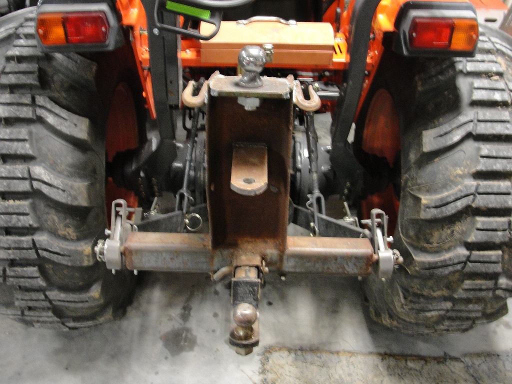

This is not specific to logs, but I built this 3pt hitch device to do a multitude of tasks. The only time I hitch to my fixed drawbar is to tie down on the trailer or to pull tongue hitched ground tillage equipment.
That set-up looks pretty versatile.
Interesting tread on your tractor. What style/brand tires are those?

Glen and rd,
I grooved my tires about six months ago. I maintain Jeep trails frequently and was looking for better traction on hard packed Missouri clay. I noticed an improvement. I was concerned about weakening the lugs as I use my tractor pretty hard so didn't groove them any deeper. I haven't noticed any tire fatigue or failure yet. I'm hoping for better traction on frozen ground as well.
Deadhorse,
I would have put the hooks higher if I could have. I have my hand on the 3pt lever when pulling so aren't worried about tipping over backwards. I know the Safety Police will be all over this statement, but, I never pull off my fixed drawbar, always pull on the 3pt. Also frequently have the front tires off the ground. That's how I "roll", PUN INTENDED!!! :p
