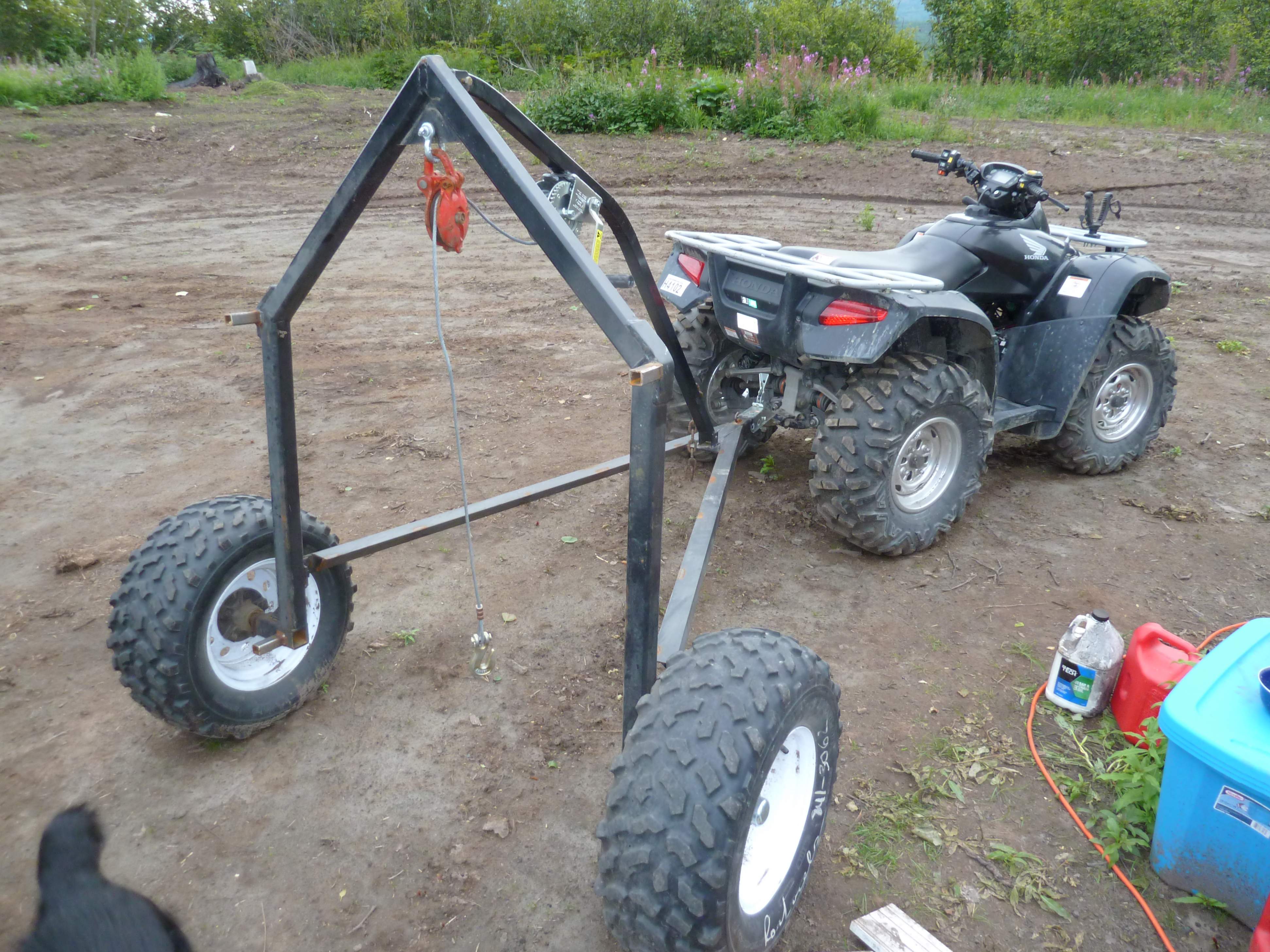

for pulling logs and such it is easy to make one of these. I built this in a day for my quad and I also use it behind my 135 ferguson. It folds down to make a good trailer too. Would only use it on the drawbar though. Using the 3pt will rotate up as the frontend will come up if you have good traction.
the one on my jd has a hyd winch, and some hooks on the lower crossbeam.

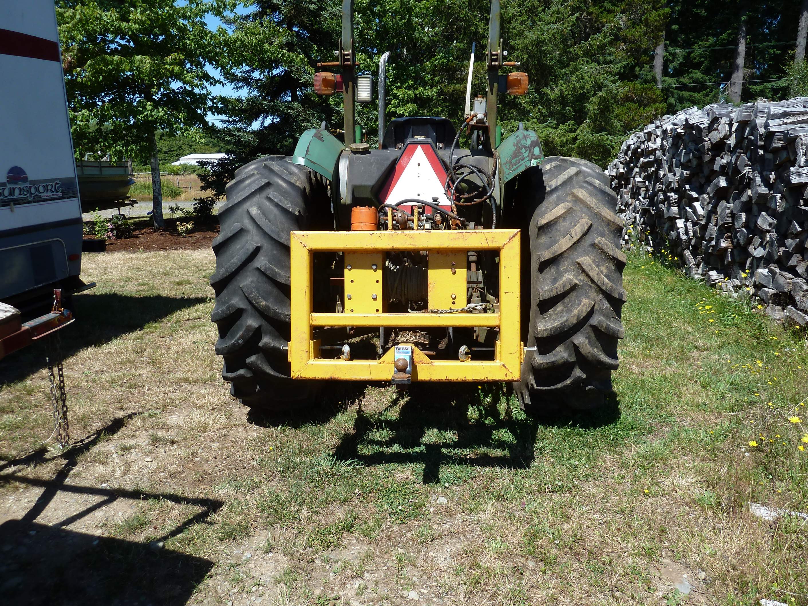

I have two methods, depending on the nature of the skid job.
If I am using the winch to pulls trees from where I felled them in the woods, I drop the choker chains in the skidding slots of the skidder blade, raise the TPH/winch body off the ground and off we go. The skidder blade won't let a butt end contact an obstacle without hitting it first. see first picture.
The second method I use when I am skidding from a pile of logs I have already dozed into a single place. The skidding bar is easier to work with for quick hook ups and releases. it also takes a lot less time to install on the tractor. I can see the pull easier, too as the winch is not obstructing my view.
Either way, be careful and remember the quickest way to move a heavy load is SLOOOOOOWLY.

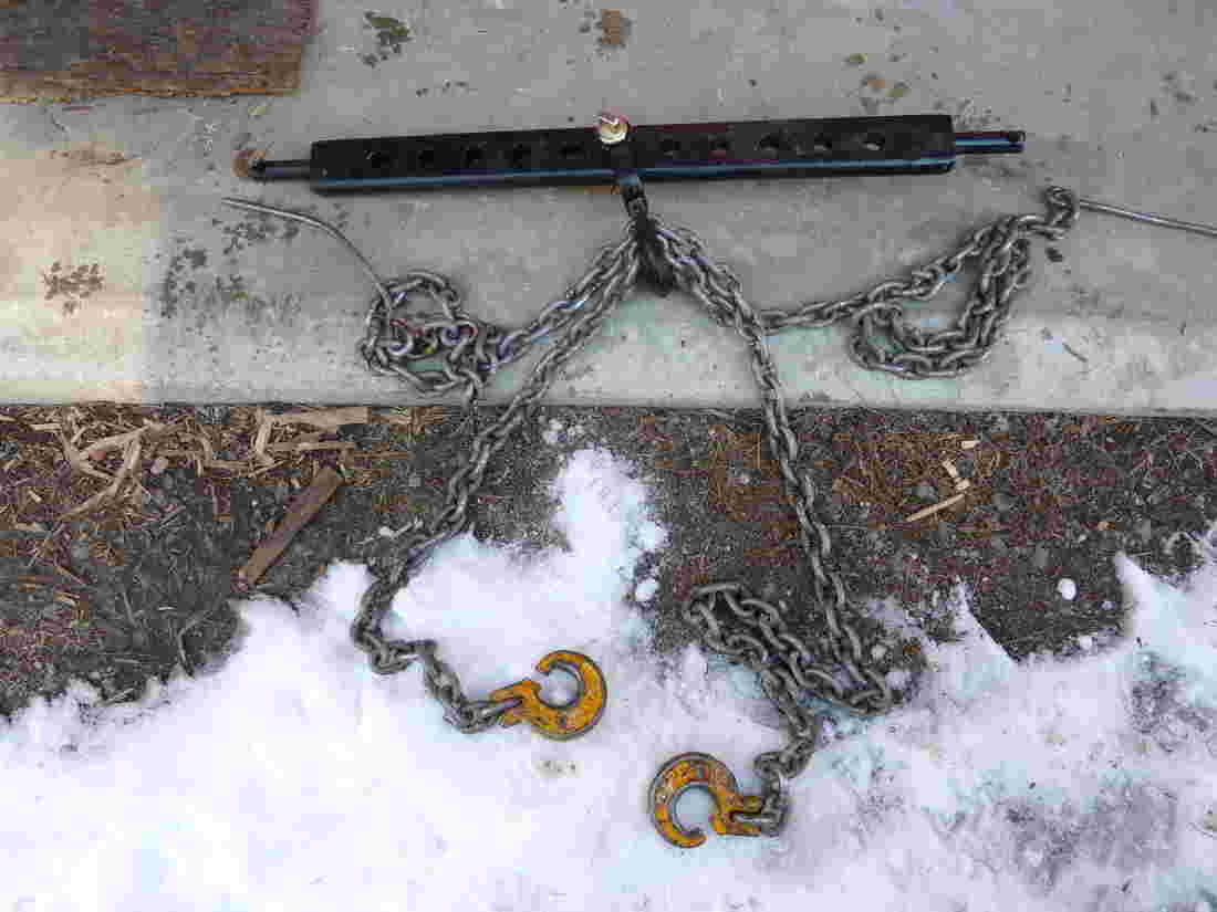

There have been millions of logs pulled with a skidding bar on the 3ph lift arms like DeadHorse made. If you don't want to make your own go to TSC and buy a cross draw bar, one or two tractor hooks, and some chokers.
I would rather pull with the butt of the log lifted up off the ground a little than have it dragging. But either way go slow and easy.

/ PULLING #14
Gordon, I use logging chokers with that bar and cinch the butts up tight with the bar resting on the butts. Then I actuate the lift and get the butts off the ground for my pull. Also, there are 4 fixed hooks so each choker gets its own location and the logs don't bunch up on each other.
I do not recommend pulling logs with the butts in the dirt. You can get a nasty surprise VERY quickly that way.
My skidding bar is attached to the lower links in the back on each side such that it will not rotate and the chain hooks remain "paws up" during the lift and pull. This was a key design feature. In the picture I posted the links are not installed so I need to post a new picture to explain,
The chain hooks on each end have the holes where the chain lynch pin is inserted. The bottom side one is welded to the bar, but the one on the top is available and with some small clevis hardware they are linked to the inside of the lower links.
