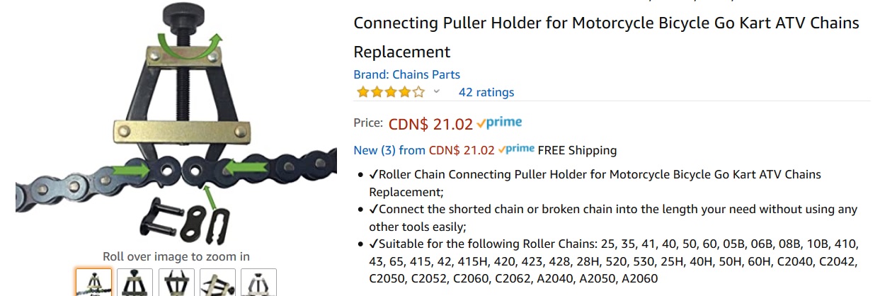

A few times in my life I got lucky and found the proper chain tool could pull the two ends together when trying to do it any other way just did not work.
The tools come in different sizes depending upon the chain size.
Dave M7040
