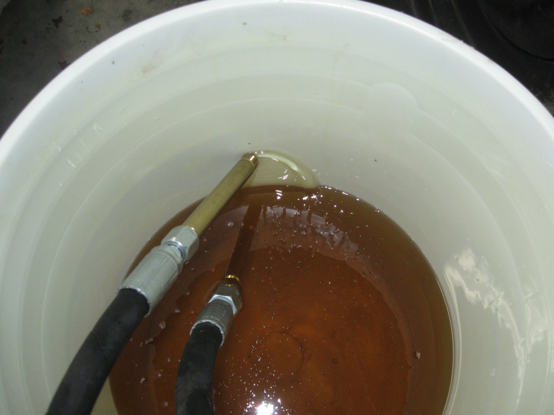

Trying to restore a 3pt lift system on a 1949 Jeep. The system consists of a small pump mounted on the front of the engine and coupled to the crankshaft pulley, return & pressure hoses running to the rear of the jeep to the lift. The lift assembly contains the reservoir, control valve and ram. Had the original pump at a shop, which said the pump was too worn to repair. However the pump was the same as that used on the IH C tractor. I purchased a used C pump and it appears to be same pump. Put the simple manifold on the new pump and mounted it on the jeep. No output on the pressure side.
This is a small, geared pump. Would it work, regardless of the rotation? Can I simply reverse the manifold (return/pressure lines)?

Depends on if the pump was built to be bi-rotational or not. Most gear pumps have the shaftseal cavity vented to inlet so that pressure does not build up and blow the seal out. Some pumps have the bi-roational checks to allow for this venting and some do not.

I reversed the manifold and it still didn't move the ram. I removed the pressure side line, with the jeep not running, just before it enters the control valve and the fluid dripped out. That didn't happen before.
Is it possible for the system to be air-locked? Also, I'm not sure the valve is working correctly. I've ordered a pressure gauge and it should be here next week. I'm assuming that should be my next step.

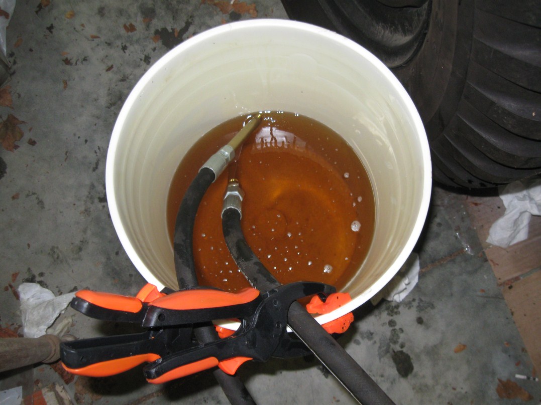

If you can! Run hoses from the in and out and put the ends in a 5 gal. pail that is about 1/2 full. Start it up and there should be flow. See if that can tell you some thing.
/ Pump running backwards? #9
You will know if you have hyd flow through the valve in an open center hyd system as the fluid is always flowing as long as the pump is pumping.
The pump may not have prime.
Is the suction port connected to tank?

Thanks for the suggestions.
J.J., is there an easy way to ensure the pump is primed?
The inlet hose comes out of the tank and almost immediately goes over the rear axle. If the pump is worn, I assume it is possible that there isn't enough suction to pull the fluid over the axle.
I'll try to see if it pumps from the 5 gallon bucket. May take me a couple of days to get back with the results.

You can try putting some air to the tank, about 10 to 15 lbs.
Try filling the suction hose with fluid to see if you get an output.

The pump works! At least I got a steady flow into the bucket. I did have the manifold reversed, so that is good to know too. It is correct now. I put some fluid in the section hose and started the jeep. Got some bubbles, so stopped the engine and filled the hose as best I could.
Next steps are hook the hoses back up to the tank and control valve. For now, I'm going to reroute the hoses so they don't pass over the frame (I had said axle above but the reservior outlet is about the same level as the rear axle).
Now on to the next phase, testing the control valve.
Thanks for all the suggestions/ideas. Hope to report more progress soon.
