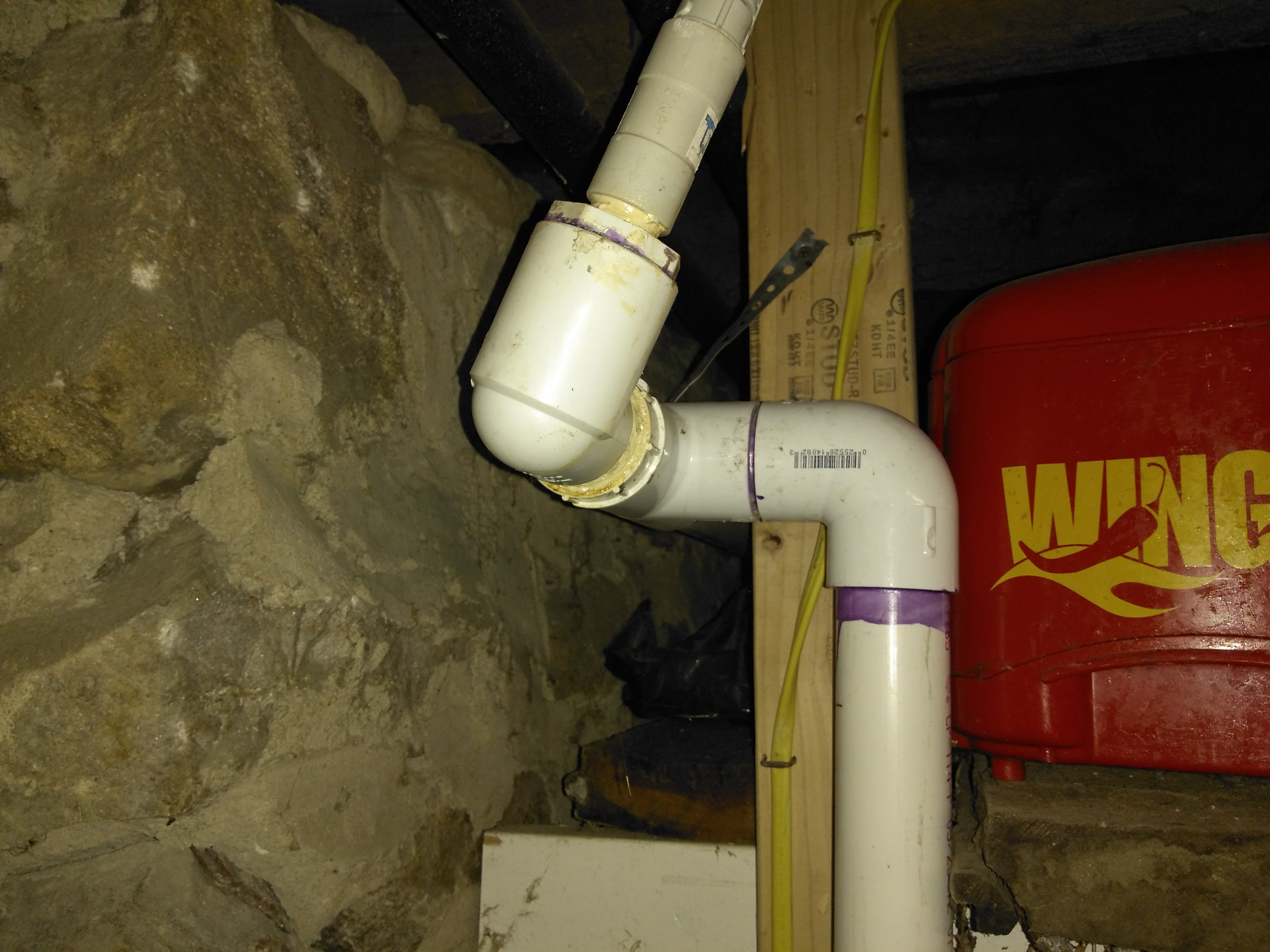

Here is what I did for our house. The end of the drain line is at or above the level of the sump pump so just putting a hole in the check valve wouldn't work. The line comes up off of the pump goes through the elbow, through the tee and outside. The well foot valve let's everything from the tee on drain down, but doesn't let water leak out.
