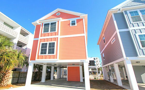

If the water table is high, there's no way I'd want a basement. Instead I'd do like they build in South Carolina (for example), houses on stilts.
I just don't see how even with extensive work, trenching, waterproofing, diverting you could ever have a dry basement. All that water has to go somewhere. south-beach-new-2014.jpg
