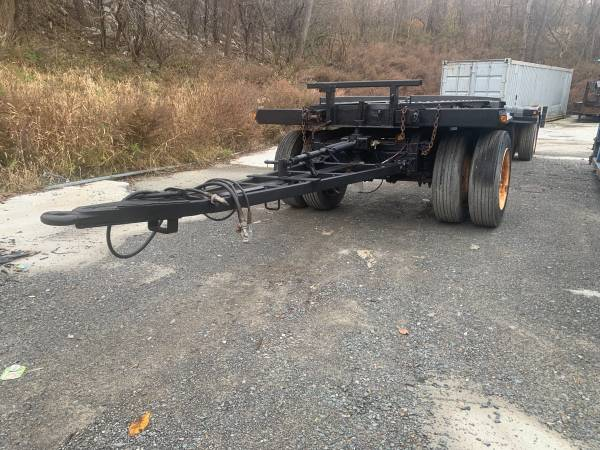

#17
this one has a long tongue

#19
Does the PUP trailer I posted have a converter dolly? It appears to be a permanent front axle. Probably has no bearing on the question, just thinking out loud
/ Pup trailers #20
I cannot tell for sure but you may be right. The fifth wheel on some dollies sit real high and would be obvious. Others, the trailer rides more level.
