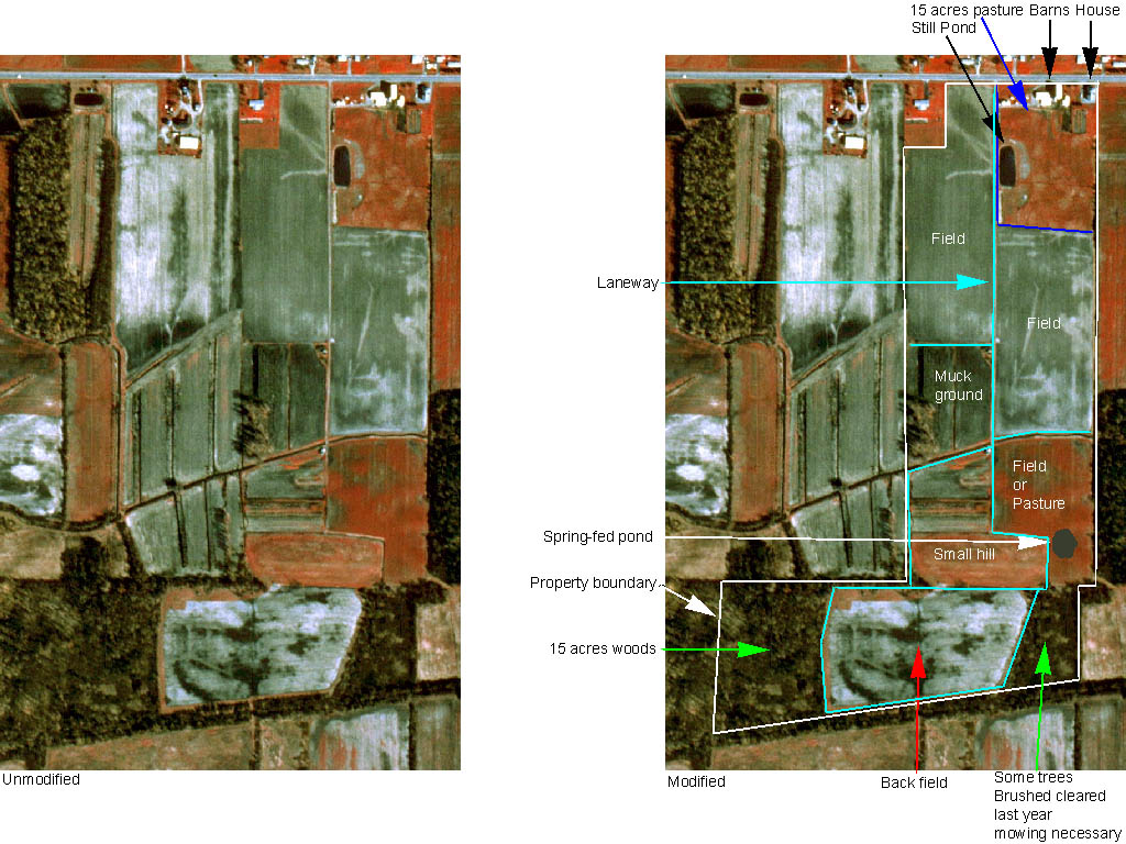

cowboydoc, thanks for the reminder from my original post. The tractor will also need to do our plowing/tilling/dirt moving operations. There's a pretty big laneway down the property which I'm not sure should be plowed during the winter (I guess this will depend on whether I need to reach the back of the property or not!). Sounds like you're still leaning me to the bigger tractor! :) Thanks for the input, I'm attaching an aerial photo from New York State from a while back of the land so you can see the layout. I'll include a "doctored" version as well, hopefully this will make some things more "clear".

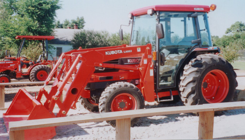

We have only one overstock L4610 hst unit with loader and cab @ $28350. -http://carverequipment.com/cool_season_new.htm
Thanks,
Steve

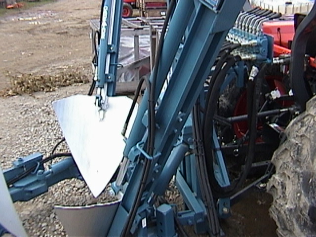

Made a trip to my dealers today, took the camera, pretty sure he had tree transplanter on the lot. The attached pics show a reconditioned mod. 500 3P mounted on a L4300DT. It is cat 1. Holes in attachment will allow cat2 pins. They stated they sell quite a few for the L series and the people love them. I learned a lot about tree transplanters today/w3tcompact/icons/wink.gif. Apparently a 20" ball mach. is for a 2" trunk dia. 30" ball for 3" trunk etc.
He mentioned one customeer using the 20" on a L3010, guy then upgrades to a L4610, then upgrades to the 30" transplanter. Dealer says they love it. The website for this transplanter is www.caretree.com.
If you don't find what you need there, I have about 20 pics and some brochures. Hope this helps.
regards
Mutt

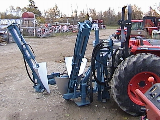

   / Purchase Grand L Ten or M Series? Need help... #29
pic 2

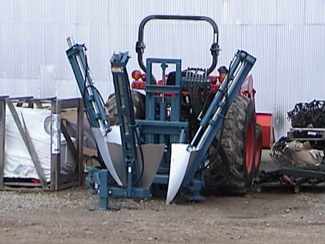

   / Purchase Grand L Ten or M Series? Need help... #30
pic 3
Note: this set-up requires one pair of hyd. remotes
