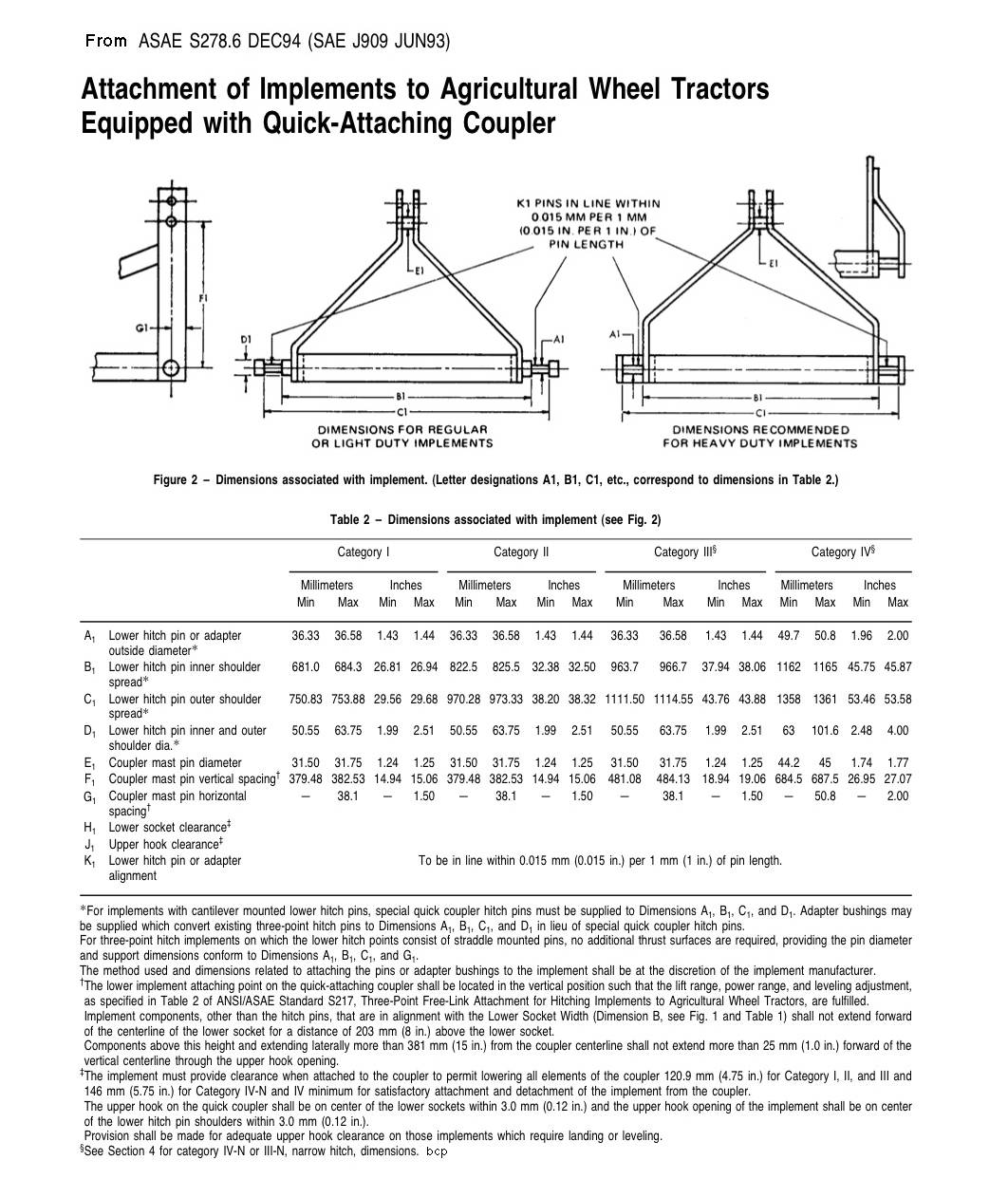

Well here is copy of supposedly standard for QH.... Unfortunately about a few hundred thousand implements out there from eons ago that do not fit specification nor do a lot of manufacturers currently manufacturing implements who have ignored the standards.....
Solution is to get quick hitch of choice and "fit" all your implements to "the standard" of your QH and move on...
