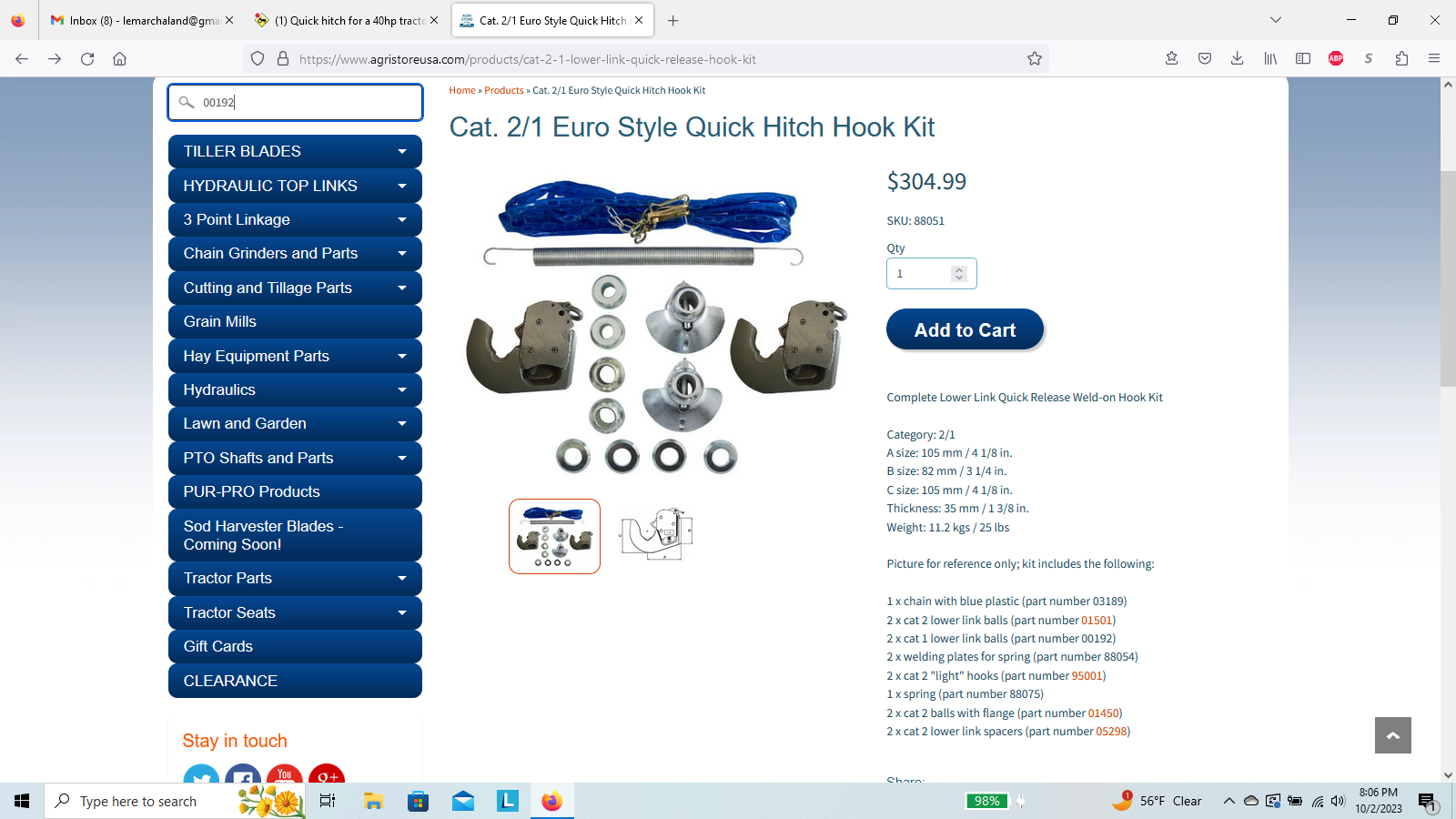

What's the difference between Pat's and a euro mount?

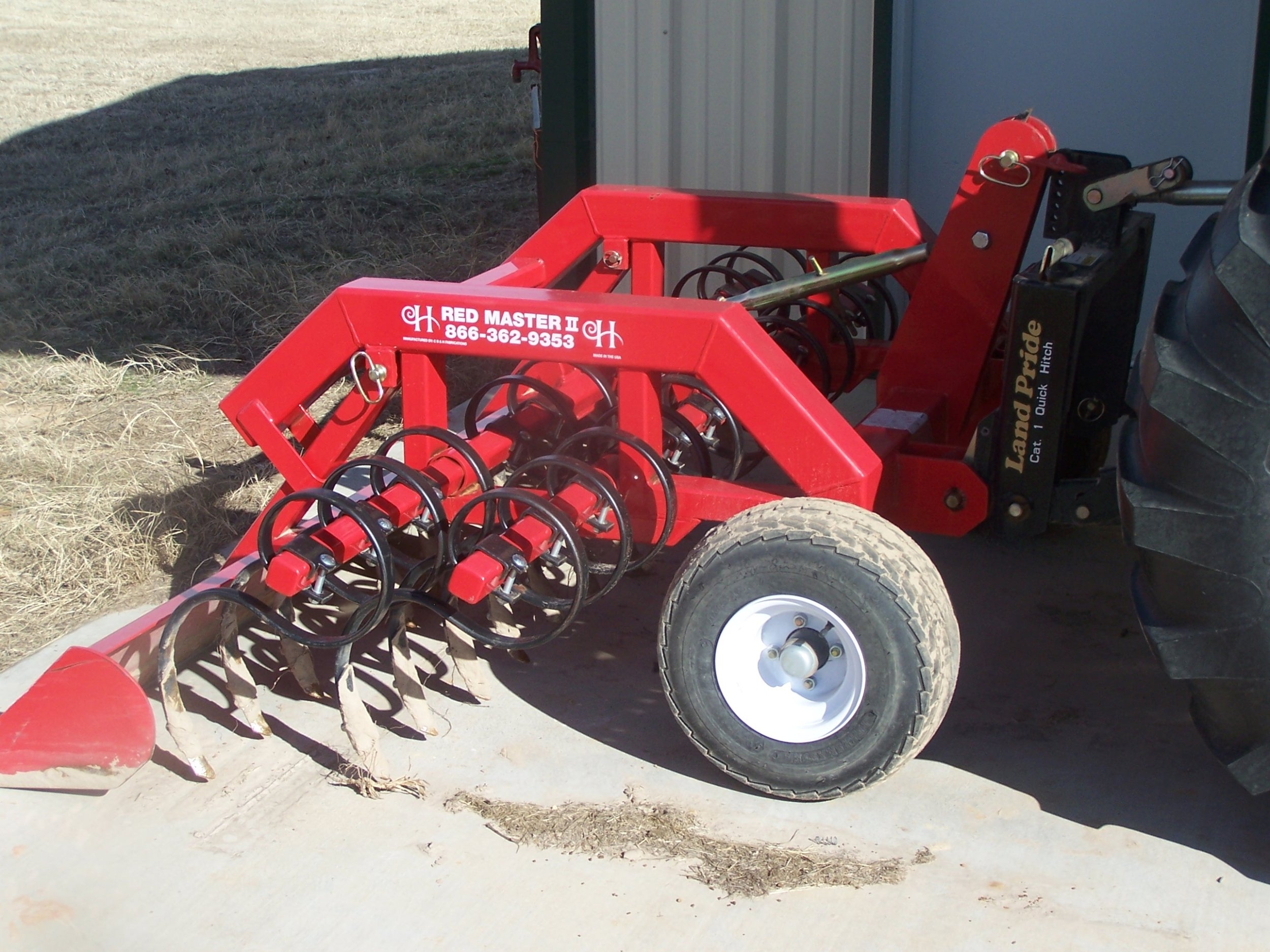

I have a Land Pride QH15 on both my tractors, 40HP and 75HP. Works great on both. I do have to adjust the top hook when hooking up, depending on the implement. The top pin on the arena drag is very tall compared to the Land Pride implements.
I wish I could do a hyd top link but I only have one remote and I use my grapple to much.
The Pat's pin on with just a U shaped hook, using your existing ball.
They form a ridge U shape that does not swing with wider or narrower implements.
The euro quick hitch arm ends are a weld on replacement for your swivel ball end on the lift arms.
They capture a ball when latched that allows movement when raising or lowering.
I have several sets of the implement balls and they stay on the implements when I disconnect and go to the next.
This kit has 3 different sets of the implement lower balls, one set with flanges that helps guide the lift arms into alignment and two pair, one cat 1 and 1 cat 2 without the guide flanges.
This set has slightly larger hooks and can handle cat 2 implement balls as well as balls with a reduced center for cat 1,
they also have smaller hooks that take a smaller OD ball for only cat 1 implements.
