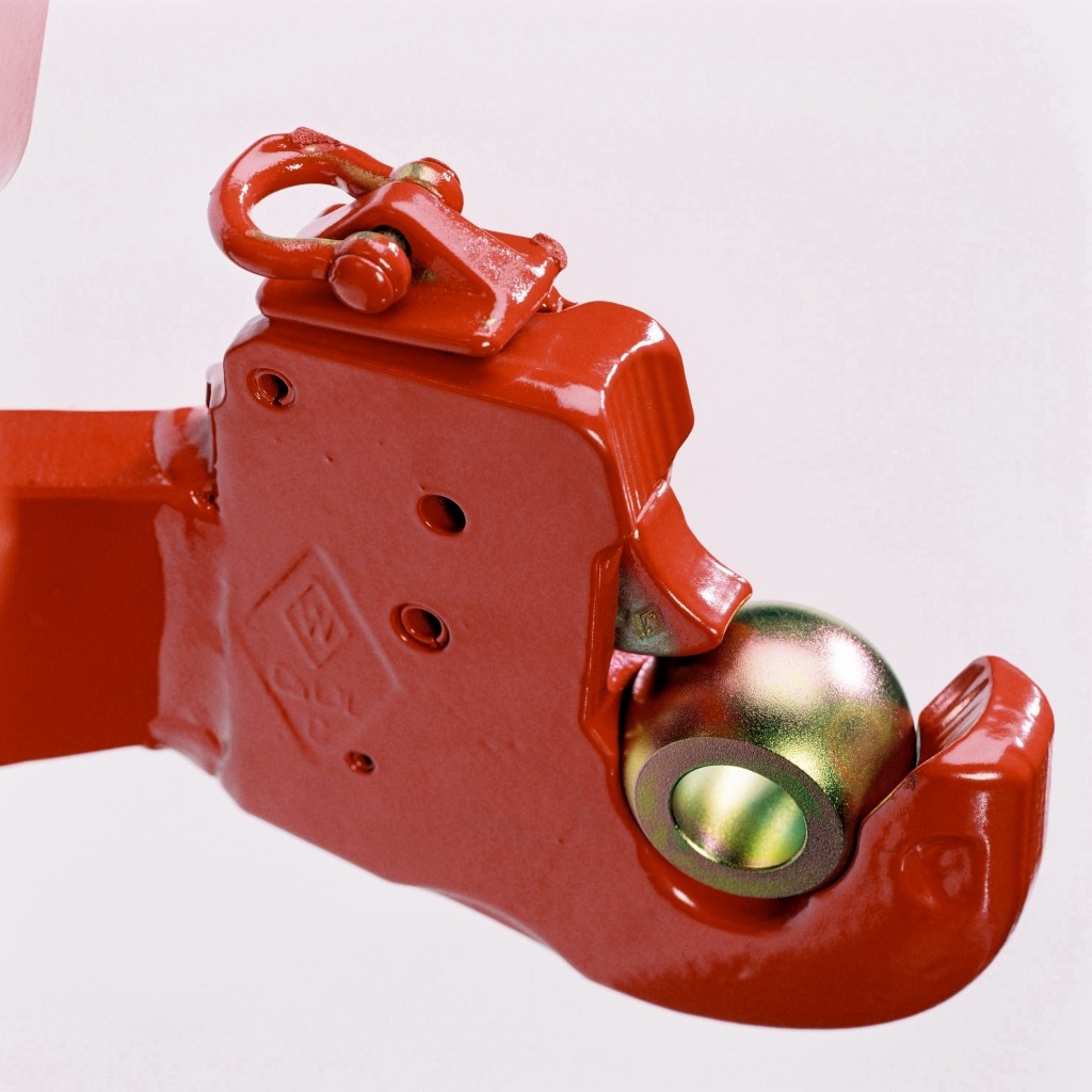

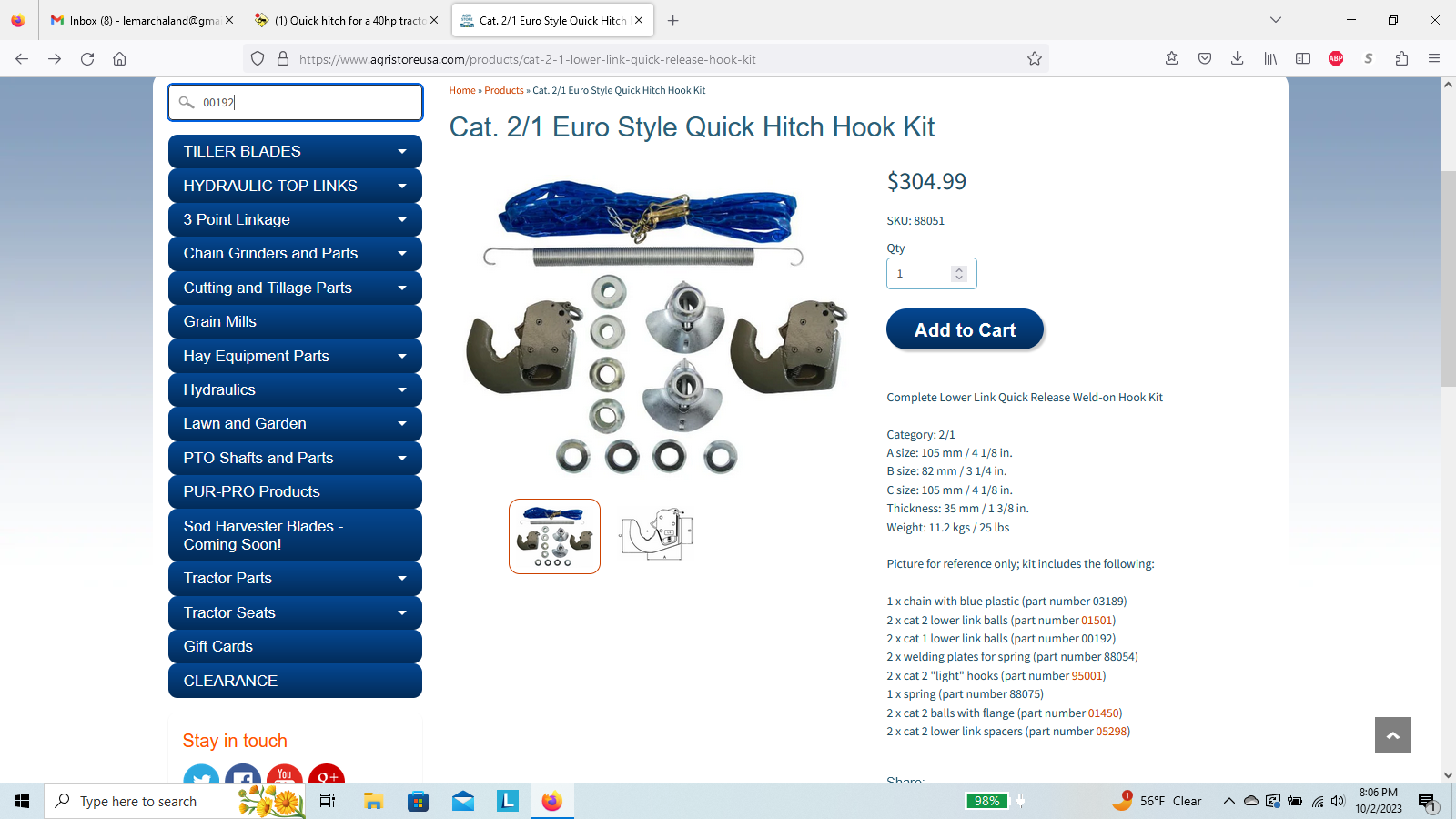

Euro hooks. Best thing ever. My Branson came standard with it and you can get them on Agristore USA or here at the forum via FitRite (@MtnViewRanch).
Pros:
- Super strong
- Super easy to use
- No frame in the way of hooking up PTO shaft or hydraulics
- Retains the ball joint and freedom of movement in all axis (contrary to PATs, which results in broken stuff)
- Doesn't extend the arms any further
Cons:
- If it didn't came standard, it requires cutting the current ends off and weld the Euro hooks. Personally, don't really see it as a Con.
As far as price goes, over here I can get a set for €140 + €5 for each set of balls. In the US, I believe in the $150 for a set of hooks without the balls on Agristore.
If you want some experience based in the US, members like @Avenger and @LouNY have them as well. Lou even got the top link hook to go with it.

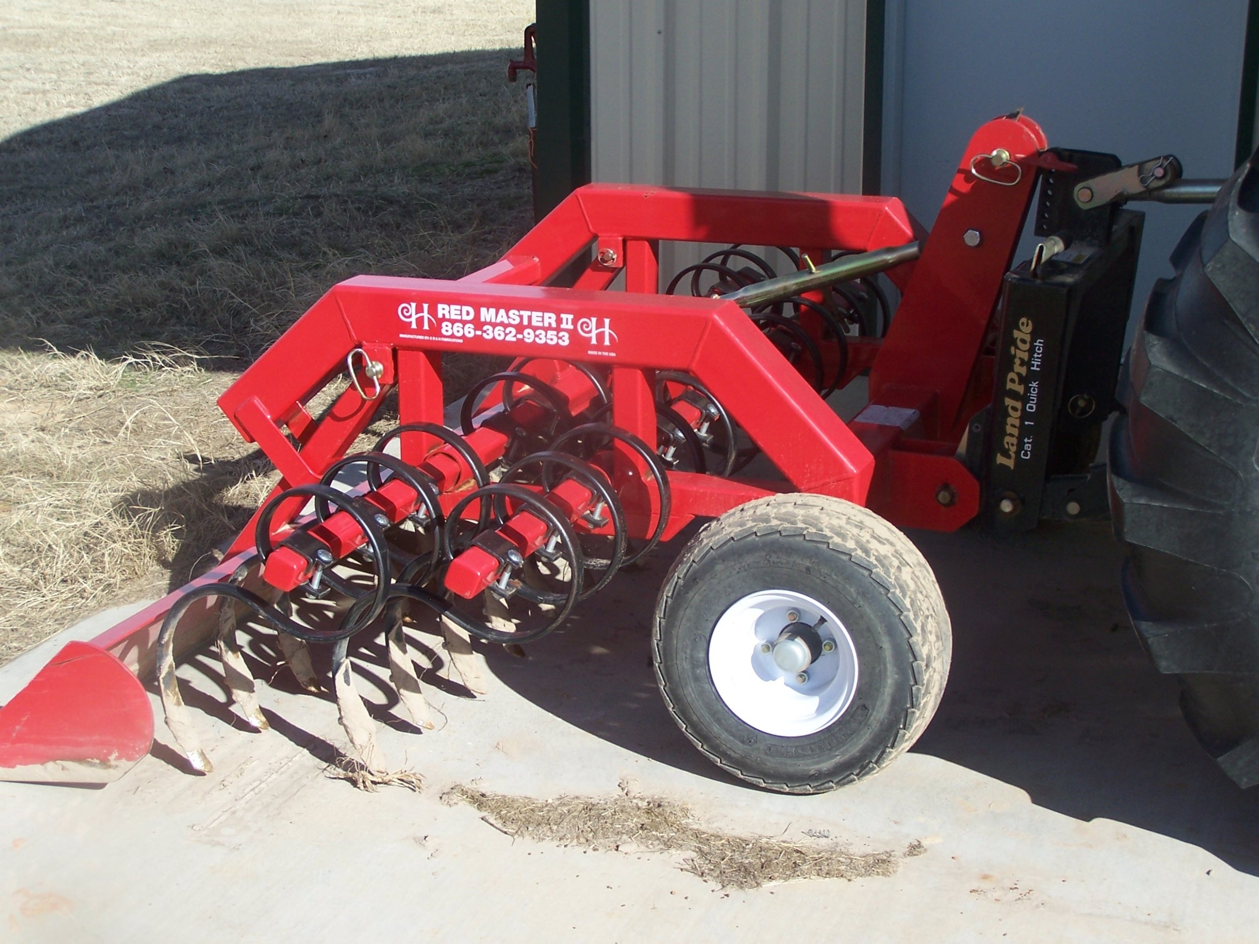

I have a Land Pride QH15 on both my tractors, 40HP and 75HP. Works great on both. I do have to adjust the top hook when hooking up, depending on the implement. The top pin on the arena drag is very tall compared to the Land Pride implements.
I have mostly all Land Pride implements but when it came time for a quick hitch I bought the Braber Equipment one. Looks identical to the Land Pride with the adjustable top hook and it was half price, at least here in Canada.
So far no issues with it since 2013.
I use the same model on my Kubota B2620 and my Ford 3000 diesel.

The Pat's pin on with just a U shaped hook, using your existing ball.
They form a ridge U shape that does not swing with wider or narrower implements.
The euro quick hitch arm ends are a weld on replacement for your swivel ball end on the lift arms.
They capture a ball when latched that allows movement when raising or lowering.
I have several sets of the implement balls and they stay on the implements when I disconnect and go to the next.
This kit has 3 different sets of the implement lower balls, one set with flanges that helps guide the lift arms into alignment and two pair, one cat 1 and 1 cat 2 without the guide flanges.
This set has slightly larger hooks and can handle cat 2 implement balls as well as balls with a reduced center for cat 1,
they also have smaller hooks that take a smaller OD ball for only cat 1 implements.
