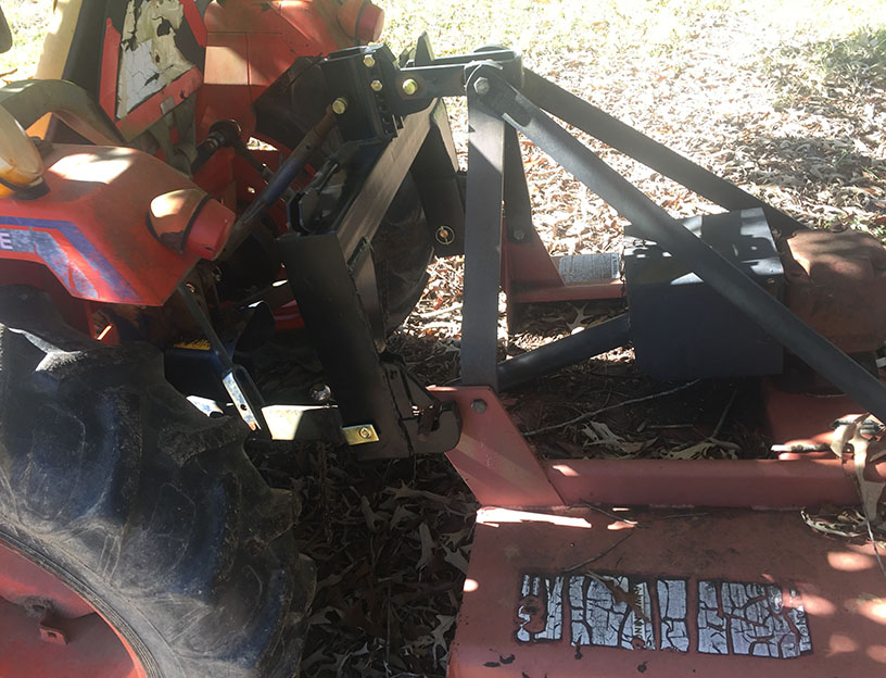

Still no luck on the finish mower. The adapter for the top link was longer than the one that was on the mower. Just for testing purpose I swapped them out. It will hook up but because the top hook is lower, when I raise the 3pt it just rolls out of the hook.
It will hook to the disk with no issue.
I still need to try my grader blade.
The shredder will work which surprised me as both it and finish mower are BushHog brand. I still have to get bushings for it and the other implements but here is a picture with it raised.
   / Purchased 3pt quick hitch. #50

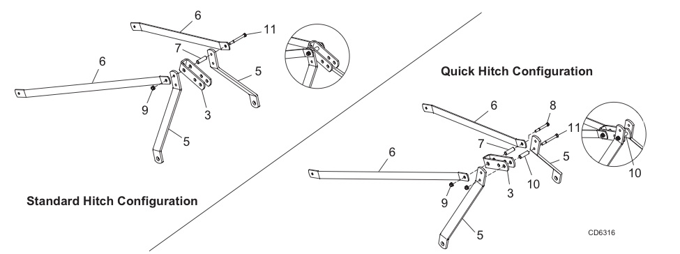

I don't see any flex in your arrangement.
Try this.
