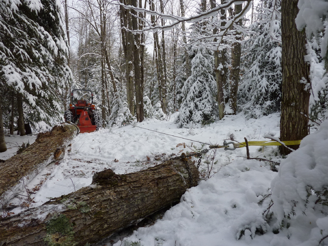

I use snatch blocks alot but I don't have any self releasing ones. Some days I get a little sick of walking back and forth to re-rig the cable and blocks as I winch in. You may never realize how much effort you are saving since you are starting out with self releasing blocks but in my book it was a smart move on your part.

Thanks for the photos, Gordon. I see you're using a pair of blocks on some of your pulls. I haven't used multiple blocks so far, but expect to for our upcoming project. Do you notice much friction loss with the extra pulleys or is it about the same as a direct pull?
   / Purchased a Uniforest 50E log winch for my Kubota L5030 #25
There must be some loss but it certainly is not noticeable.
Sometimes I just use a slider instead of a block if it is a shallow angle and short pull. Wrap a choker around a tree or stump and hook it into a slider on your cable. Its not good for the tree so it's best to pick one you will be cutting. In the picture with the hung fir tree I have a block in the skid road and a slider up near the tree. I just needed to pick up and pull the tree out from behind the stump then I dropped the slider.
