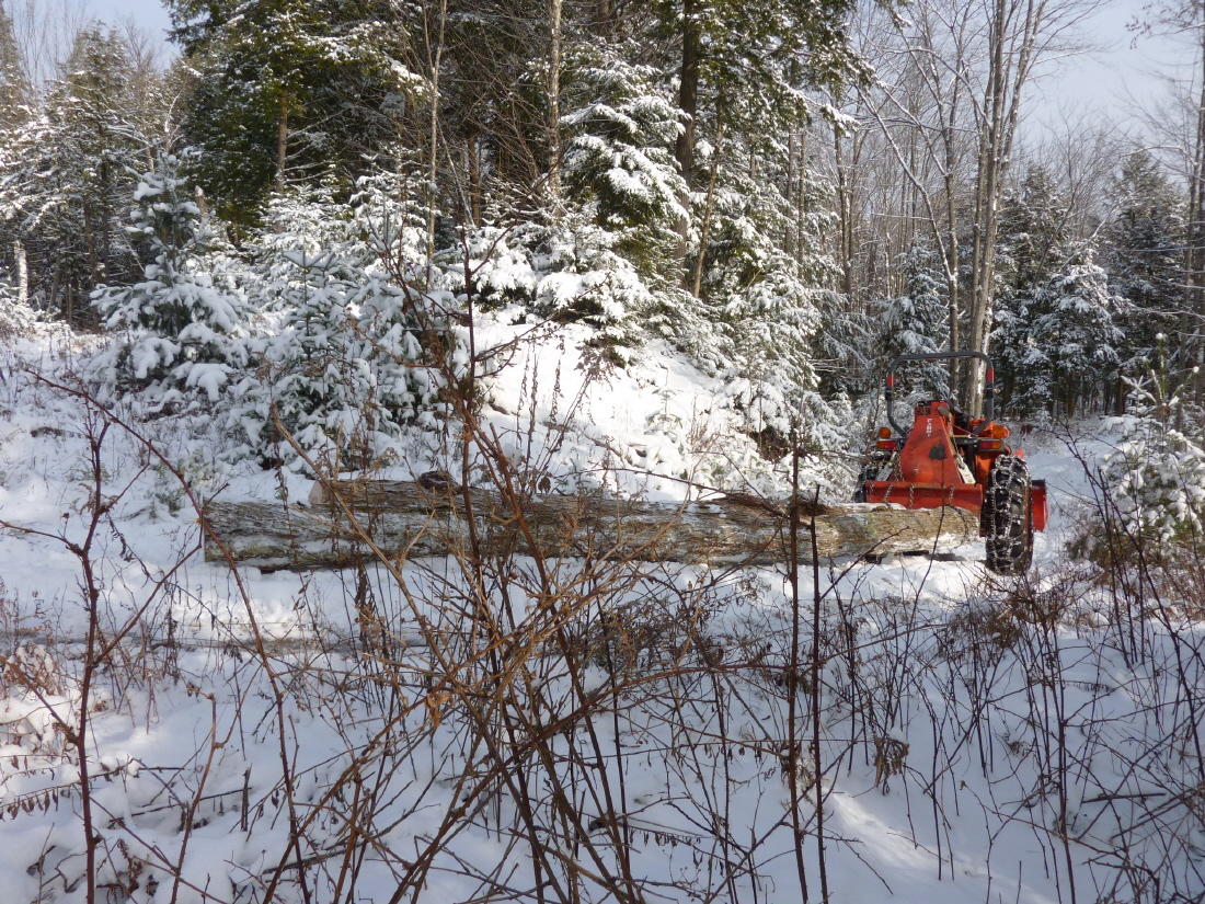

I would never run my pto/engine at 540/2700 rpm. I usually run at 1500 rpm with my 30 hp tractor. Never over 1800. Things happen to fast and you just dont need to. I have winched in a lot of logs and high rpms has never helped. As DeadHorse says - Look at your torque curve. Controling speed by slipping the clutch does not make sense to me. You just wear out the clutch. But everyone has there own ways.
If you are just learning please go slow for your safety's sake.

The clutch doesn't slip much - only when I need to slow it down briefly. That is usually only at the end when they get close to the winch. Otherwise, it is full speed pulling. The only way you have to control the log speed is the winch clutch. You can't sit there and throttle the tractor up and down while running the winch. And the clutch is 30 yrs old, original, and appears to have about 95% of it's life left. I'm not real worried about wearing it out...
Watch the tractor/winch, not the log and you can react as needed. Starting slow is solid advice when new. I did too. And when it wouldn't move logs or lugged the engine, I turned it up. I have never seen a published torque curve for Kubota engines, but I am sure they are out there somewhere.
Like you said, Gordon, whatever you prefer and works for you. Start slow, learn how it works, then figure out how it runs best for you.
Cool pic!
