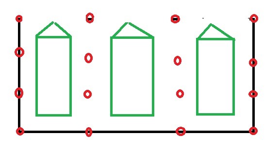

I know you are just poking fun but really I don't think they will be in the way?
Attached is an aerial view. Green will be the trailers, black is the sheeted sidewalls, and red is posts. Again sorry for my awesome paint skills.
Should be ok if you're careful. Just worried that if you bump one. It might push the others to failure, and that'd be bad....

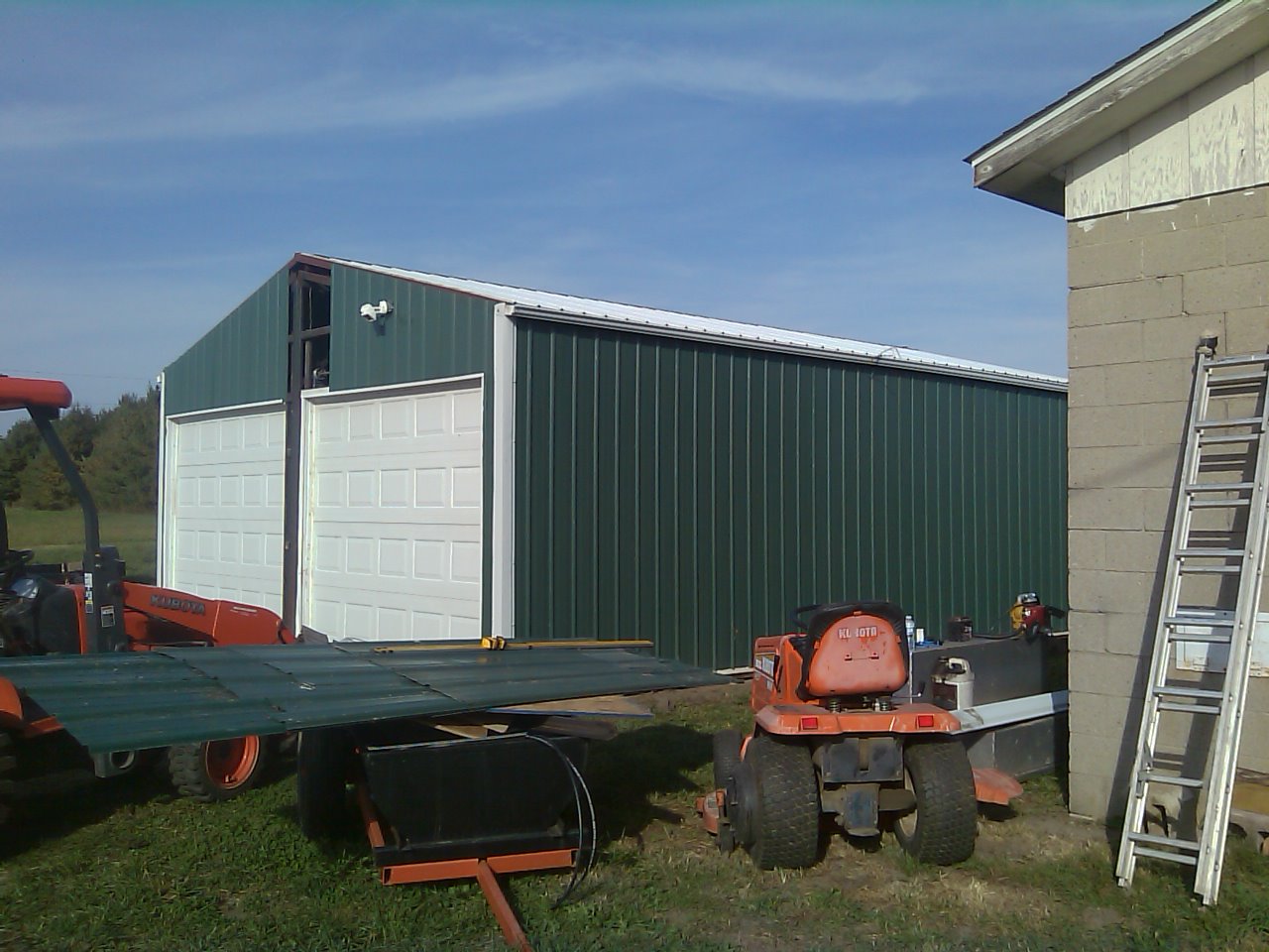

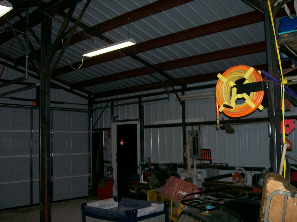

I did something along same lines I got a rail car full of metal cheap so I built a shed out of it. I think you will be fine with the posts in the middle and you may need to add a few extra braces. I used Z perlins and welded plates to attach them to the beams. You will have many people that don't understand why you built your way but it your happy with the set up build it.:thumbsup:
