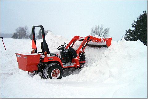

Those pictures should tell the tale on snow removal. Nothing like seeing the real thing!:D

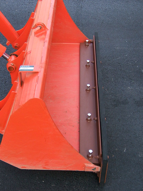

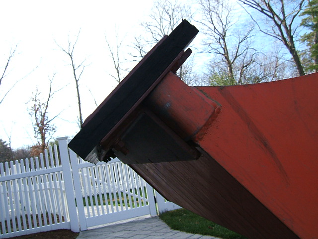

Here is my "slush pusher" - we haven't got too much snow in MA the past few years - so this works very well - bucket still fills, driveway protected, etc
Rev 2 will put an angle on it though...original design flaw :)
