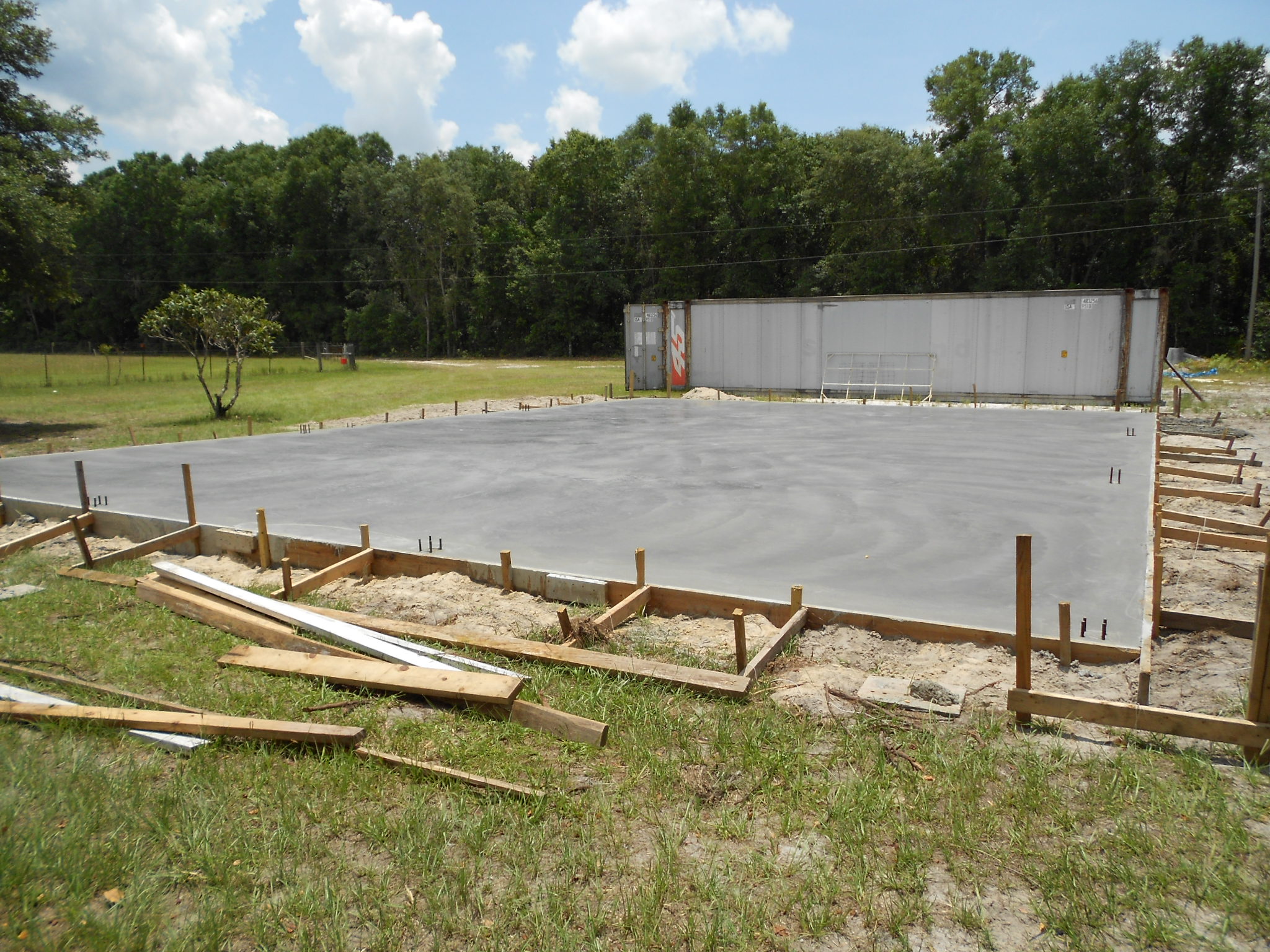

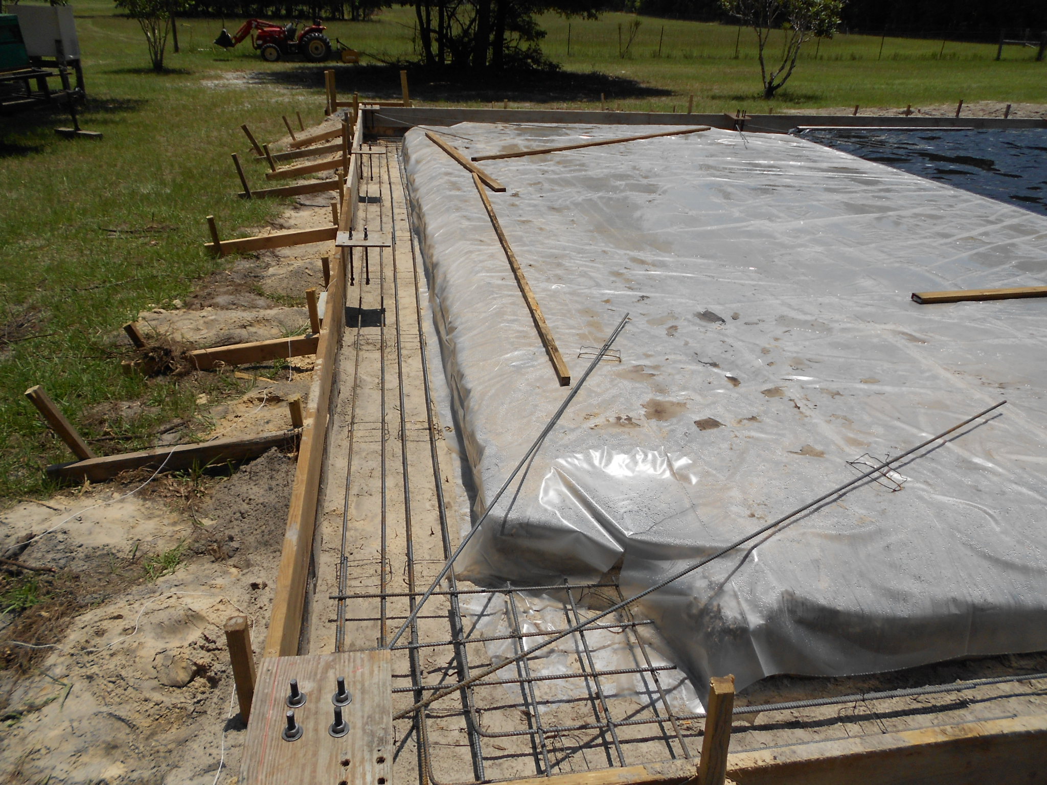

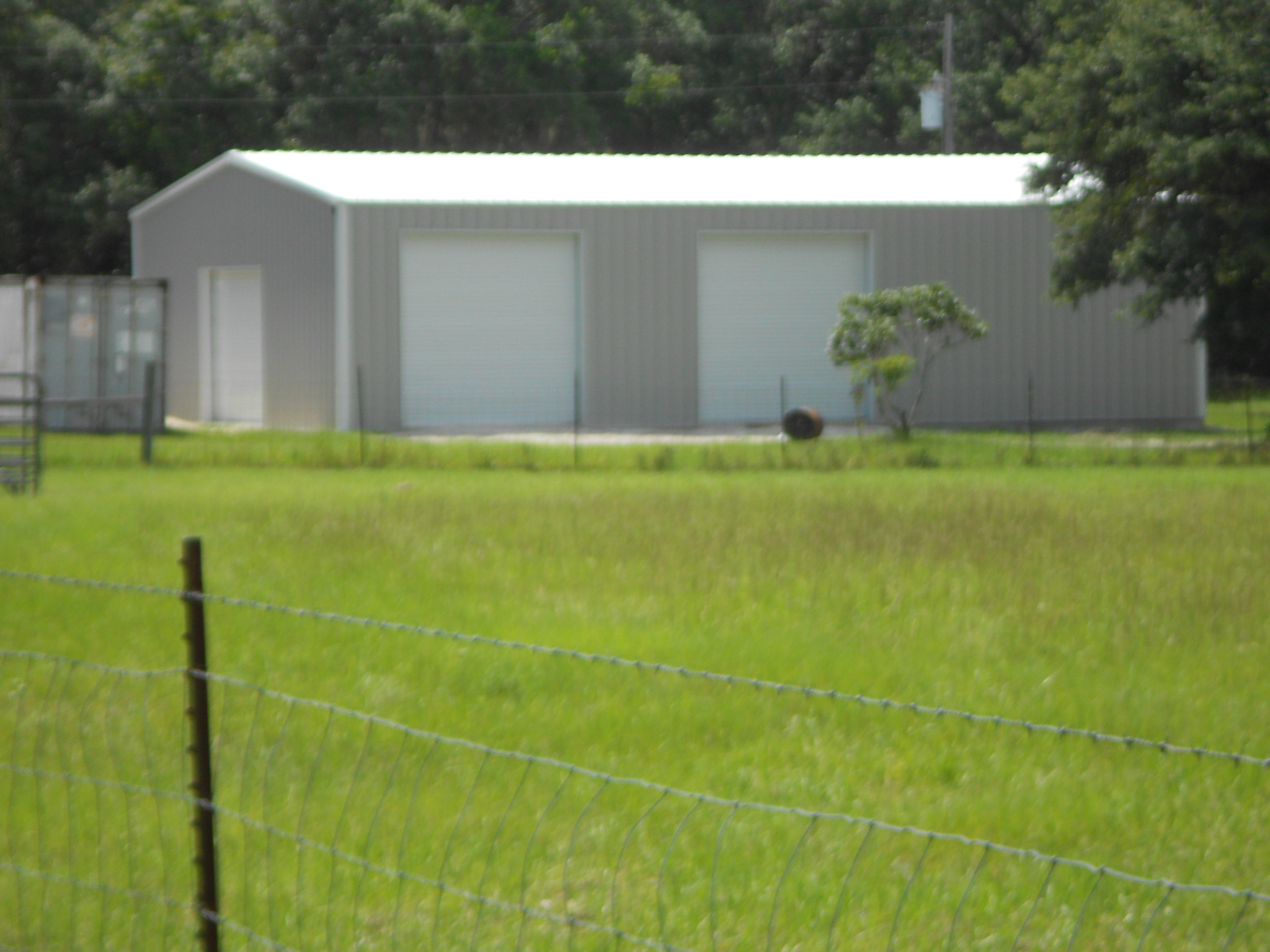

Pics are of slab and 40' X 60' X 14' building I had put up in May. Concrete guys were FIRST CLASS! Slab is perfect, I have done concrete work and have even driven the trucks.
Pic was taken before they added mesh placed on chairs then poured.

If your slab heaved over an inch , you have either a subgrade or drainage problem.

I'm not a fan of fiber. It's ok for what it does, but it does not replace rebar. When added to the mix and you are using rebar, it will help even more at reducing cracking, but nothing stops cracking. Concrete will get hard and it will crack. Nothing will stop this. Rebar holds the concrete in place so when it does crack, you don't notice it. For this to happen, rebar needs to be inside the concrete. Not on the ground, which is why chairs are used to keep it in the middle of the pour. Wire mesh does the same thing if it's kept in the middle, unfortunately 100% of the time that I've seen it, and in ever single picture that I've seen it done on here, it's laying on the ground and next to worthless. You cannot walk on mesh and pull it up into the middle of the pad, and walk on it some more and expect it to stay in the middle. Totally impossible to do this. Mesh should only be used on small pours when nobody walks on it like sidewalks.
