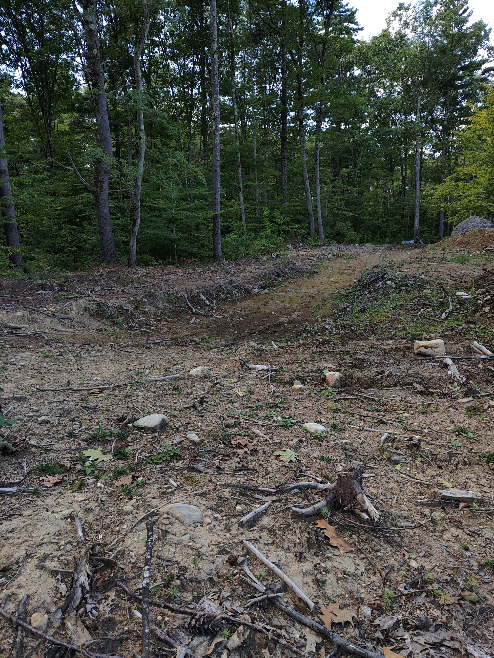

That "dip" looks like it is a very wet spot, looks like mud n slit in the bottom. Without some ditching and contouring for drainage and a culvert it will keep your driveway mushy in that spot as the water will wick up through the soil and fill.
If you want a 12 ft driving surface I wouldn't be surprised to see the base being well over 24 ft wide.

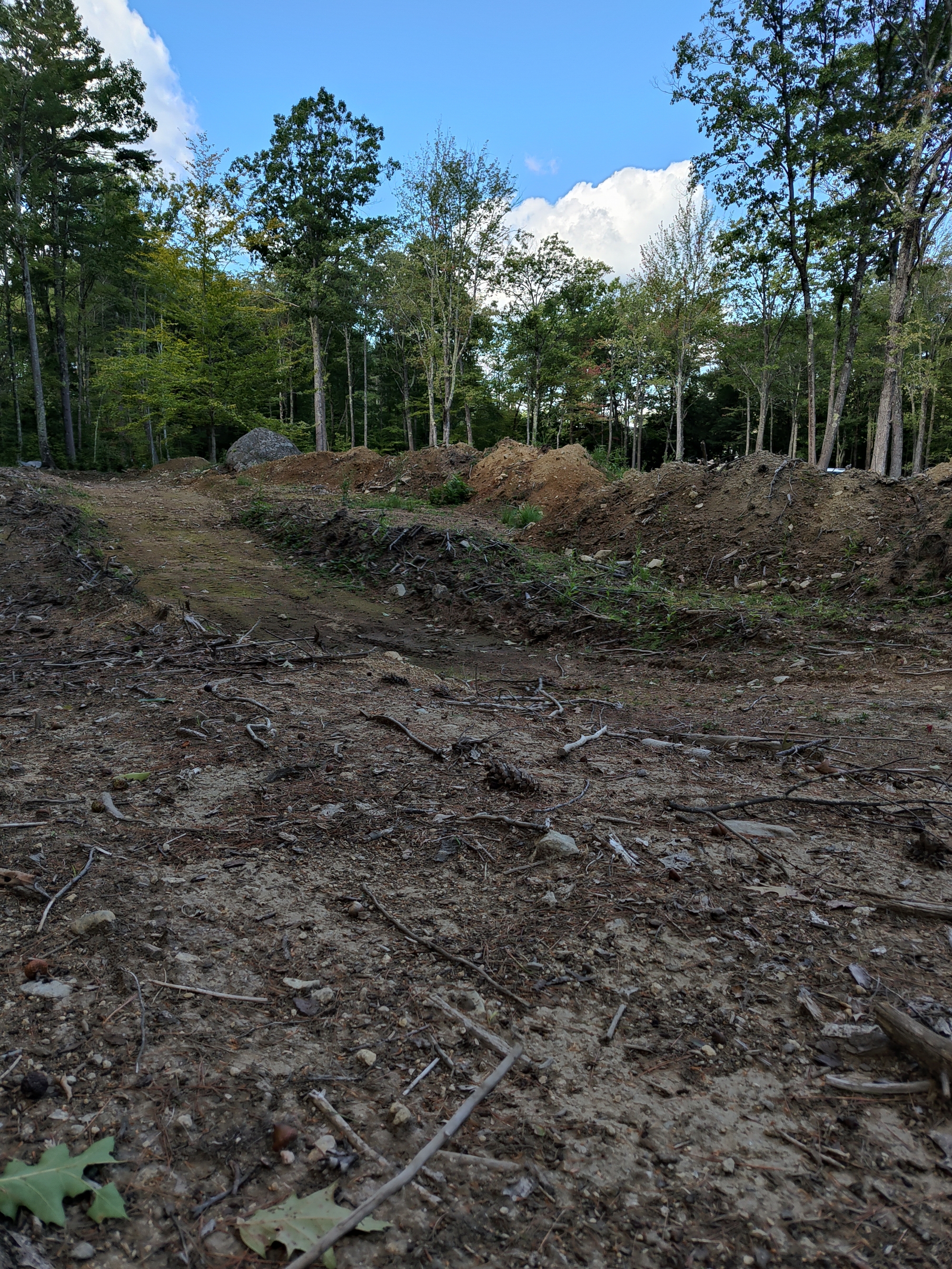

I would agree the dip looks wet . It's a thin layer from runoff. Just under that bit of mud is non-organic material. I stripped it down that far which is why there is even that large of a dip. Here are some other images I just took today. Now that I looked at it again I am thinking it might need a culvert at a pitch from left to right since the land to the right continues downward towards the back of the property where we are diverting water anyways. Either that or I need to build up both left and right sides to make the water drain away from the driveway.
   / Putting in a gravel driveway #40
A culvert and ditching would assure good drainage. A wide ditch or swale would be easy to maintain.
I would put in at least a 16" culvert, not because of flow but because it will silt up and fill up some over the years and the larger culvert will go longer between cleanings and is actually usually a bit easier to clean out.
Also the double wall culverts with the smooth insides are much better then the single wall corrugated things.
