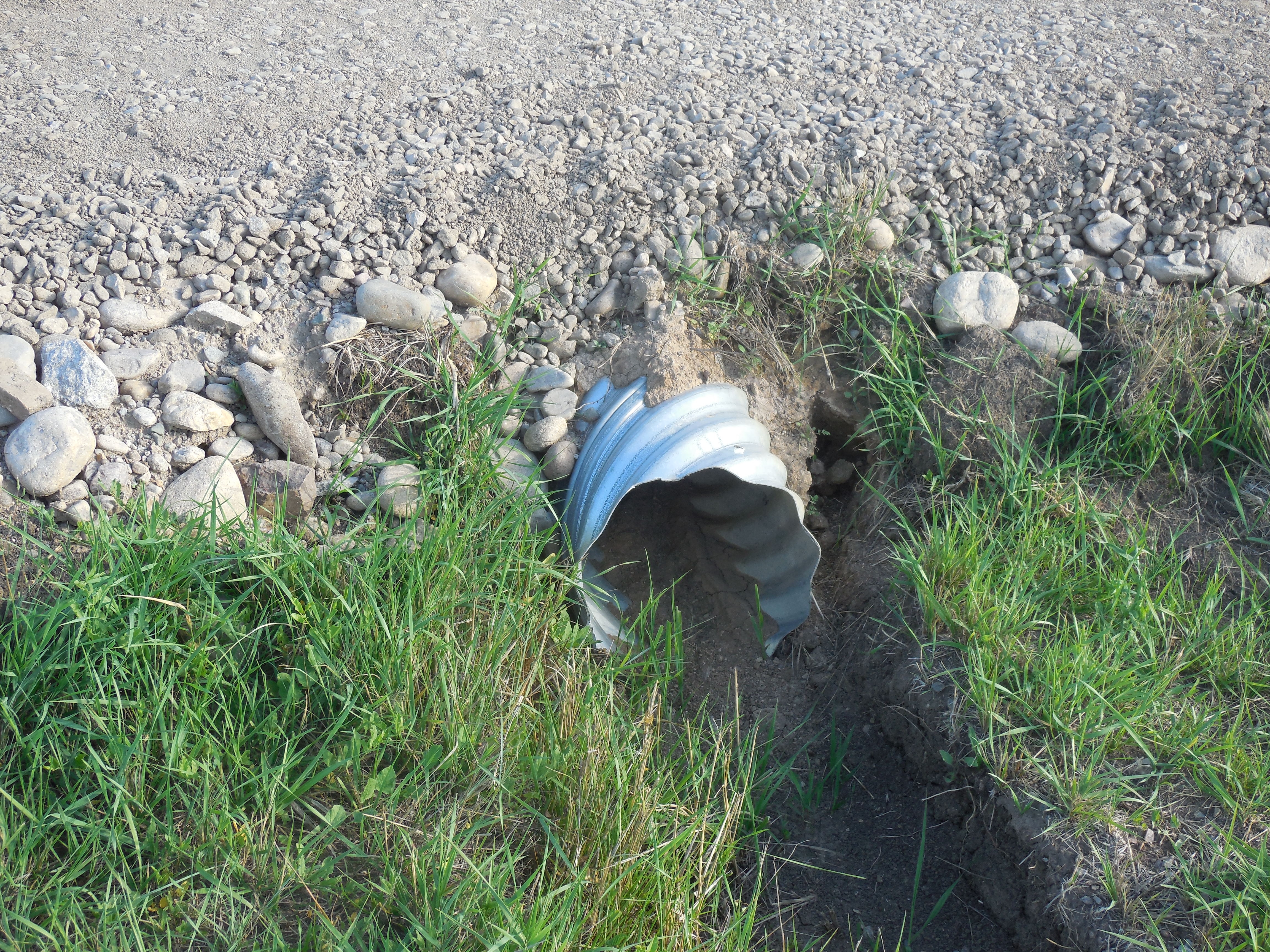

Uh, oh. That sounds like the little 12" culvert I just lengthened won't make it.
Well, I'm not worried. With a few culverts like that, all of which have survived so far, it might live.
After all, the 24" one that has supported dozens of fully loaded end dumps and other machinery over the years is alive and well, with about the same amount of fill above it.
   / Putting in a gravel driveway #50
Uh, oh. That sounds like the little 12" culvert I just lengthened won't make it.View attachment 980854
Not saying less coverage will immediately crush, but 12" of coverage is generally spec'd by any public works/road department, and is a good guideline. Our OP has the ability to get the coverage, and frankly it helps his dip problem, so coverage is his friend.
