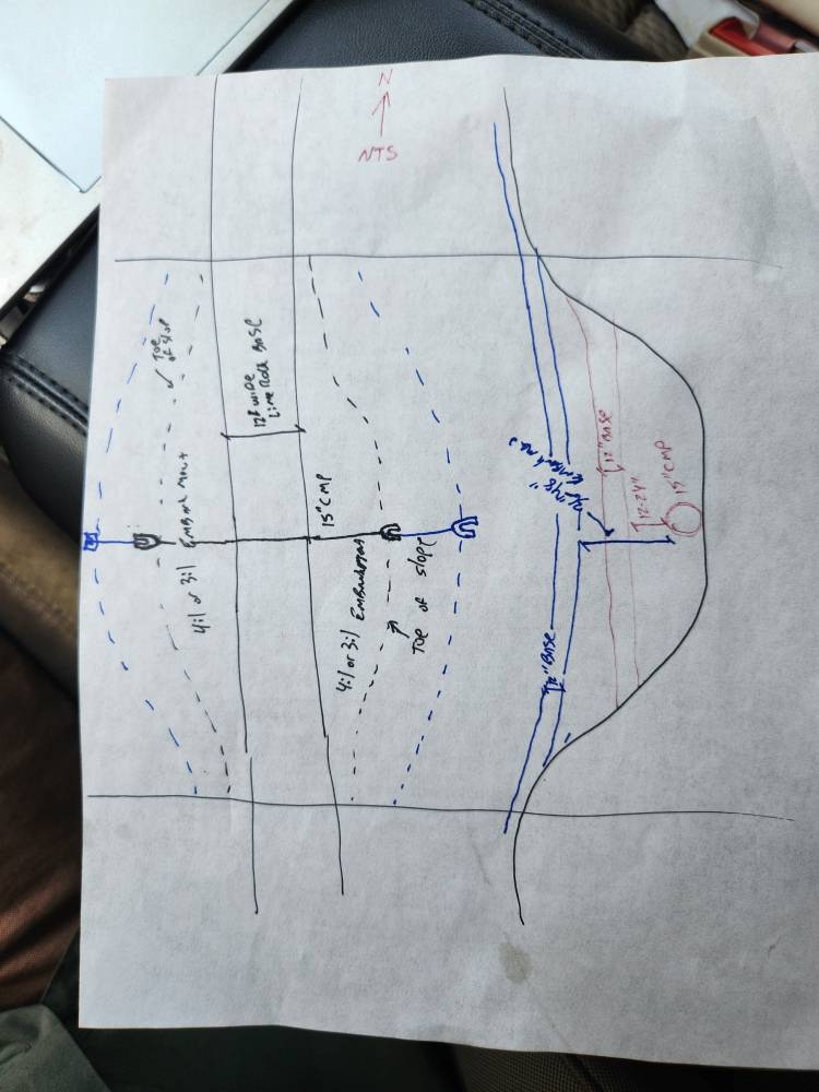

The ground does slope from the high end of the driveway to the low end naturally and all the way to the back of the property. That is still the case unless we back fill some of that area which we might. Even backfilled there should still be a slope.
One of my thoughts, that wouldn't involve a culvert is to build up the high side until it is level with the rest of that side of the driveway. Then the entire driveway is level. Then handle water management either by pitching the entire driveway so the water sheets off to the low side. I was also thinking that if I went with a crown I could bury perforated pipe, wrapped in fabric, to both sides and move water that way. I've not seen it done that way before but it was a thought similar to what you would do along the foundation of a home.
I don't like perf pipe, it gets clogged, and had a way of moving when placing material and back filling.
   / Putting in a gravel driveway #63
I would think that is too low though. If the bottom of that dip is 7' lower than level with the rest of the driveway, and I already have material to either side, I would think I'd need to be at least a couple feet higher wouldn't I to keep the culvert fro being buried? Or maybe you are thinking I need to remove material on both sides to create a path for the water?
See right below, LouNY is 100% right.
I took the liberty of drawing the world's most primitive Plan and Profile sheet. So, assuming we don't want gravity walls/retaining walls; the red lines on the cross section are a mild fill and mild dip, with the plan sheet slope shown in black, as with the pipe show in black on the plan sheet.
If we want to remove the entire dip, see the blue lines on both the plan sheet, as well as the matched profile/cross section.
   / Putting in a gravel driveway #64
As I hope I showed, by adding the additional fill; we have by default lengthen the needed pipe.
12 ft roadway; 15" pipe, and 12" fill and 12" rock; we need a pipe; we need 38 LF of pipe. (at 4:1)
12 ft roadway; 15" pipe; 24" fill; 12" rock; we need 46 LF of pipe (at 4:1)
If we have 15" pipe; 48" of back fill; and 12" of rock; we have a total rise of 6'3" and that means each end of the pipe needs to account for an additional 25LF of pipe (keeping a 4:1 slope) or 19 LF if using 3:1. For a total length, of 62 LF using 4:1 or a 50 LF if using a 3:1 slope.

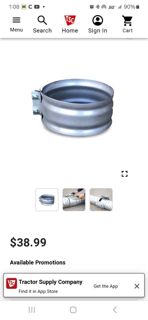

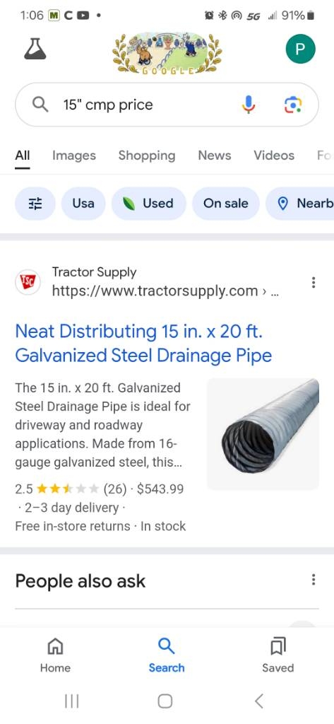

A 60 LF 15" CMP is going to come as 2 sections, so you also need a coupling band, and I'm guessing band, and 60 LF, we are probably over $2500 for a pipe that long.
   / Putting in a gravel driveway #66
So, looks like 15" CMP is around $550/20 LF, and coupling bands are at $40/each.
Kinda all boils down to $$$.
