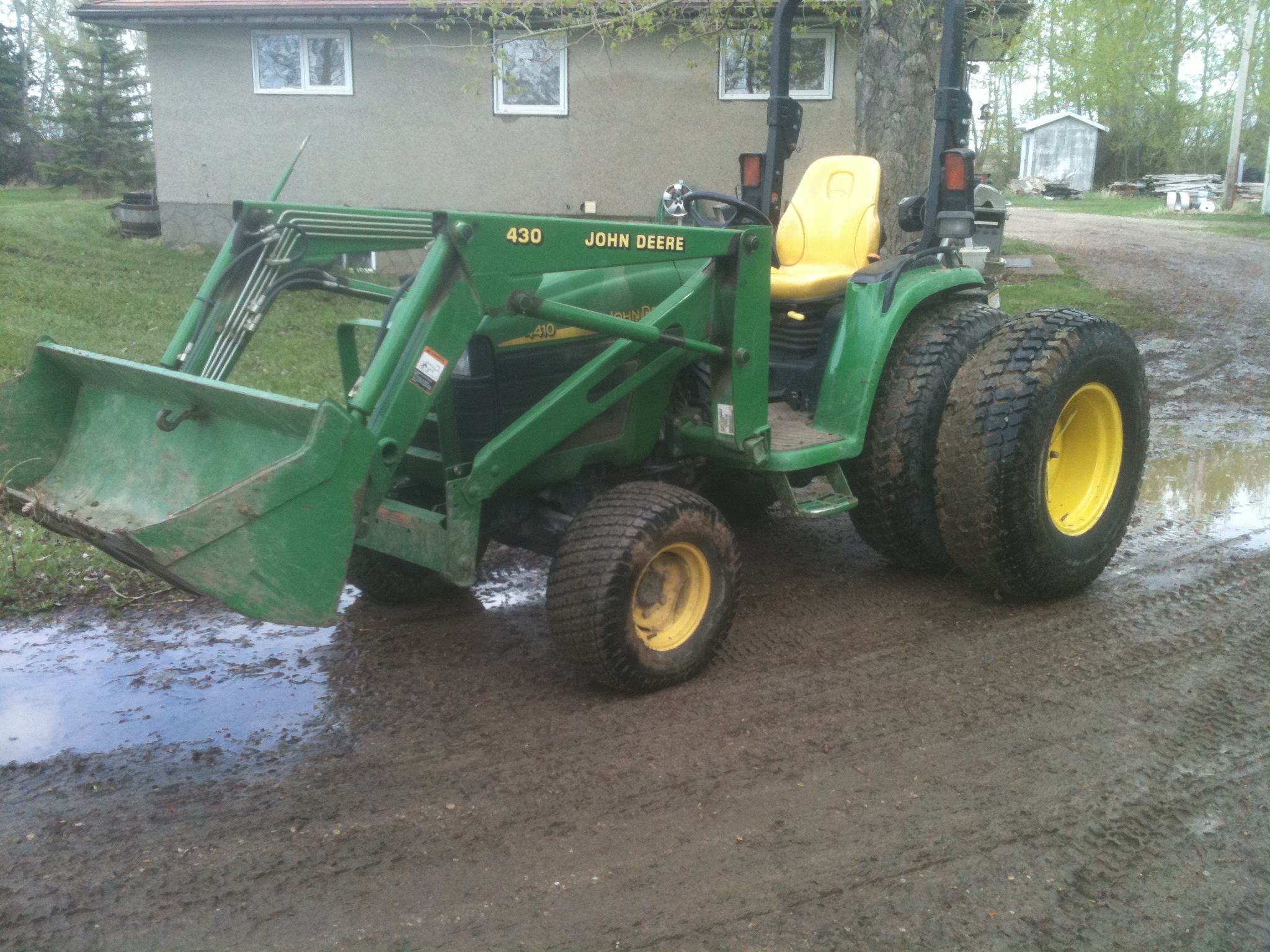

About 30 years ago I bought a 1963* Wheelhorse garden tractor. 7 HP Kohler and a 36" mower deck. Used it to mow the lawn at my business.
But then we bought an adjoining 10 acres and did a high-grade logging job (which paid for the property). I brought the Wheelhorse home and built a trailer that held 1/4 cord to get out the tops and do some thinning.
It had R1s on it, but that wasn't enough - I was really taxing it hauling 1/4 cord of green firewood...
Somehow I happened to find a matched pair of mounted tires, got some threaded rod, welded some spacers onto the bead area of the rim and bolted them together. Still got stuck a few times, but it was almost like turning it into a MFWD!

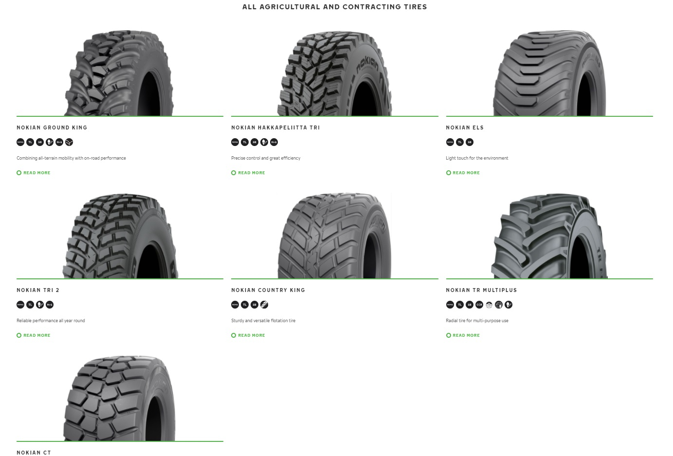

Nokian does have some pretty cool looking tire options. Wonder how difficult and expensive it is to obtain these in the US.
