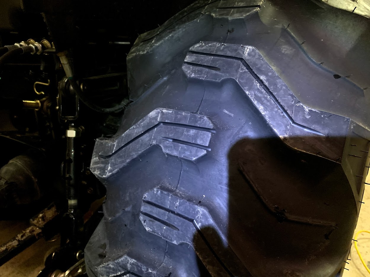

I've got a word or two for you with R4 and snow traction problems? Groove your tires, it will improve snow traction 200%. I bought an Ideal heated groove knife from Amazon.
