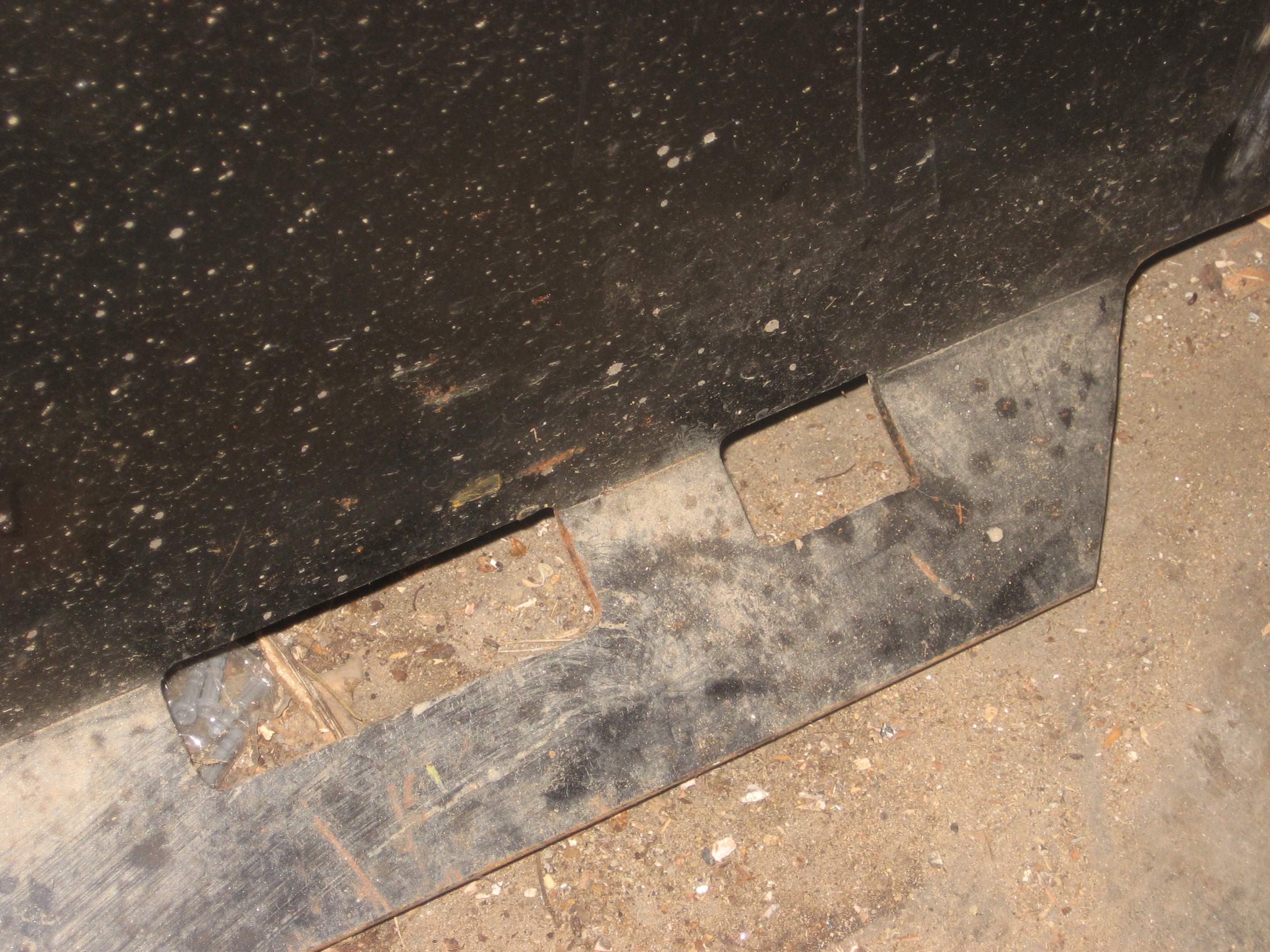

I was wondering if anyone has seem or has any ideas on some sort of adapter that would go in the plate like a wedge. and would increase the buckets rollback?This would increase the bucket capacity and also less spill over. i know it would cause problems when its up high but for moving material Id think it would be a good things to have.
Im thinking of some metal that would extend out the lower ''slot'to do this. but would be concerned as it would add pressure to the pin and also not distribute it over the whole paddle plate.

After looking at a backing plate this morning I was imagining maybe on the lower part some small tubing to create the angle .(more).so Im hoping all I need do is weld on some metal to catch the pins.I think even 2 inches or so of 'shim' would give the desired effect.
Good point on the breakout force..
My ideas is to be easier to move hauled in soils so I don't see that as a problem. Also I know when dumping it would not dumb quite as much at full lift.
One concern is that the pressures would be on the top of the QA plate and also on the lower part and nothing in-between.
For my application i don't think tha'ts a problem.

hmm That wouldnt work. Im trying to increase the rollback on the bucket at a lower level. So the dirt would not spill. So id need shorter cylinders. And this would only be with the dirt bucket. any cylinder change would effect all the other attachments. But would benefit the forks as I dont like how they dont roll back much.
Basicaaly Im imagining the lower bracket with two slots .one would be standard and the other would be further out. So I could choose which one. But then the pressure would be on the pins and not on the face.(not good)

Maybe you could add a removable steel wedge to transfer the load from the bucket to the two ssqa faceplates on the loader arms. On my kioti ck the ssqa plate is about 5" wide bottom 8" wide top. You will have to make sure you have good engagement between the top of ssqa and bucket, so it wont lift off the top lip. Especially when dumping. Also, if you get lazy and don't remove the wedge during ground engagement activity, and I have not thought this through , you may stress the loader arm linkages differently since the ssqa will actually be dumped some to get the bucket level.
I love the idea and it would be great to have the bucket curled more with the arms down to maximize bucket volume when traveling.

I'd asked the same question in the Kubota forum regarding my 504 loader with pin-on QA. I'm going to end up making a new QA plate with more angle to it. Right now, I've got about 4" offset in both pins but there's room at can shorten the top offset by about an inch gaining 10-15 deg on the rollback but loosing it on the dump.

Instead of adding on the plate side, what about adding on the pin side? If your loader boom allows, extend the frame side brackets to add an additional lower pin hole 'behind' the existing one? This would in turn rotate the bucket around the upper pin giving you more rollback. If the boom design allows it to slide into the new deeper brackets, you could then pick between the holes by moving the lower pins depending on if you want max curl force or max rollback

How about cutting the sides in a ">", to the angle you want,
then lift the bottom bucket plate up and weld it back.
This will reduce your bucket load but it will give you the slope angle your looking for.

I just calculated the angles on my bucket & QA. With rebuild or modification of my QA, I can gain an easy 10 deg of roll back which is significant compared to the existing 23 deg. BUT, to get the bucket to roll back to flat top edge at carry height like the big self-leveling loaders, I need 40 deg improvement. I only have 37 deg of dump angle to start with so that ain't going to happen.

I'm thinking out loud here but I think its more in the design of the curl cylinder where it meets the bucket. Larger tractors have a scissor type mechanism which I think keeps the cylinder away from the loader arm at further extensions and gives more of a curl/dump angle. Its just something I noted when we got a larger tractor and have seen it on most larger tractors above the 35 hp range.
Still, without redesigning everything a bigger bucket will do the same thing, with less spillage in the end. That is if your tractor can get a heaping bucket with the current one.
/ QA Loader roll back angle adapter?? #18
You are exactly right. It's a function of the non-linkage design of the smaller loaders.
Sort of. You'd need either a longer bottom or wider overall. Wider can be a problem once you get much wider than the tractor. Longer bottom is the key but you sacrifice roll force to get it. On loose material, certainly the easiest option.

Can't carry a full bucket unless you raise it 4' off the ground to make the sides level. So much material spills off the front due to lack of rollback
