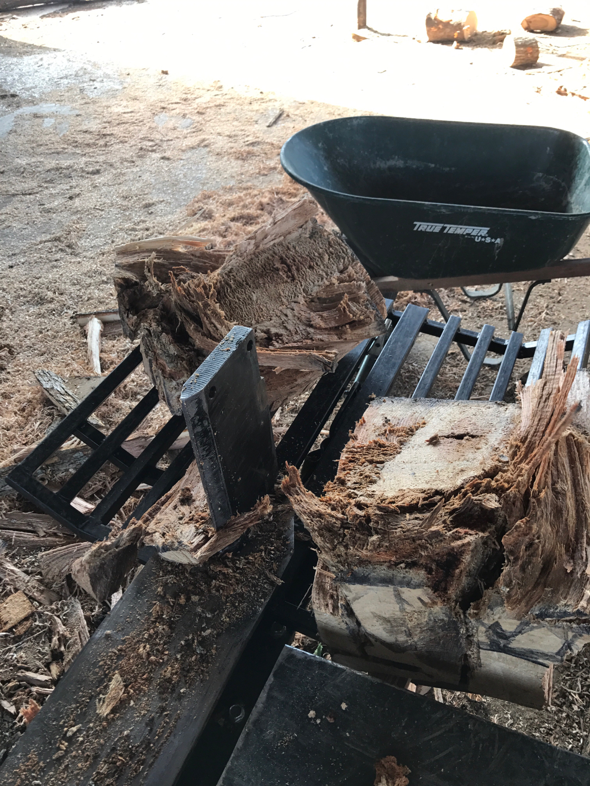

Anybody ever use one of these? Small logs.....good price???? Any feedback?
Log Splitter K1 Electric | DR Power Equipment
