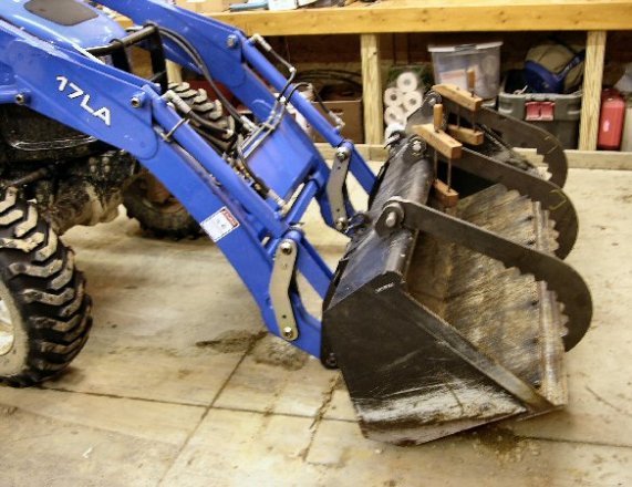

Thanks PineRidge. I did get in touch with Andy by the email link you sent to me. I'm getting a check in the mail to him this morning. He suggested I attach a 3"x3" x 1/4" piece of tubing to my rock bucket to mount the grapple. I'm not certain, but I think both the beam and the grapple can be mounted to the rock bucket with U-bolts.
I'll also need to make measurements and order hoses since I don't intend to build a diverter valve system right away. I'll put short quick-attach hoses on the grapple and run my hoses from my third remote up to the loader crossbeam and mount them there.

I'm not sure if the grapple will reach all the way to the end of the bucket, but I'm going to mount a beam inside the bucket at the top of the rear tines. I think the grapple jaws will come close to the end of the front tines by 2" or so. When I receive the grapple, I'll start a post and show some mounting pictures. I'll PM you so you'll know I've posted some pictures.

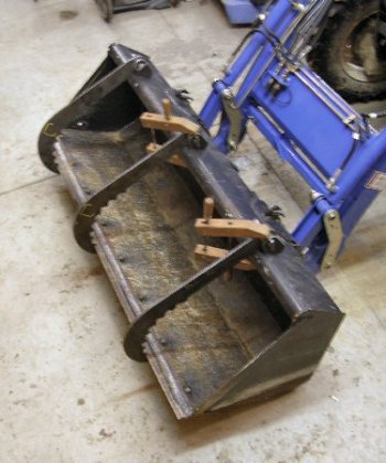

Guys these lift arms for the grapple are 27-1/2 inches from the center of the pivot pin to the tip of the arm. Hope that measurement helps you. And like Jim says there is also some adjustment that can be achieved by moving the position of the mounting point in relationship to the bucket itself.

</font><font color="blue" class="small">( He already spotted a problem with the way that I want to mount the cylinder even before the welding started. It seems that the rear cylinder mount if centered over the center lift arm pivot, will make removal of the center pivot pin impossible )</font>
I'm not quite following the problem. Are you saying the mounting ears the cylinder will be welded to the bucket o either side of the center grapple arm? So this would cover the path to slide the pin out of the grapple?
If so what about leaving a hole in the mounting ear? Or make another grapple arm and move its position. In other words you would have four arms instead of three. This would leave the center open for the cylinder mount.

Picture the center pivot pin installed and acting as the hinge for the lift arm. Now picture a rear cylinder mount with each side support plate also welded to the support tube right next to the original pivot pin and you will see that there is no way to remove the pin once the cylinder mount has been welded up. /forums/images/graemlins/frown.gif

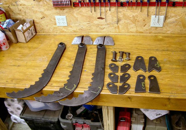

Andy took this into consideration before we started welding and redesigned the center pivot mount to be longer and with a second hole to facilitate the pin for the rear of the cylinder. He also had to make the bushing in the center lift arm longer than the other two a lift arms to compensate for the extra width.
And finally he saw an opportunity to make the connection of the center lift arm and the 2 X 2 tube stronger by making 2 X 2 cutouts in the center arm for both tubes to pass through instead of a butt-joint. We should see the redesigned parts arrive here shortly. /forums/images/graemlins/cool.gif
/ Question about a grapple #49
Someone did a nice job cutting out your parts. Two things about the picture though. 1) Wouldn't now be a good time to consider adding bronze bushings to your pivot points? 2) How the heck do you find anything in that shop??

Didn't see any bronze bushings on our loader and it sees a lot more use than the grapple will so I'm thinking as long as we keep the pivot points greased we should be OK for the long run. My thoughts are that we're already over engineering this grapple without additional bells and whistles although your suggestion is well taken and does have merit.

Steel on steel will handle more pressure that bronze and will last longer if kept greased. I vote for steel.

merits to both methods. Now would be a heckuva lot easier time to install a bearing surface than after its assembled and welded, but to each their own! Is "overengineering" a cardinal sin, as long as you don't go over budget??
