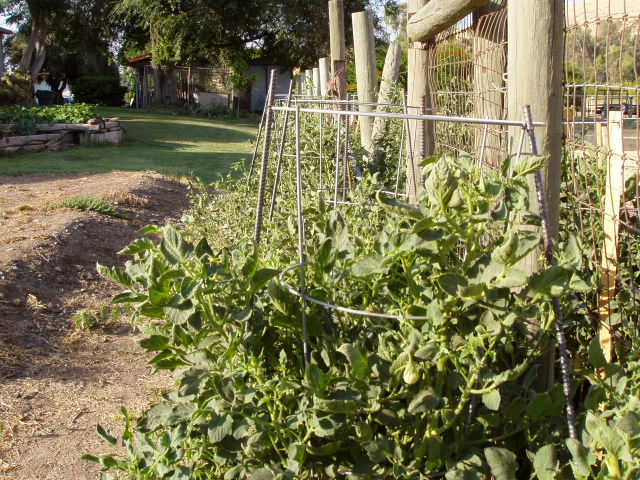

I use 3/8 rebar to tie tomatoes..After a couple years---what points?? they drive fine with 2 lb ball head hammer?.
/ Question about grinding rebar #9
I also use three 3/8" sticks of rebar per tomato cage for extra support. No points necessary. The only time I have put points on 3/8"x12" rebar was to spike them through pre drilled fence end posts and into the horizontal "H" brace post.
