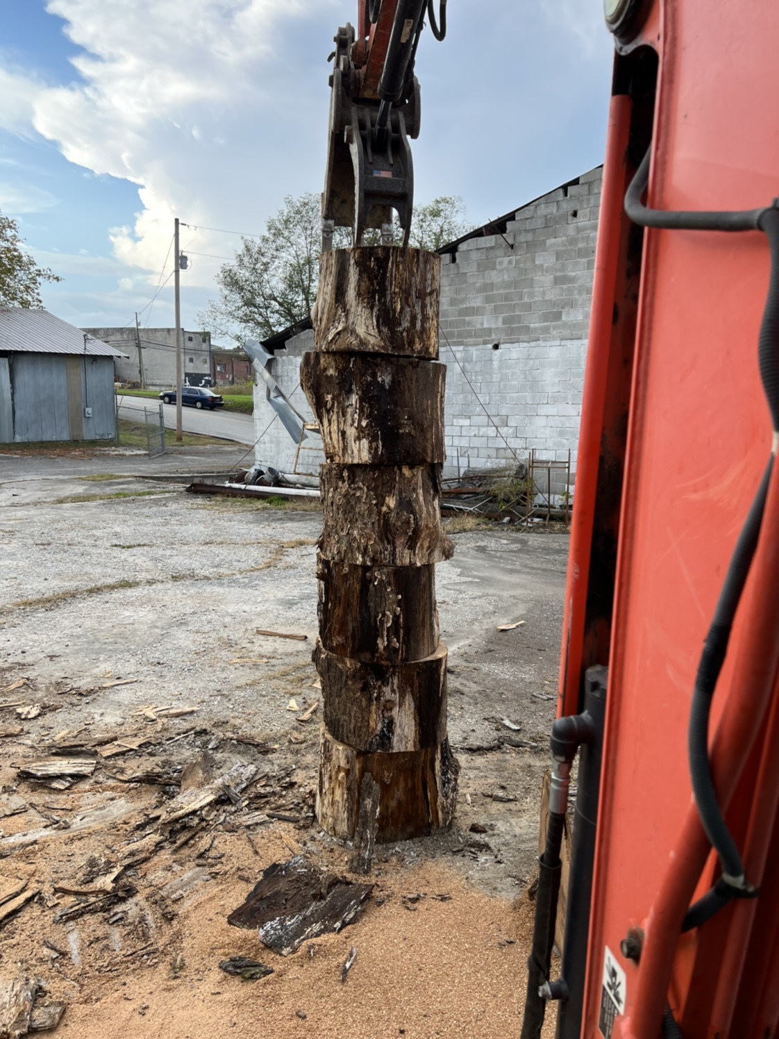

I think if you ran an excavator with joystick controls for an hour you’d quickly become disappointed with the M59 hydraulic. It wasn’t so much the precision of the backhoe that was in question as much as operator comfort and the speed of the hydraulics. I could take at least 2 scoops probably 3 on my excavator to every one the M59 will do. And the M59 front loader was less disappointing than the backhoe but the cable drive loader control wasn’t as good as it could have been. I know a backhoe will never equal a skid loader and mini x no matter how good it is but Kubota left room for improvement on that so called industrial machine. That’s an excellent tool when compared to a tractor backhoe, and I would still recommend that to any homeowner but for construction use it’s lacking.
You may be right. In fact I'm sure you are for most. It's that lots of scoops/min. and fast operation don't count in my work. If precise means it takes longer to do it that's just fine. Fast might count for more if I used the backhoe for digging, but I rarely use it for digging anyway.
It's local landscaping. And around here, landscaping means placing rocks.
What I like with the M59 is that it doesn't have any slop in the pivots or flex in the system. It's stable & doesn't rock back and forth like an ex does, and has controls sensitive to small movements. I can pick up a multi-hundred pound rock, place it right where I want it, confidently position one tooth against the edge, and use all that power to smoothly and slowly slide it a few inches to the side until it drops into place.
The industrial machines I've used are more set up for large faster movements - where they shine as you say. But they don't seem to do as well slowly easing the bucket a one inch under full power at full extension.
What I do like about min ex is the full rotation and the nice cab. When things settle down and it isn't a seller's market I'll be looking into them more seriously.
Probably look first to see what Cat has to offer. What do you think of their machines?

My mini x is very precise if you want it to be. It’s every bit as precise if not a little better than the M59. Using the blade for a stabilizer mostly eliminates the rocking problem. I’ve never ran a Cat mini. The price was enough to decide for me. I’ve been very happy with my Kubota mini and I wouldn’t hesitate at all to buy a Deere mini either.
