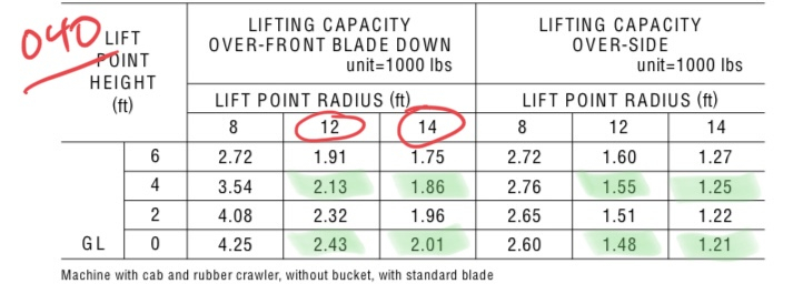

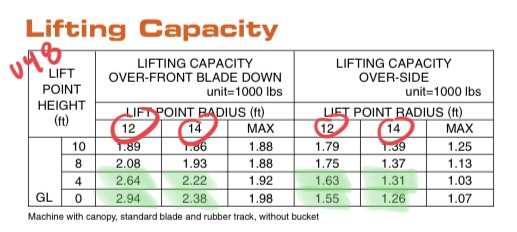

I made it simple for you. U48 out performs kx040 on lifting in every comparable measurements, charts are not equal, you have to pay attention. As I said earlier, I read on some press release that the up close craning is like 5200lb for the u48, compared to the 4200 of the 040. The only place the kx040 outperforms the u48 is 6” in dig depth. The tracks are 1’ longer and wider so much mor stability. 32gpm flow through 3 pumps compared to 24gpm single pump on the 040. The u48 is more machine. Even a longer stick by a few inches. Down side is the angle difference of boom that changes dig depth because of the length of the undercarriage I assume, in which a grinder may fix.
View attachment 733348View attachment 733349
My mistake, I didn’t realize the 040 started at 8 ft radius and the U48 started at 12. Weird stat manipulation going on there.

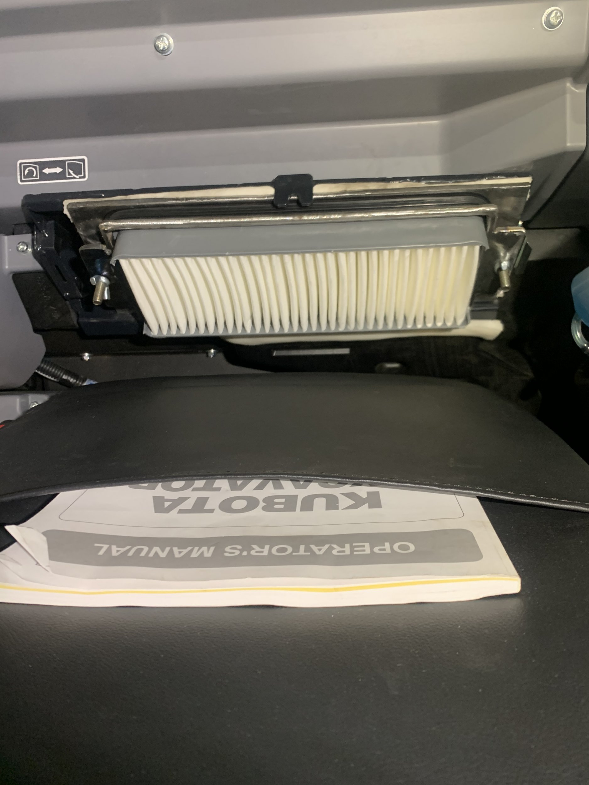

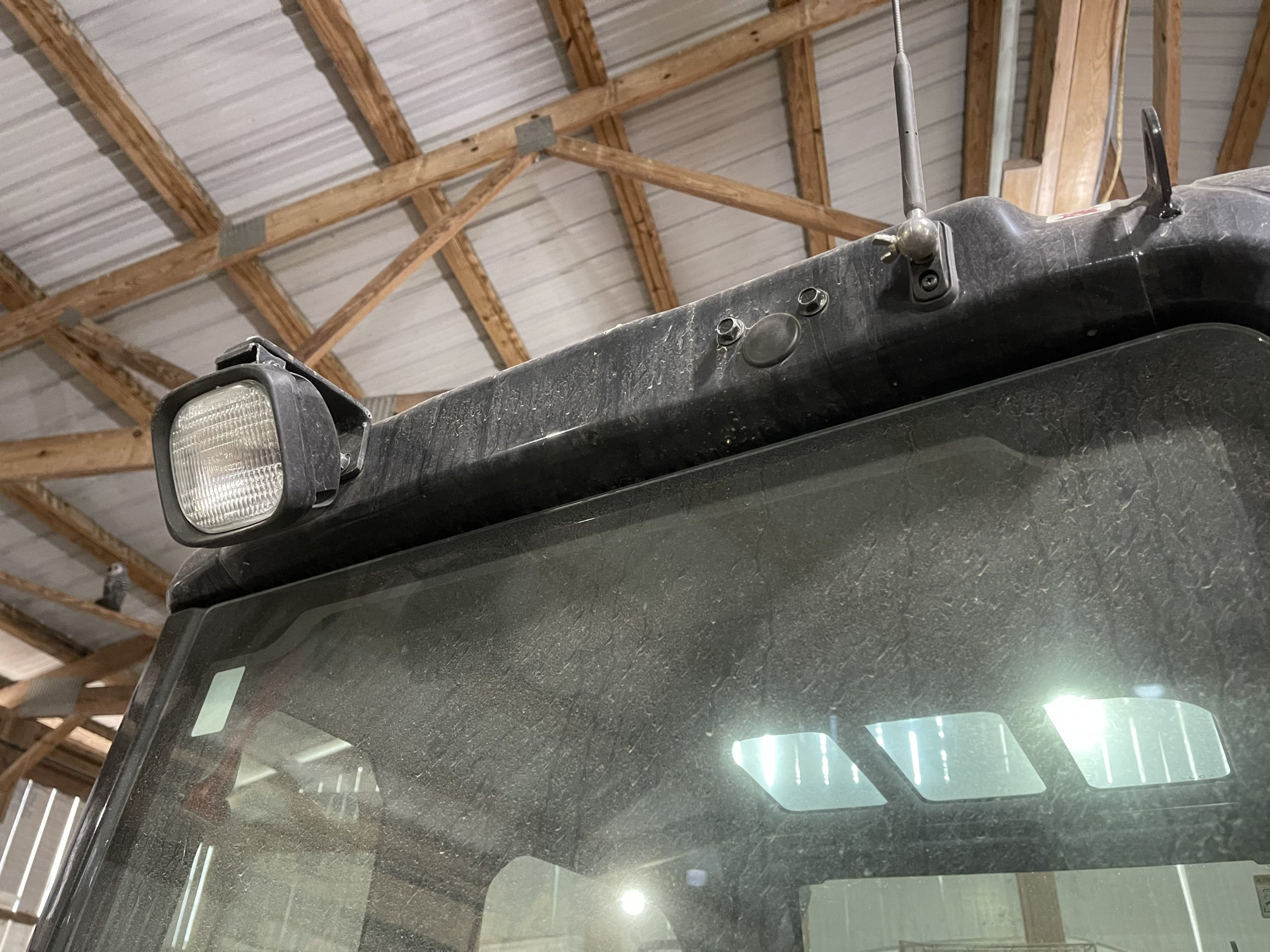

I didn't either At first. You have a kx040, did you know about the pre-wired light hookups on rear of cab? Incase you want a light back there. 2 rubber grommets. They pop out and there are wires with a rubber boot that pushes into hole. The one on left turns on with light switch, the one on right turns on with beacon switch. Just remove screws for speakers and you have easy access.
I also seal the hvac return and retrofitted a better filter. Kubota sucks with hvac filtration, one of the things they addressed.

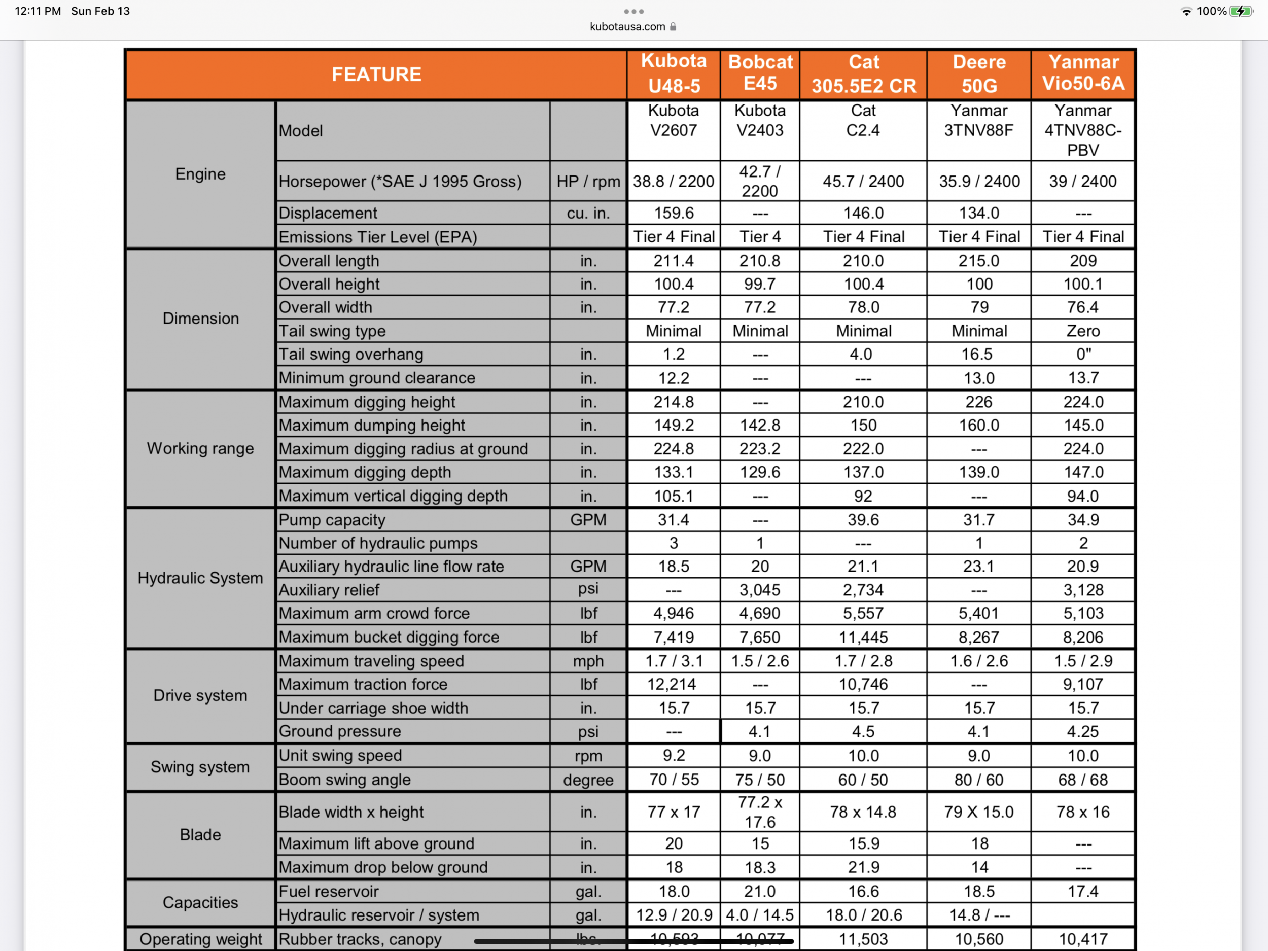

Herseyfarm, did you ever get a good explanation as to why the 040 has one pump and the U48 has 3? I don't know myself, but assume it is closed vs open hydraulic systems. Not much point in going past that point since they are all exaggerating.
Do you wonder how it is that both Kubota models and the Takeuchi get more HP out of the same Yanmar engine than that engine is capable of making?
In my experience designing equipment, the answer for the exaggerated hydraulic specs is the same as for the fluid HP and the lifting specs:
Those are ADVERTISING specs, not ENGINEERING specs. They are not meant to be taken literally.
As far as numbers go, the advertising specs are as good as beer and chips for for starting a conversation, but if you need real numbers, we have to first figure out where each one is cheating.
We can do that. It's just part of the game. Specsmanship.

A few more things I noticed. The u48 has the next size up in the bucket quick coupler. So you will need new buckets if you move up...but you would need those anyway if you move to a bigger machine.
Where did you see the U48-5 has 3 different pumps? I haven't run across that yet.

Yea, i knew that. I have 3 buckets and they are for sale with my machine. If I end up trading it in I’ll keep buckets and sell them separately.
if you go to kubotas page for the u48 and click on competitive comparison it list it as having 3 pumps. Here is a screen shot.

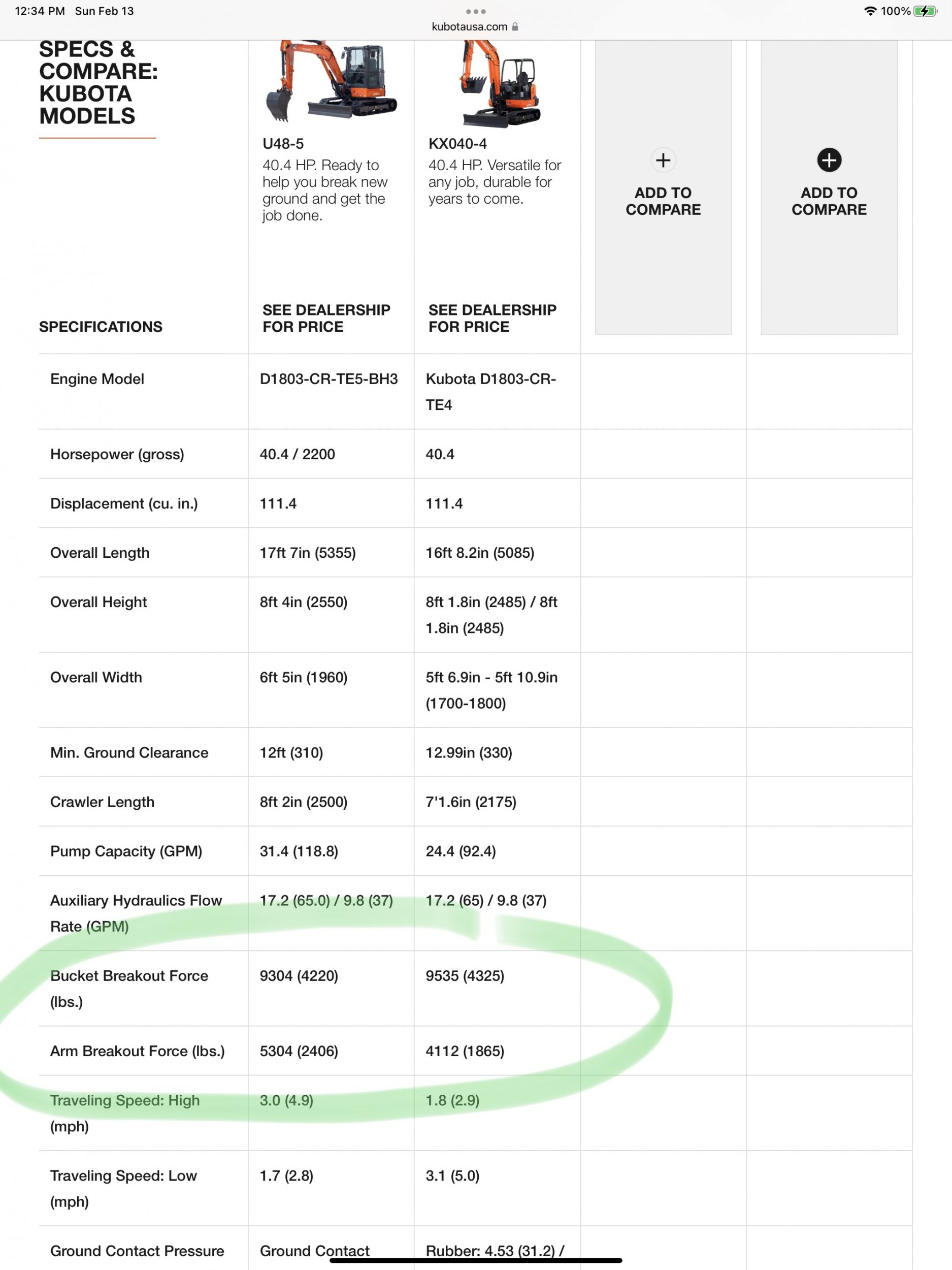

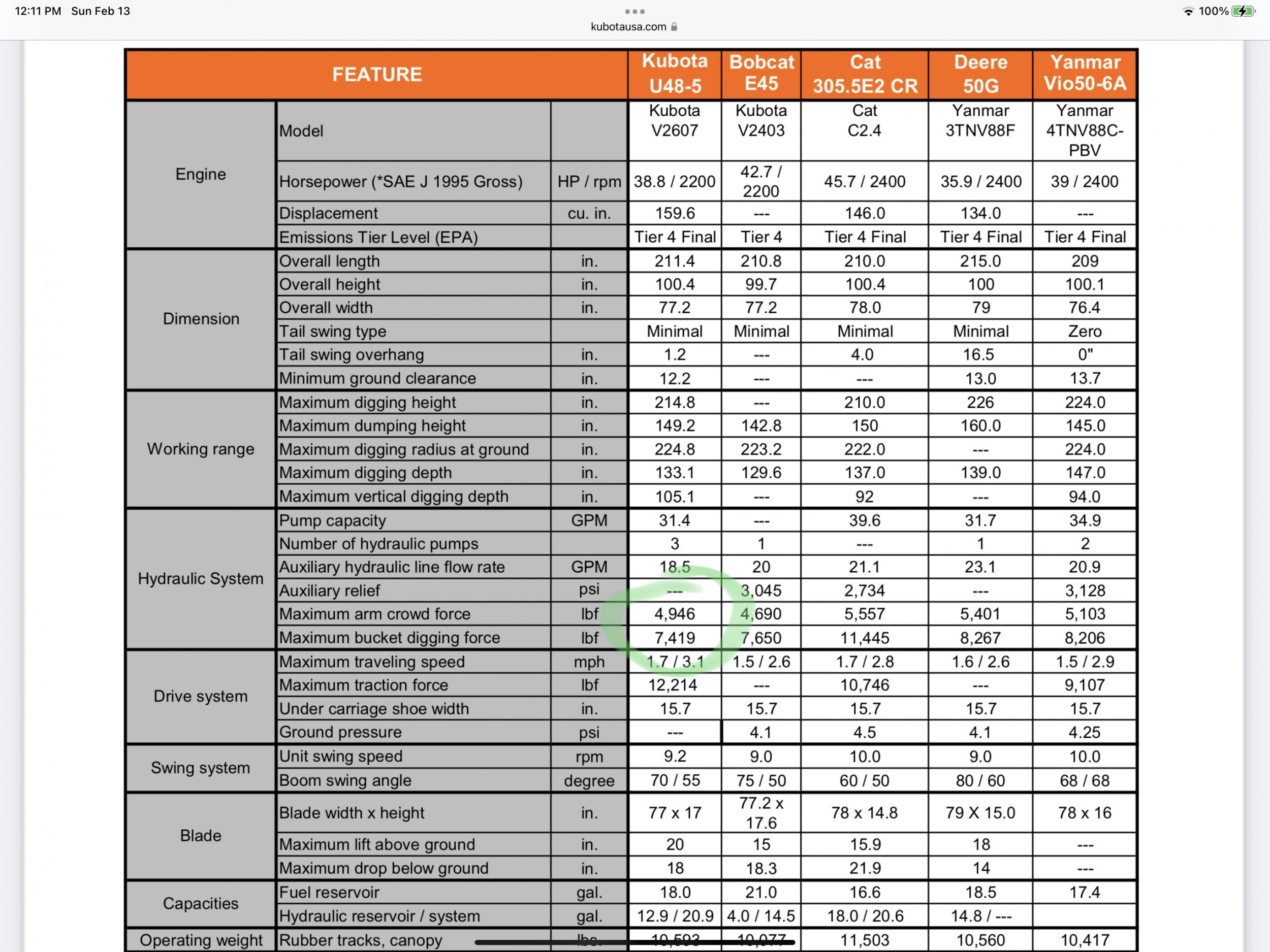

Here’s something else, I find mistakes on kubota‘s stuff all the time. Look at the breakout force they list for the u48-5. Obviously the low number is a mistake because they publish the higher number in too many places.
Not sure I trust it. That same sheet says the max digging force is 7800 or so LBF but we have already seen it at around 9300 I believe.
Edit: Just saw your post above when I was finishing this.
One would think Kubota would brag about 3 pumps in a machine….but it isnt mentioned in their marketing materials or the dealer video comparisons anywhere I have seen.
