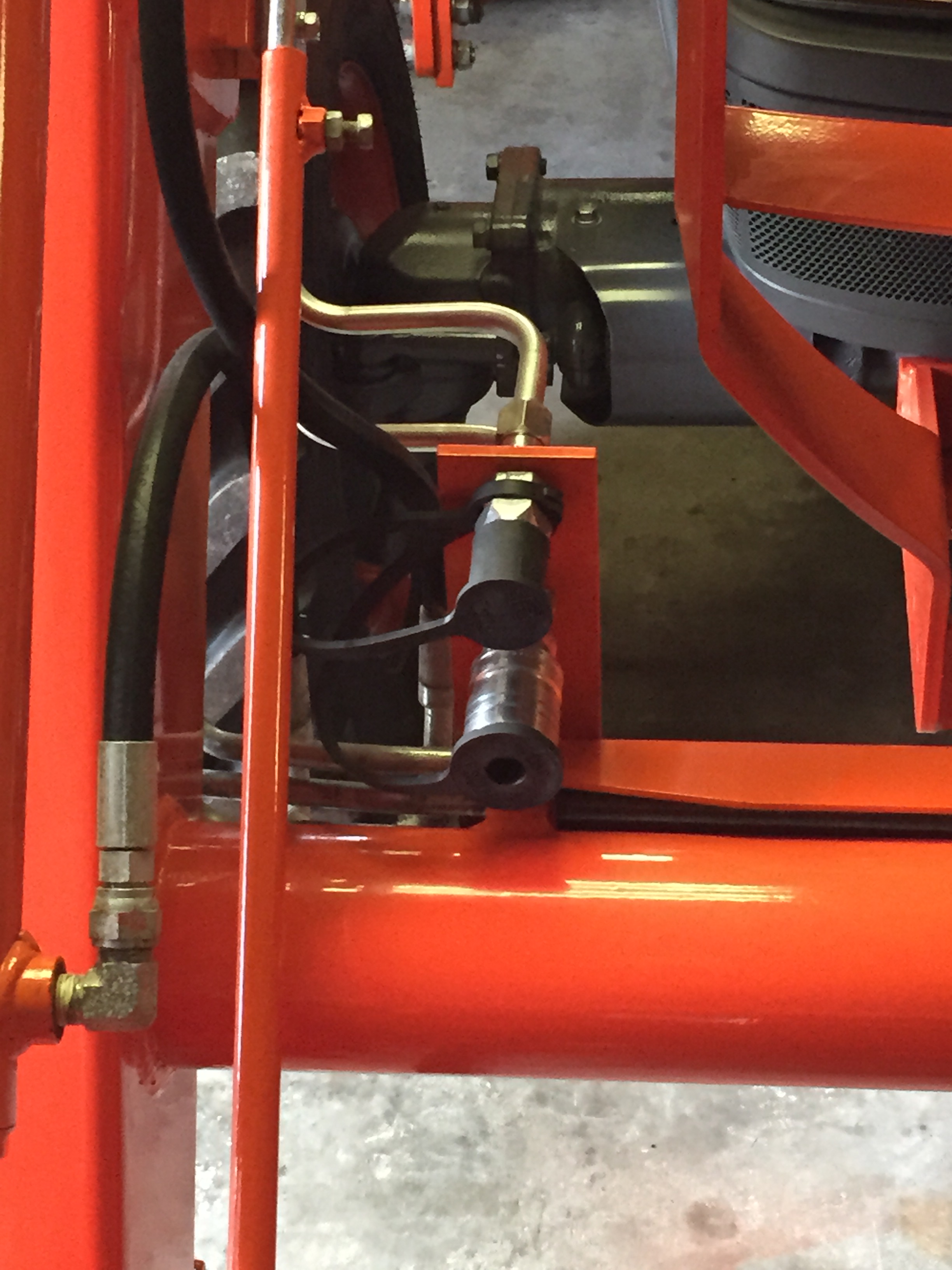

My dealer must have taken them out prior to delivery. :confused3:. Just wanted to make sure I hadn't missed something. Thanks
They were installed on the T fitting where the hoses split to go to both cylinders, they aren't very big, I wasn't too sure if the dealer had removed them until I took the hoses apart from the T fitting to make sure. The instructions don't show them very well. I should be able to make a trip home in a couple weeks, if I do then I'll try to remember to post some pictures of them. It made a noticeable difference in how fast the lid opened and closed making picking up stuff much faster.
