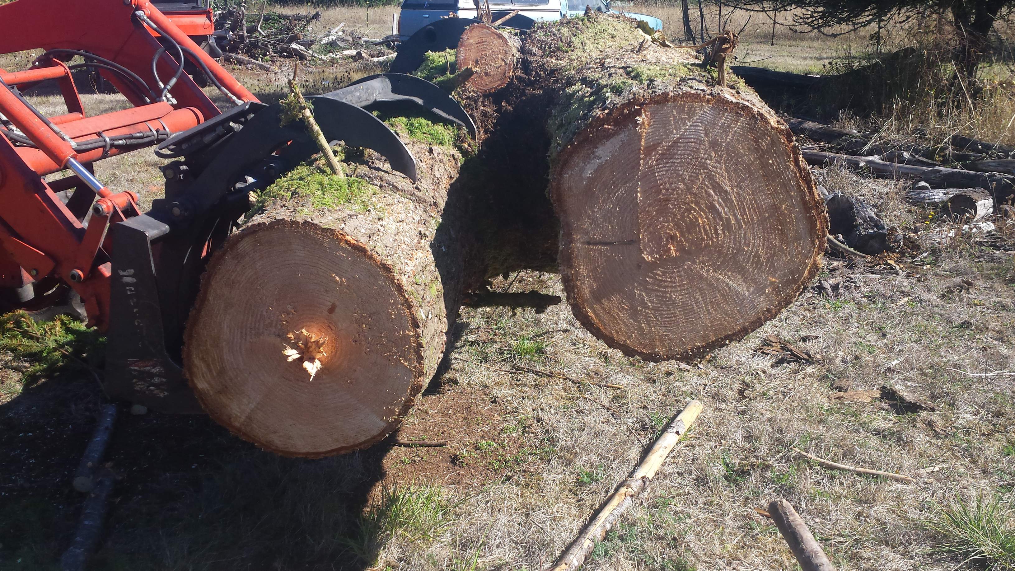

Like Richard, I use a true third function on my grapple and have no where near the hours operating he has, but found it easy to learn to use by just tapping the toggle.
/ Question about Kubota Third Function Valve Operation #43
Good to hear. Maybe it varies somewhat between the different size and type grapple as well?
/ Question about Kubota Third Function Valve Operation #44
The restrictor devices are the best you can hope for. And they work fine if properly used. Just be careful about pinching down the flow too much.
I don't use restrictors on my Grapple. It used two 2"x8" cylinders. My M9540 has considerable flow. They can be slammed open or closed. If I'm wanting to be gentle I can "tap" the joystick buttons and regulate it pretty well. Just takes practice.
To have a Grapple is worth the learning curve of controlled use. :)
For clarity, understand, a diverter system uses your "curl" function on the FEL to operate the Grapple. So it has delicate control by a steady hand on the joystick. What you sacrifice is the ability to do both functions at once.
The system we're discussing here is operated by electric over hydraulic valves. They only know "open" "closed". The gain is multiple simultaneous functions.
Again, you get the use of 3 multiple functions with a true 3rd function only if you operate the loader joystick properly. People need to be realistic about their capabilities, many people simply do not have the touch that it takes to operate 3 functions at once.

Thanks again to everyone who offered constructive advice, it has been helpful. I'm pretty sure it is the relief valve I'm hearing when the flow is overly restricted. That is why I opened the flow up some more. I'm trying to balance the valve operation while providing enough flow to keep the system happy.
As I said in a previous post I'm sure it has a lot to do with the fact that my grapple/thumb only uses a single 2" cylinder. When I built it I did not want to make the hydraulics so powerful that it caused other parts to break so I stuck with a single 2" piston. It has always been powerful enough to do what I want, but I may try a 3" cylinder to see if it slows things down a bit.
I still have the fall back of using the rear remotes which work great.
/ Question about Kubota Third Function Valve Operation #53
You don't want to pop your relief valve much, but a little bit won't cause issues. Popping the relied valve will heat up the oil & put a maximum load on the pump. But a 5-10 seconds of relief every 5-10 minutes or so won't be significant compared to normal hydraulic system operational heat generation.
I have restrictors on my TnT & hear relief kicking in when operating them. No issues here. I know FitRite sells a lot of em & I haven't heard any complaints or issues. Other than a few people drilling theirs out a hair wanting slightly faster operation.
