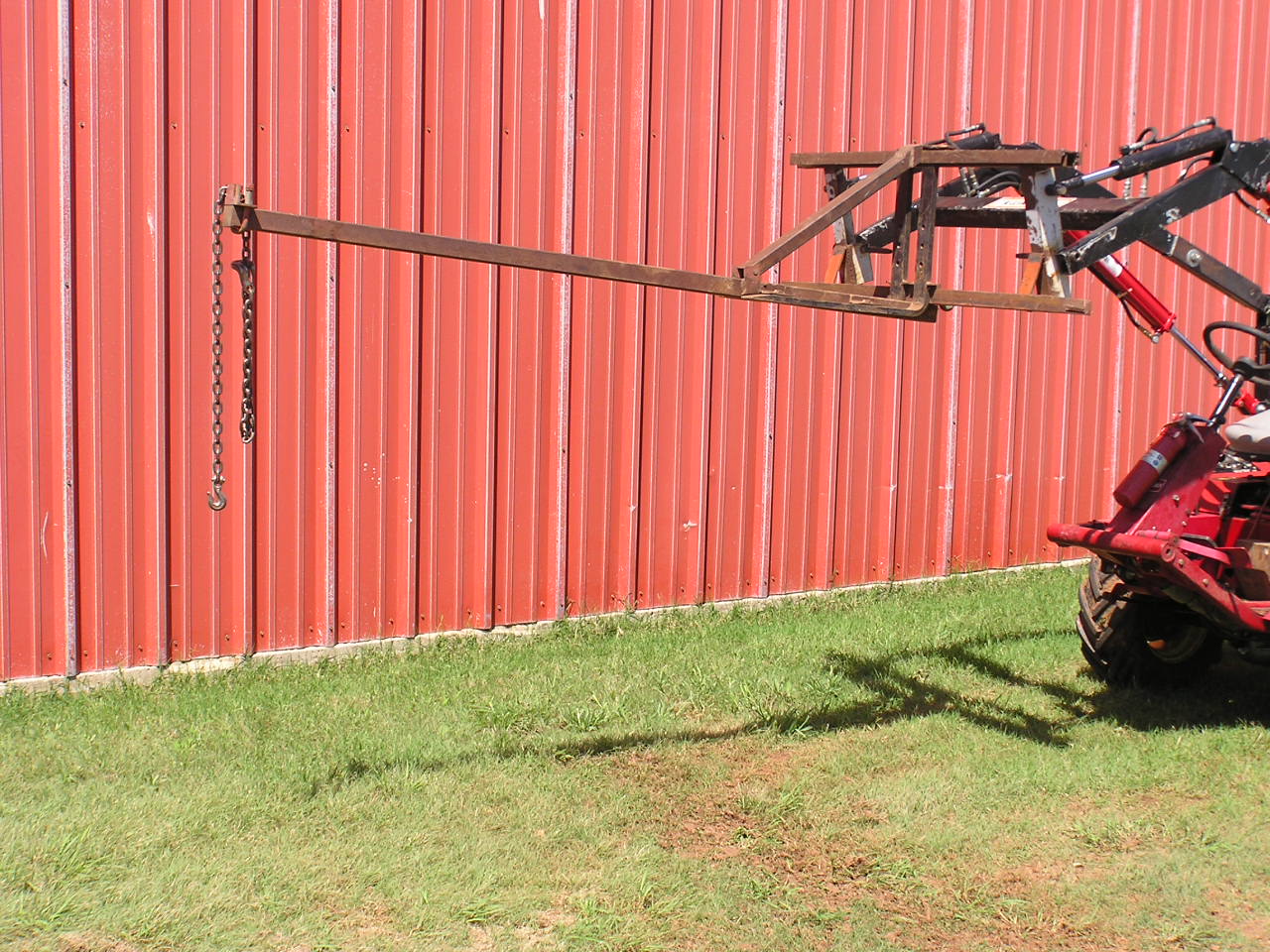

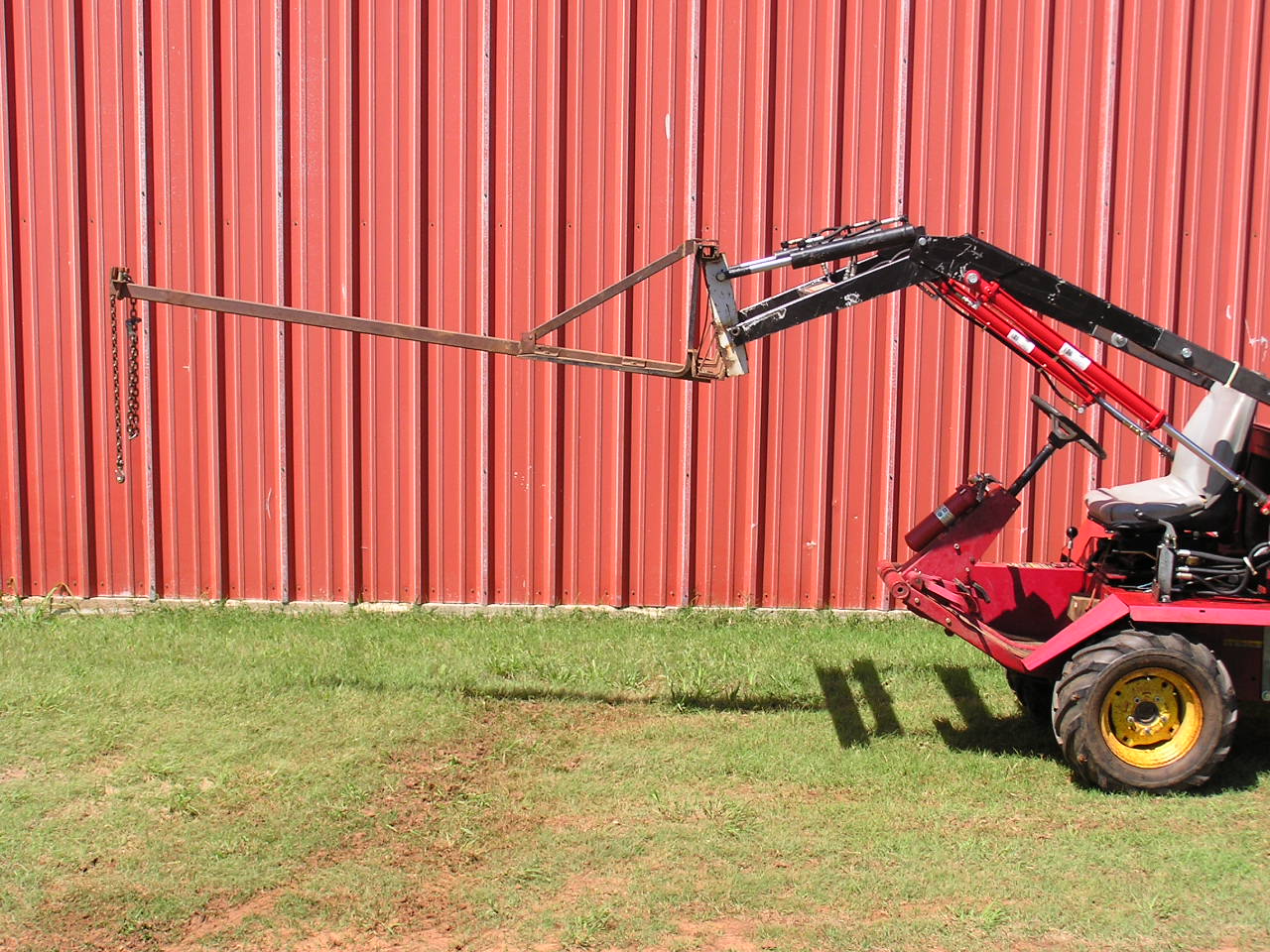

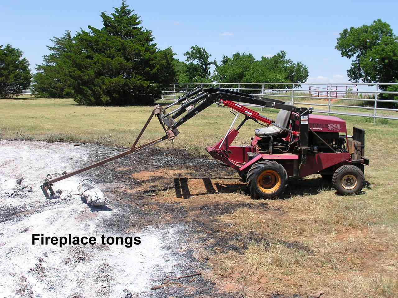

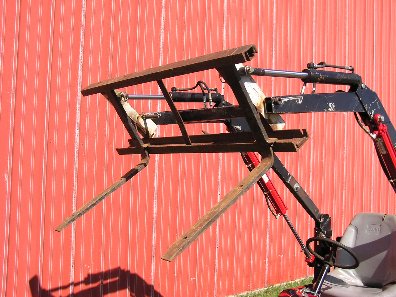

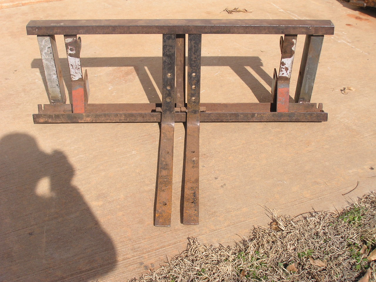

Do forks ever get used close together for "special purposes"?
Wondering if I need to add closely spaced receivers for any good reason?
That is the advantage of sliding forks. I made this frame over 30 years ago for a Craftsman garden tractor.
Added angle iron later to fit the TORO+Loader.
Made a boom pole out of thin wall 2" square tubing that fits between the forks.
Clamped on some "fingers".
Maybe you could make your frame with sliding sockets? :thumbsup:
